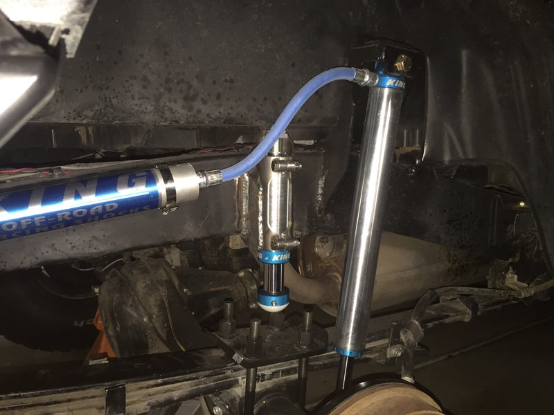

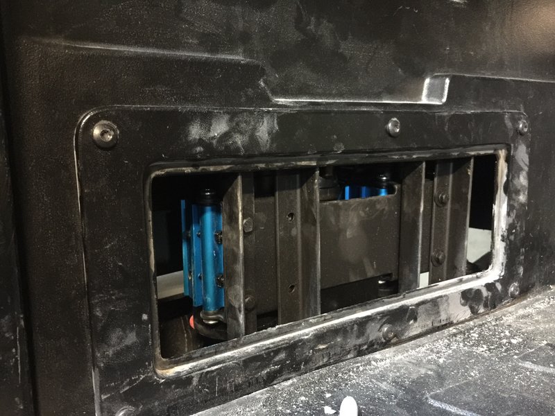

    Installed my bump stops and mounted my arb twin compressor.

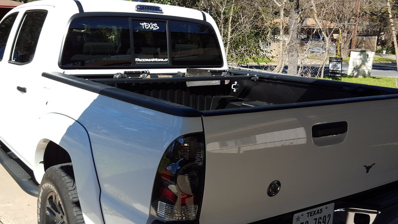

    We have one of those vinyl cutters. I just made it yesterday just for fun. It sucked pealing away all the extra vinyl and trying to leave all the thin lines. . I'm not sure it will last long. The lines are so thin they will probably get rubbed off with a couple of washes. We will see.

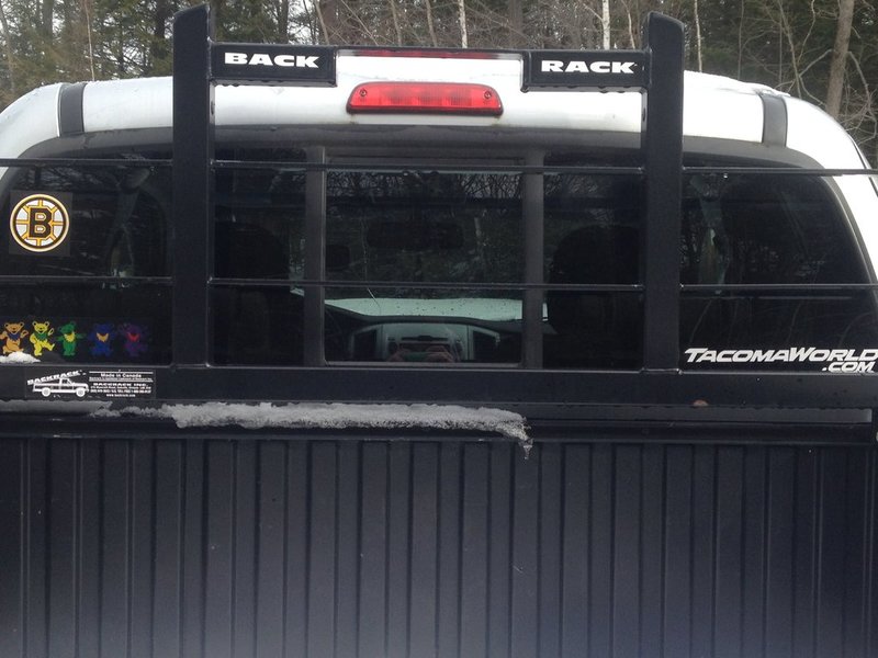

    Fog Light, LED Bar in the lower valence, fumoto oil drain plug replacement, backrack

    Any more details on theARB install ? Like the look

    Thanks. I drilled out the mounting nuts for the cubby. I reused those holes and mounting nuts. I put angle iron along the top and bottom and welded angle iron across to mount the compressor.
    After cutting the cubby out, leaving the trim,I had to bend the metal twist lock tabs and trim a piece of the bottom tab in order to reuse the cover.

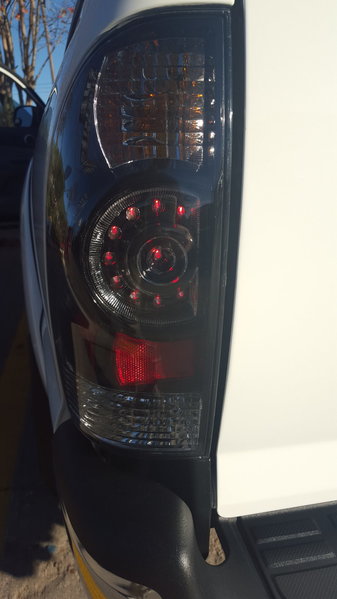

    image.jpg Blackend Depo Taillights! Thank You @scocar for the Detailed Write Up! I Went With The Same Vender And Had Great Results! :thumbsup:

    Right on. Looks great with your TRD sticker in the same colors.
