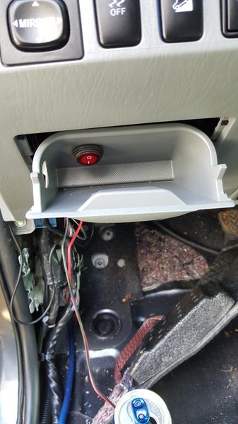

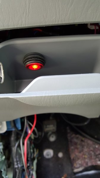

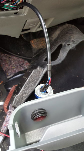

    Found a temporary place for my switch while I wait on my NSA Box.

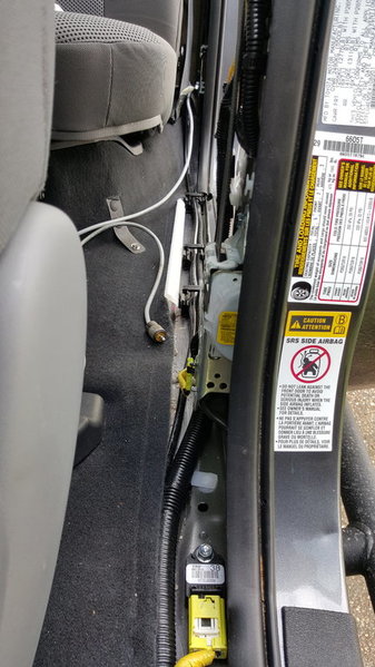

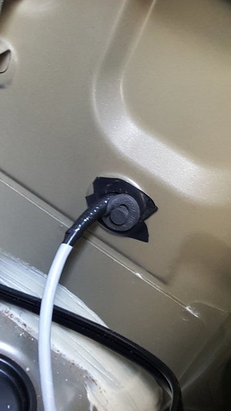

    Also ran my CB Antena cable properly.

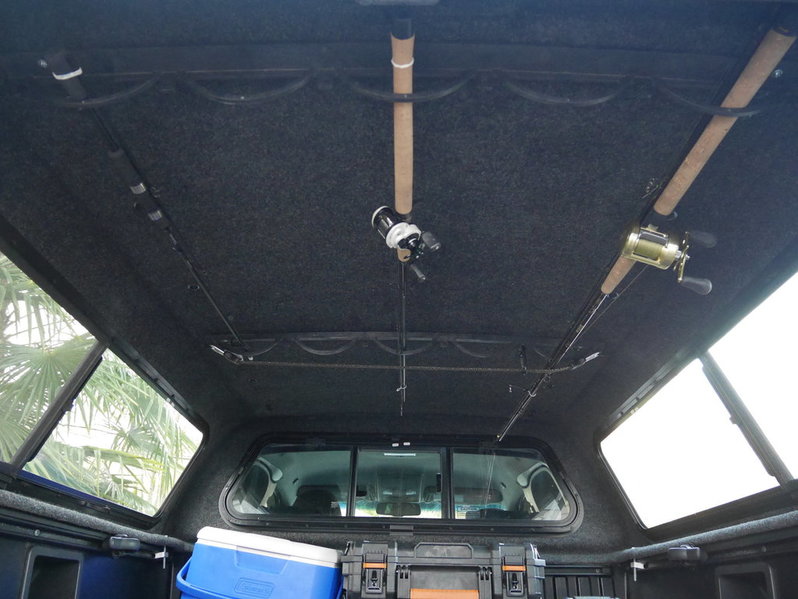

    Got the idea from a member on the ifish forums. Made a rod rack for the roof of my canopy. Still have some finishing touches to do such as wrap the contact surfaces to prevent damage to the rods and line and rig up something better to hang the forward end of the longer rods. The 10'6" rod on the right is too long to maneuver into both rod holders.
    They are paver frames from Lowes shortened to fit the width of the canopy. It is held onto the carpeted roof with the "hook" side of velcro which is adhesive-backed. I also installed a 3/4" wood screw with a washer under the head on each end of the paver frames. I really think that the velcro alone would hold just fine, but I went ahead with the screws for added stability. I screwed into the area near the existing bolts that attach my roof tracks.

    I won't say "properly". Proper would have been thru grommet and silicone for potential leaking or air.
    I will say at least you taped the hole to attempt any fraying from happening.

    Properly, is referring to not having it strung across the cab and out the rear door. It was a temporary setup while wheeling last weekend.

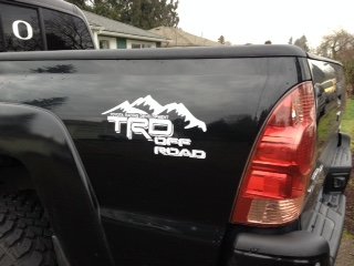

    New TRD off road decal!!
