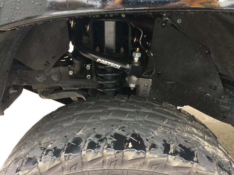

    saw this on a tacoma, what is that bracket next to the coilspring?6g_800.jpg

    The bumpstop to the right?

    Yeah, it looks like a bump stop.. But why have 2? especially on the stamped stock UCA which could probably bend if hit too hard.

    From the way it's mounted, to prevent to much droop? :notsure: They usually use straps for that though

    Never seen one before, was kinda odd, probably a custom piece

    Me either. Looks to me to limit the UCA, in turn limiting the droop. Not sure

    I believe it is some sort of bumpstop, possibly made my Fabtech. Noticed it on @Elevated build thread.

    Not sure if it was fab tech or rough country that made those stops. I had a box of parts when I built my lift. They do work well though. I've been meaning to put my GoPro in the wheel well and check out how much pounding they get.. But so far so good.

    That is a bumpstop which rough country uses on their db lift.

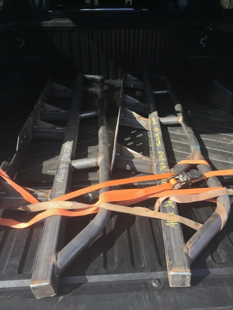

    Picked up these from Fastenal on my lunch break...
    198E4DCD-FE1A-4E43-9FA6-204ED1431646_zps_474fd273da7896256079067638614fe9a60ac2c0.jpg
    Need to try and make some time to prime, bedline, and topcoat them this weekend!

    Do I spy BAMF bolt on sliders being shipped out!!! Did you order them on the Thanksgiving sale? If so, what was your order number?

    Not BAMF, SOS Concept bolt ons... But these were ordered during their Black Friday sale though!

    Oh...I wasn't aware anyone else was doing the staggered look of the kick out...Good to know!

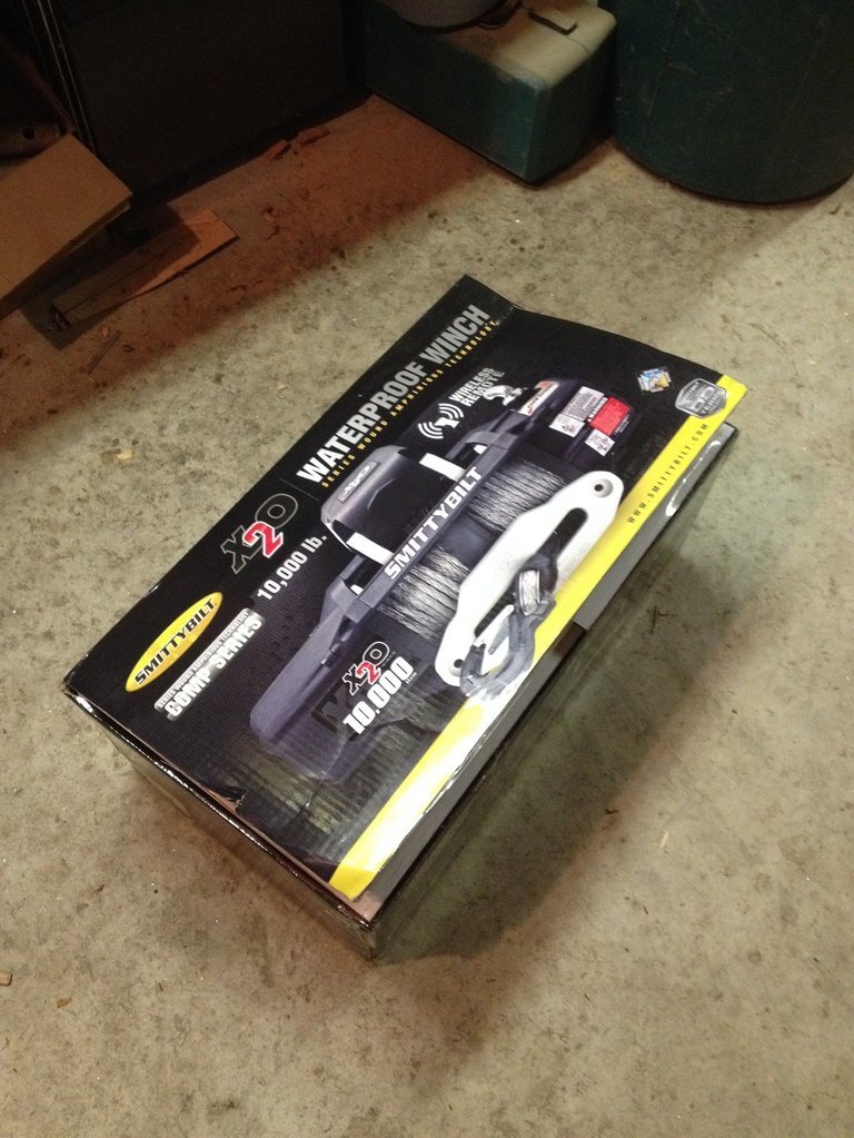

    New winch came today! Smittybilt X20 10k with synthetic line.

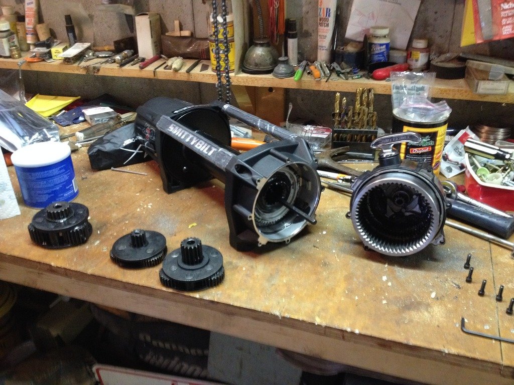

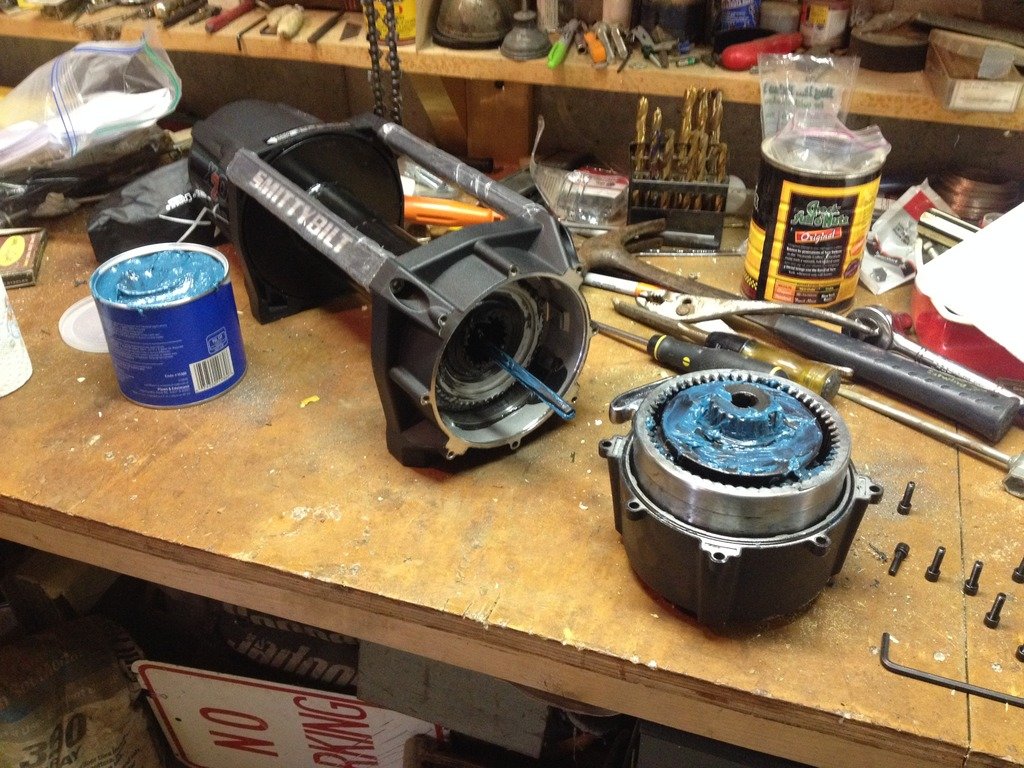

    So, I immediately went to work on it. Pulled, cleaned, and re-greased the planetary gears with bearing grease for easy free-spooling. (Thanks for the tip, MtnClimber!)

    The winch free-spools super easy. You can literally pull it with one finger, uphill. Awesome mod.
