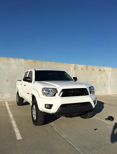

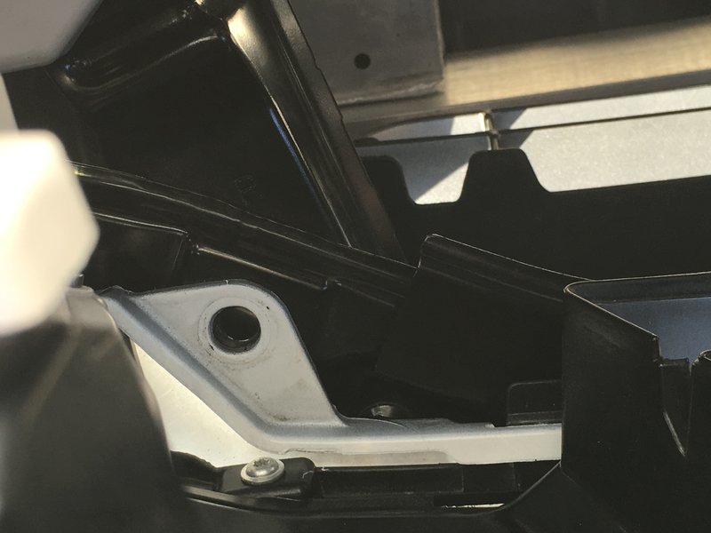

    Has anyone removed the grill on a 2015 specifically?!?! The removal process doesn't seem to be the same. Can't get this damn thing off.

    It should be the same, did you remove the two pins in the lower corners? The lower guidance tabs connecting to the bumper need a little convincing.

    I pulled them all. The ones on the bottom appear to be attached to the bumper/plastic peice under the headlight.

    The whole where I already removed one Push clamp looks like it actually needs to be there because it's part of the plastic peice under the headlight.

    I believe there are two screws and two of those plastic pins, all at the top.
    The first time I did it, I just puckered up and yanked hard on the bottom as pothers have said, and off it popped, no harm done.

    Yep, as it says in my profile. I got a Satoshi and I was doing a dry run to familiarize myself with it. It might help got get an inspection mirror so you can see down under there from behind. A series of flat, blade-type tabs that actually don't have any catches on them, IIRC. I think it is just angle and pressure that holds them in after you undo to the top.

    Literally just ripped it off. For those of you wondering. You don't take any push pin clamps off the bottom of a 2015. Only the two on the top. And the two screws as well. I really had to yank Lol

    It's a bitch. The clips on the bottom don't really move. Push them down softly and try to wiggle the grille forward and off. There are 5 or 6 clips total I think.
    It's a pain.

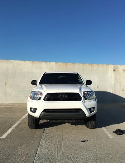

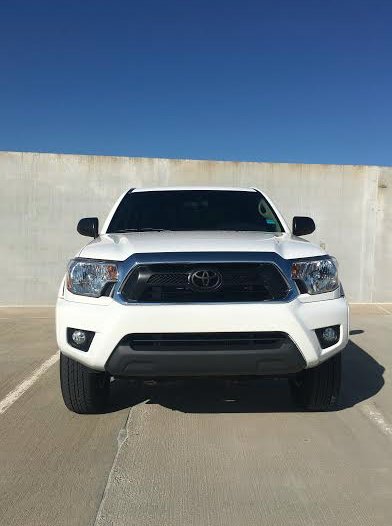

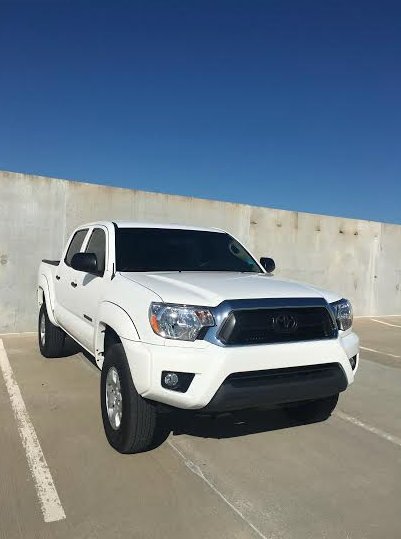

    Before:
    After:
    Very happy with the outcome.
