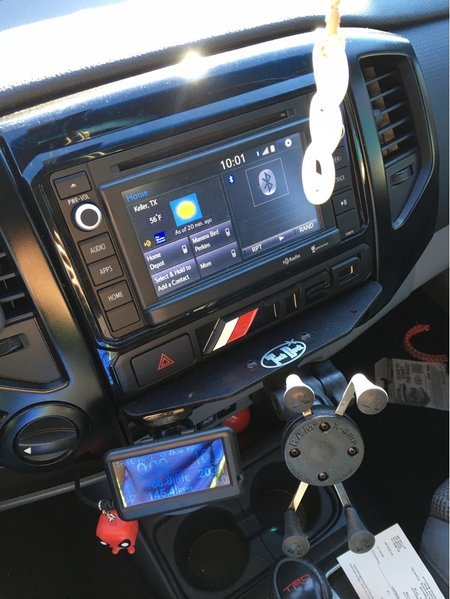

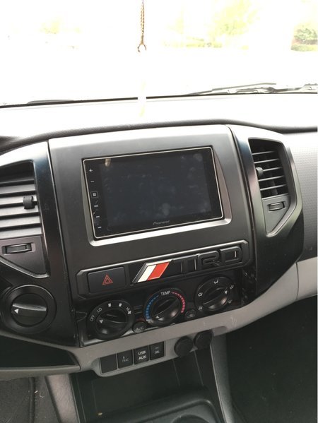

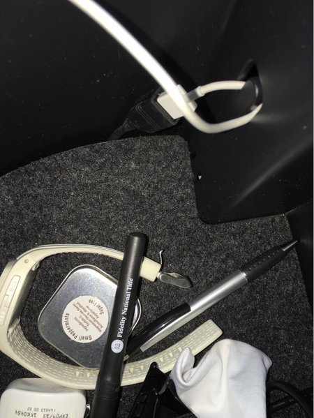

    Finished my Appradio 4 install. Originally I used the Metra dash kit but It had plastic brackets and a pain to adjust. Ordered the Scosche kit and it fits great! The only pain part is all the damn wires behind there. The top of the dash kit isn't fully clipped in place but it's not budging. Ran the CarPlay USB plug up into the glove box and mic is up on the a-pillar. It's perfect for what I need and now I have voice activated nav! Found the Appradio on Jet.com for considerably cheaper and then 15% off for setting up the account.
    Cleaned up my dash a lot more.
    Before:
    After:
    ImageUploadedByTapatalk1460153169.191202.jpgImageUploadedByTapatalk1460153188.759572.jpg

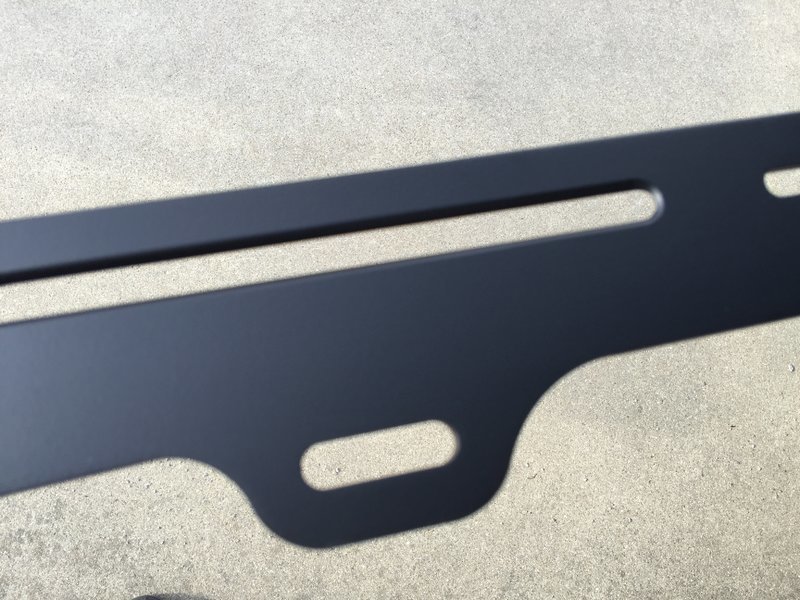

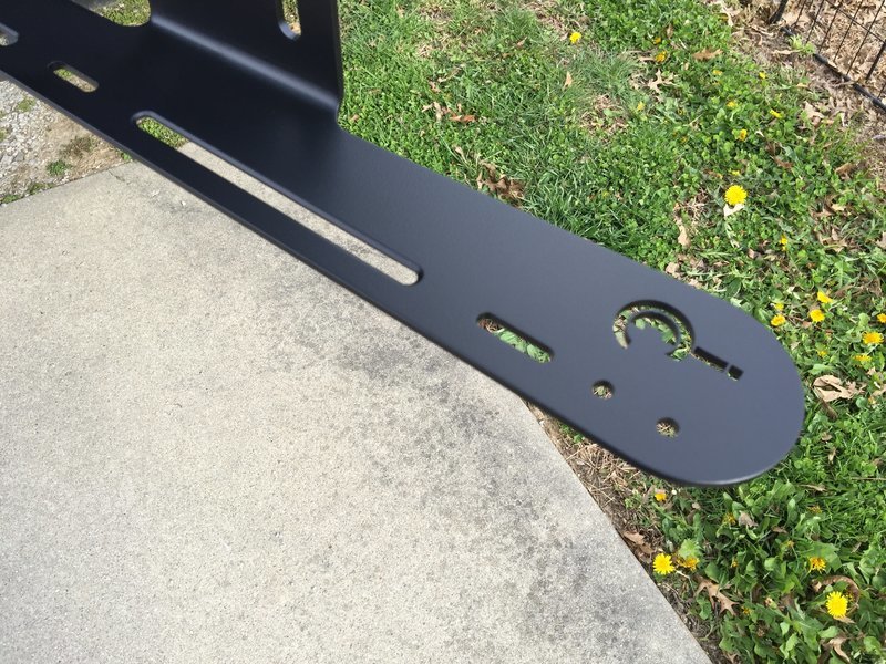

    Picked up my customized Prinsu rack side plates and spoiler from the powdercoater. On our 4Runner we always piled different stuff up top depending on our intended activities and made use of nylon straps regularly. I was worried that the very sharp laser cut edges would damage those straps on corrugated roads and cause a failure leading to items falling off and getting damaged or lost. With that in mind I had the sharp edges that straps would go through or possibly cross chamfered to round them out. I am extremely happy with the end result even though my phone camera wasn't very much in focus.
    Will install tomorrow.

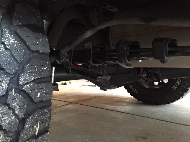

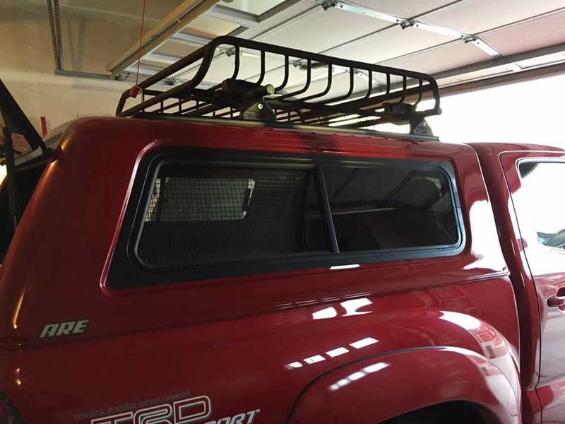

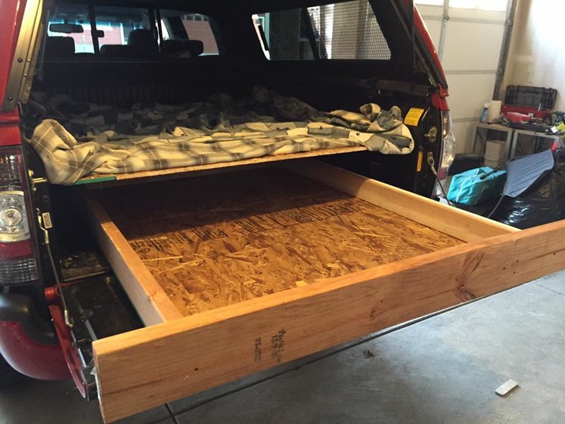

    Lets see... I built a sleeping habitat in the back of my DCSB 13' Taco! and then added a old Yakima warrior roof rack... Then I tore down the rear leaf packs (which already had an icon aal pack) and added the overload back in.
    12931163_757053797208_7256565540041985281_n.jpg 12938322_757053822158_9126900793480285482_n.jpg 12985364_757053812178_4431625457138599768_n.jpg
