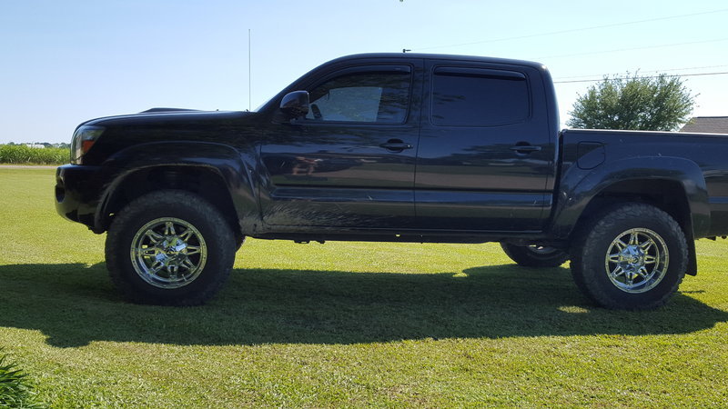

    But she looks good a little dirty

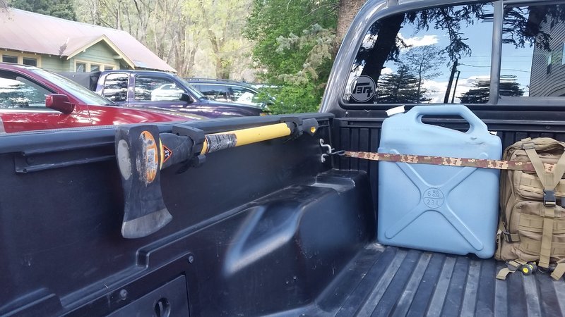

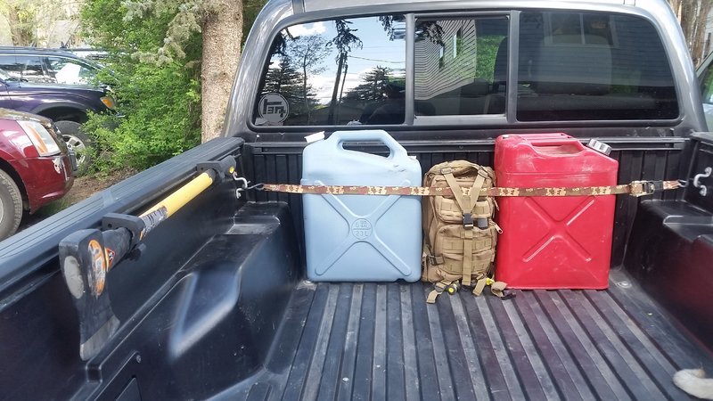

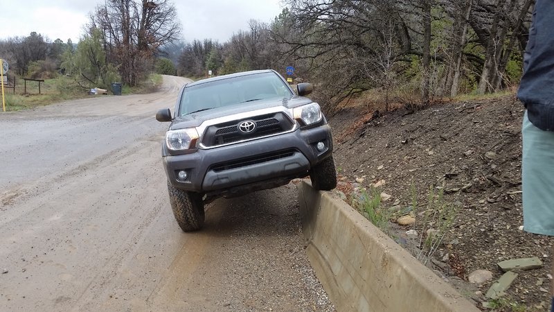

    Did a little flex test and finally decided to mount up the quickfists for my axe.

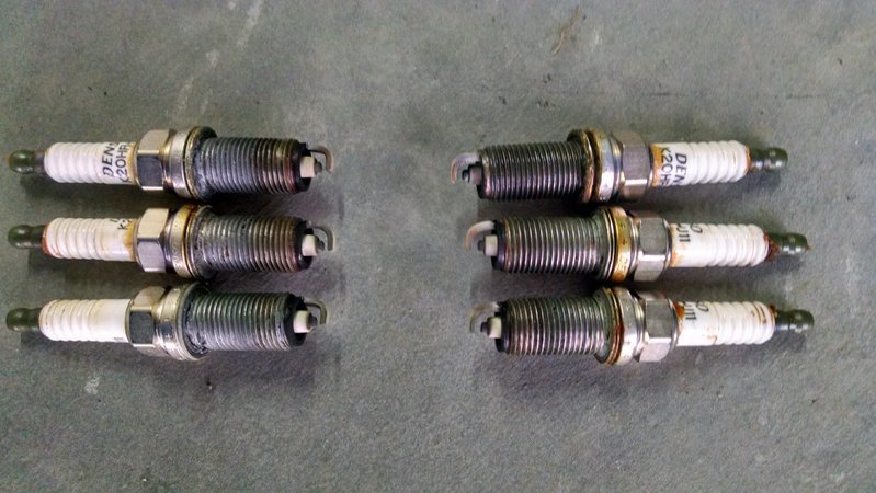

    Changed the spark plugs, engine air filter, and cabin air filter. Starting to work my way through the 90k service schedule. Next up will be the front diff fluid change and ECGS bushing. Then on to the transfer case and rear diff fluid.
    Here are the plugs with about 44k on them. Plugs on the right are from the drivers side bank as if you were standing in front of the truck looking at the motor.

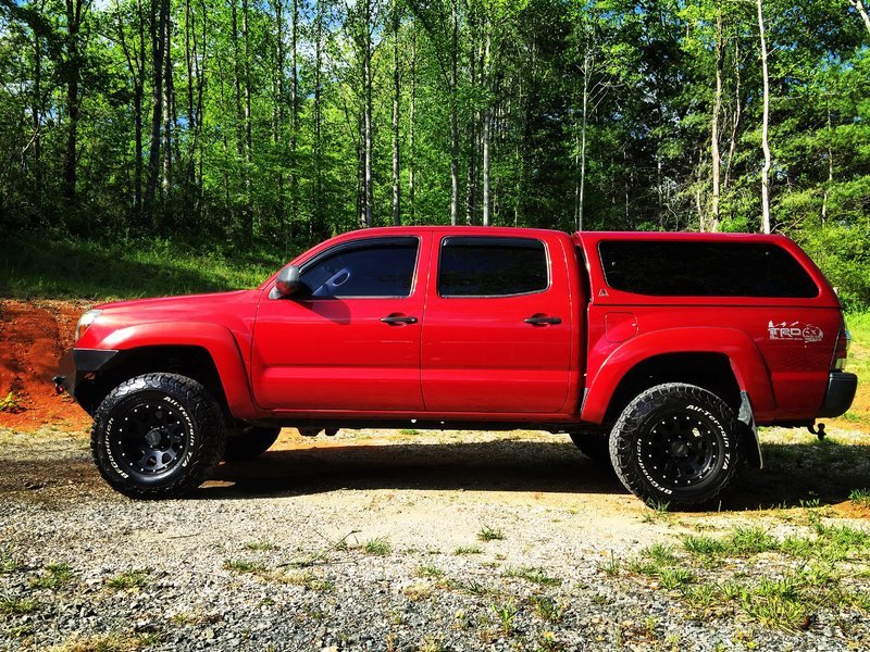

    Installed eibachs up front and lifted the rear to even it out. Alignment was spot on even without upgraded UCAs.

    Just coils or their pro shock too?

    5100's I've had on already for a couple years.

    nice. How did you lift the rear? Already have 5100s?

    And just their 112-620 grey coils? What setting did you put the 5100's at? .85"? And are you running 265s or 285s?
    I ask so many questions because I plan on doing the very same thing in the very near future.

    Yeah the 620 coils, I had the shocks setup at 1.75 and downed them to .85 with those coils and did the wheelers 3 pack in the rear. I wish I would have waited and put the 285's on but I hadn't done the cab chop yet (which it is now). But yes 265 is what I'm running now.

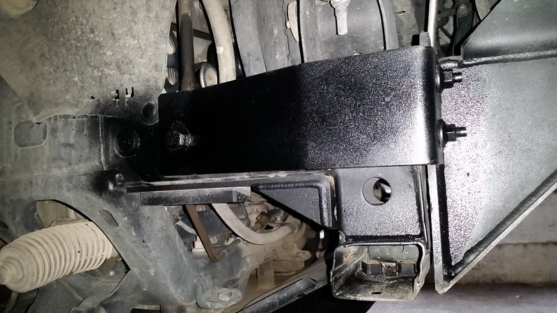

    Got some much needed supports to tie the bumper to the frame horns, thanks to @RelentlessFab
    From this:
    To this:
