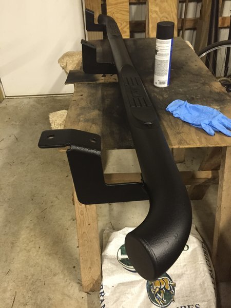

  7. May 10, 2016 at 3:13 PM
    Cruzin383
    Cruzin383 Member
    Sep 28, 2015
    #165350
    8
    Maryland
    2011 Tacoma TRD Sport DC
    3" Toytec lift
