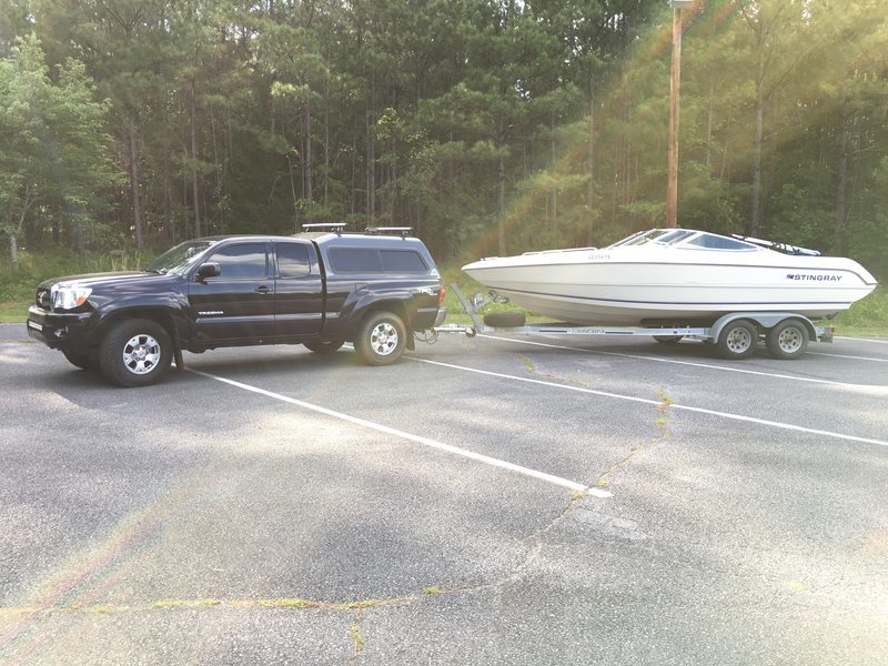

    Weekly trip to the lake. 22' bowrider, somewhere around 4k lbs w/ trailer. I can definitely feel it stopping (no trailer brakes:eek:).
    And I know it's not a Tacoma but I had to share... Loading two jet skis in the back. Guess it's cheaper than a trailer!

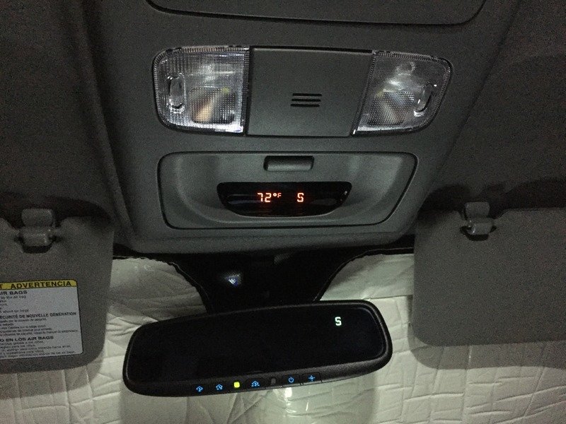

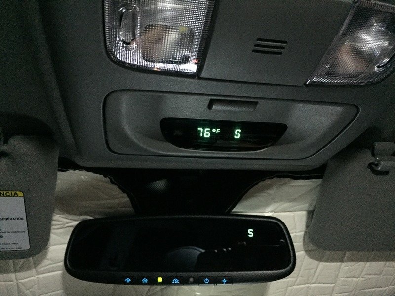

    Changed out the screen to that green/blue-ish look. More in line with the display on any rear view mirrors.
    Before.
    1E611EC6-D637-409F-B847-5306B8148002_zps_280dc318226945dfcb2850ead8cd0514e527cfe1.jpg
    After. No more amber.
    FB195725-00F8-4E57-BF22-D5EBB2AE3535_zps_56099dea029e5d19c2403054c239adad3b55ea3b.jpg

    Did your 2015 Pro come with this overhead temp unit? How did you change the color?

    Didn't come with the Pro. I think Toyota phased out the temp/compass gauge after the 2010 model year(could be wrong). Missed the stand alone temp/compass feature on the 15. So I ended up using one from an 08. Tap into the connector from the auto-dimming rear view mirror for power and illumination, ran the ambient temp sensor in front of the radiator, and tapped into the vehicle speed sensor(VSS).
    Changed out the screen with a 97-01 Explorer temp/compass gauge screen.

    Nice. I was just thinking about doing this but wasn't sure if parts were compatible w the 2015. Do you have the part numbers you've used? Thanks.

    This info is pretty much what I give to those member(s) who ask regarding modding the temp/compass gauge to the newer model year. I don't have a part number for the gauge b/c that part is a whole overhead console. I got mine from eBay. Just look up 05-08 overhead console.
    Temp sensor.
    A3D7AEBE-E118-4CA8-B9E7-4E2ACE54587E.png_beead690f7f67dc81b0930e0bec431e27ec0dd66.jpg
    Connector that plugs into the sensor.
    0AA8DD39-1101-447A-930E-35889B9690B4.png_b7a5b8d0f8dd66bb3d3809d7b1194aae16e38f6d.jpg
    Terminal repair wire. Inserted into that white connector.
    79baa7210b84dd3dc72116b23b3443f2_zpsosqk_82551e3a4ac9daa210dd58ba34f4391932185dff.jpg
    You'll be running 2 wires from the gauge to the front of the radiator for the ambient temp sensor(Yellow and Gray). Run the VSS wire from the gauge to the back of the radio(Violet w/White stripe).
    So you got a total of 3 wires coming from the gauge, through the A-pillar, 2 wires goes through the firewall(Yellow & Gray), and 1 wire(Violet w/White stripe) to the back of the radio for the VSS.
    For power wire#1(LG) and illumination wire#4(G)
    Per the diagram for the accessory meter.
    30CDFFC6-3047-468E-B559-70DEF0508833.png_1bd92944f58fd5e6f07f4910bb2b43ffc4ff33b4.jpg
    21108ADE-C79B-45DA-926D-9BF4135FEEEA_zps_9b345c5620f33c368df7f760baa23942f7704bd1.jpg
    You can tap into 2 wires from the connector that plugs into your auto dimming rear view mirror. Let me know if I miss anything.
    Wires from the gauge plug connects to-
    Green= Illumination+ > Red wire from rearview mirror plug.
    Light Green= Ignition+ > Light Green from rearview mirror plug.
    6BCAC6DA-E2EA-47D9-9759-3D6A29539150_zps_d20974005863693c3235329bc038274d9b2660ef.jpg
    For the last wire Ground (White w/Black stripe) you tap that into the map light ground which is the same color.
    That should be it. Please let me know if I miss anything
