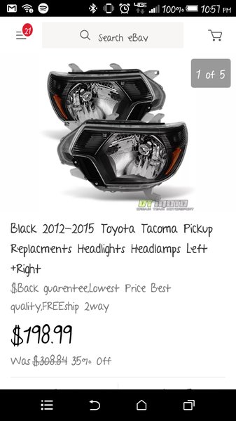

    I bought these and they leaked. They sent me a 2nd set. They leaked.
    I said fuck it and me and a buddy opened them up and white headlight modded them. They were good to go for a few months. Then I had to change out my side marker lights that burnt out. The plastic where the side marker lights go in is real thin and after changing the lights, they wouldn't seat into the hole, they would just spin. So they fog up when I wash the bitch.
    I wouldn't trust those lights.
    After we were done with them:
    You never know though, it's a crapshoot with Ebay headlights so you might just end up with a non leaking/fogging set.

    Hit or miss I guess.

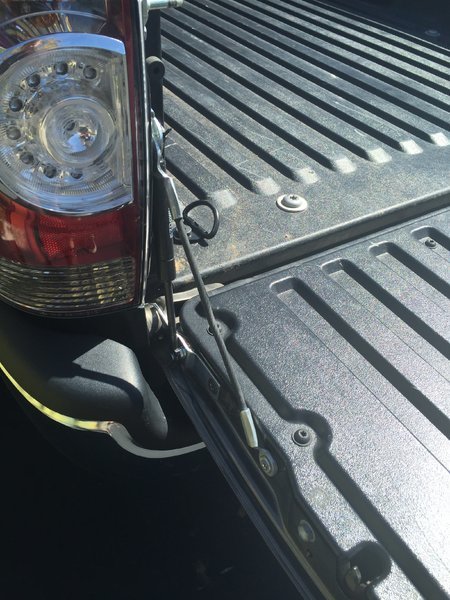

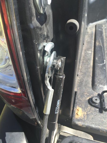

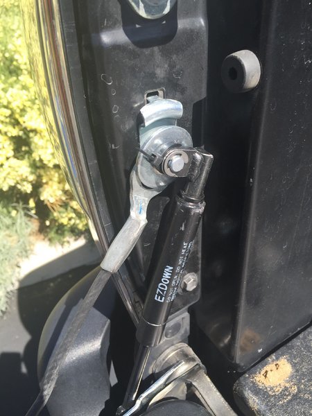

    I used the washer and zip tie to guide the connecting end of the cable to the left, before I put them in the cable would always push to the right and bind between the tailgate and the strut, now it opens and closes smooth and the cable is no longer being pinched. image.jpgimage.jpgimage.jpg

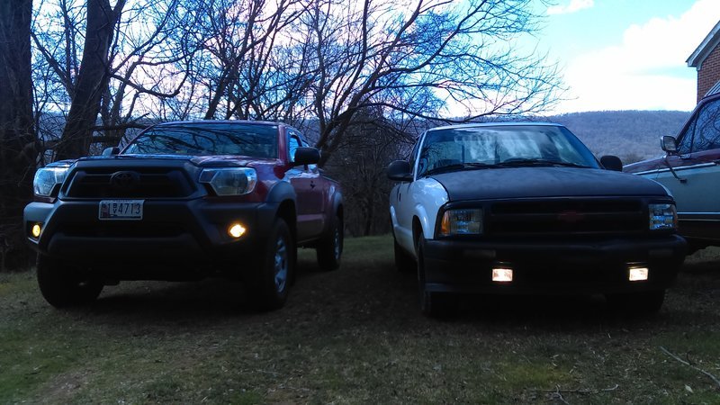

    Bought these for my s10 & no problems for over a year now.

    Just saying my experience with aftermarket lights has been shitty and they leak. BHLM, if done right, works great.

    Great pics! Thanks! I will see if it will work.

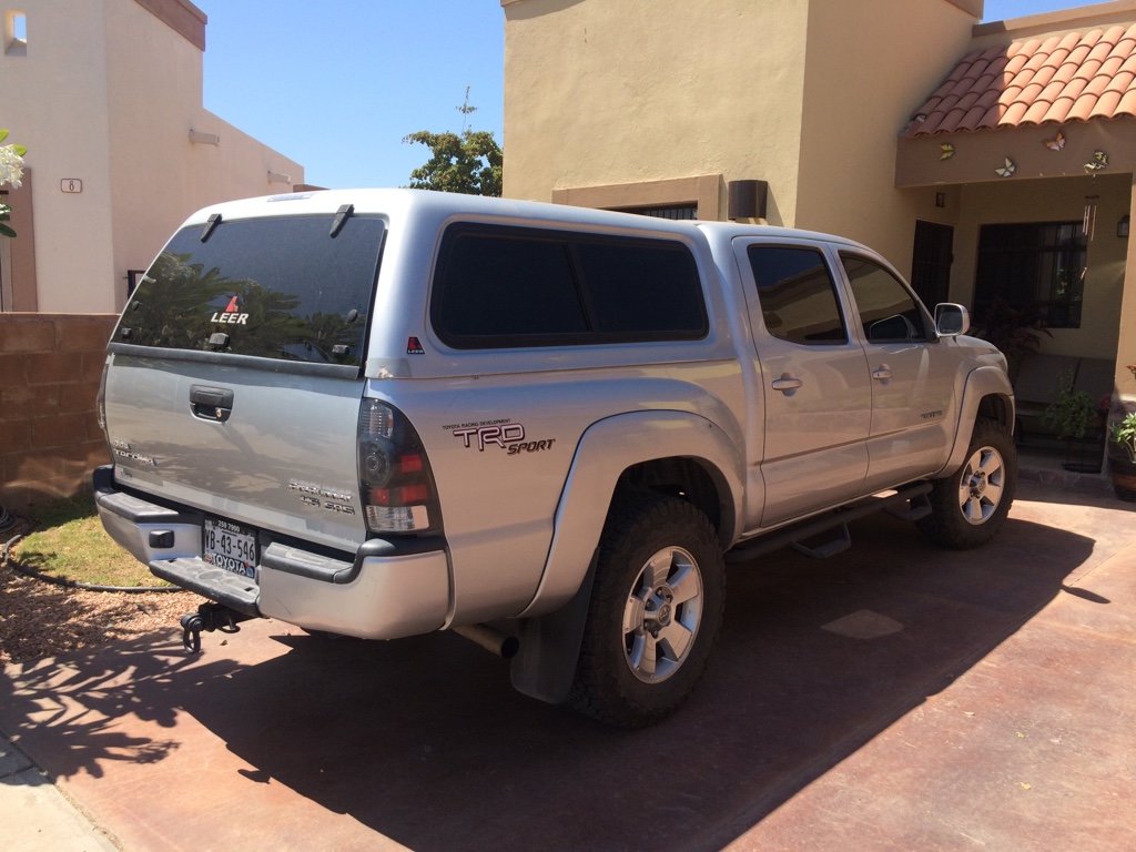

    Not today but yesterday, new to me a used Leer camper shell from CL 2a96cf1ee5bfac3d0021b72c42605913_7ddf2f00f18e583aab6f7b69be33fbccf995bec2.jpg72f55c6408444cddd7626a66b0223c78_ad0c44c47bc7f9fdb2ca6234d98e115b49f72264.jpg

    looks good. What made you want a shell?

    I travel a lot because of my work, and wanted a shell so that I don't have to worry about leaving stuff on the bed visible and easy to steal
