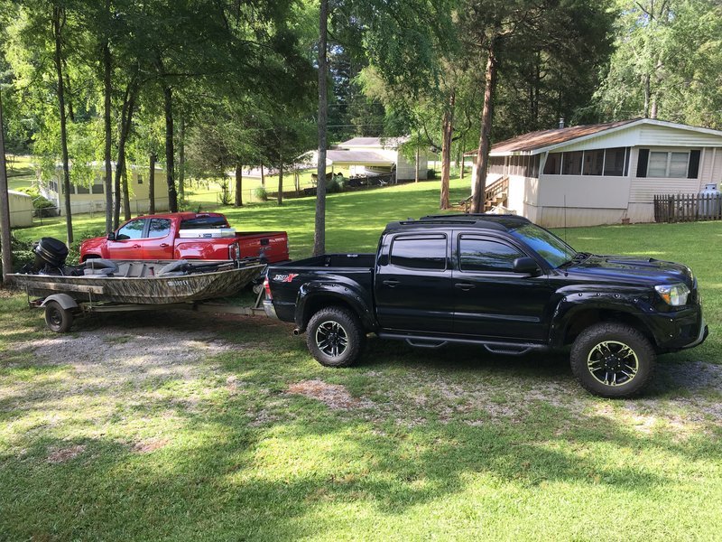

    Used it to tow for the first time, picked up the best boat in the world (a free one)

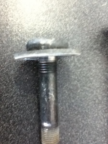

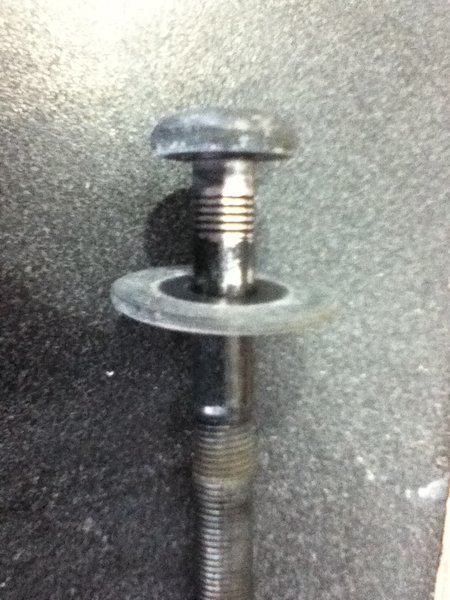

    How did you go about getting the washers off the bed bolts? They seem to separate from the bolt head but they won't slide off the bolt itself.

    You have to file/grind the ridges off the bolt (where the washer is against in your picture).

    Ok. I've seen people post pictures using a Dremel tool but it always looked like they were getting to separate the washer from the head. LoL
    Time to buy more tools I guess...

    Yep grind down the threads closest to the bolt head. Then when I installed I put washer then new ring then bolt...keeps you from having to modify the washer.

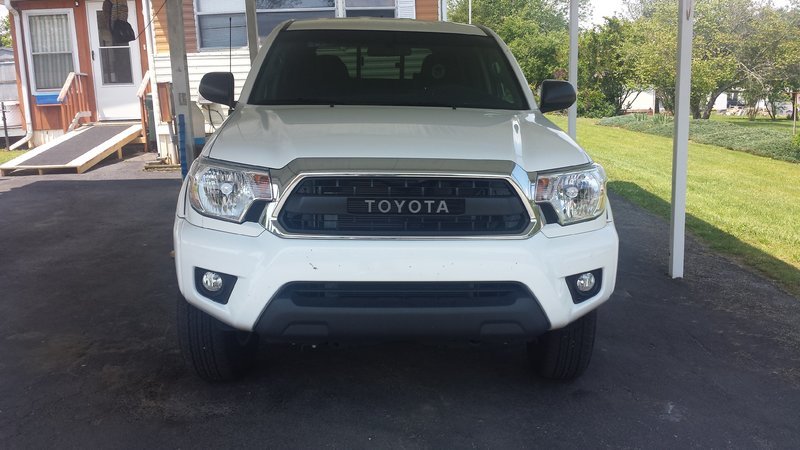

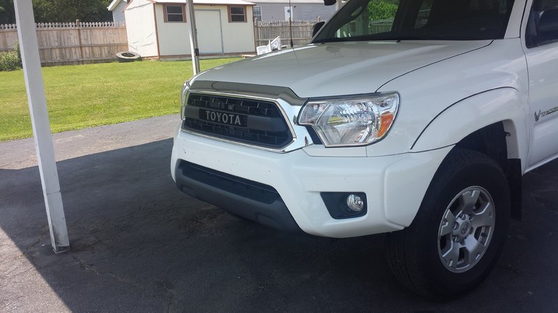

    I installed my new grill. It took about an hour from start to finish. I will have to do this one more time whenever I get my color matched surround.

    I just used a small hand file.
