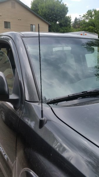

    Finally decided I needed an antenna again, but the stock one was way too long. I cut it to about 14" long then tossed a couple
    layers of paint on the tip.

    Hows the reception with it cut like that?

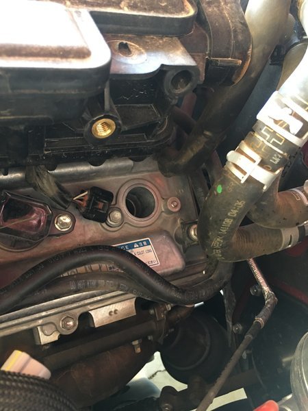

    FML just did the same thing on the same plug image.jpg what did you end up doing?

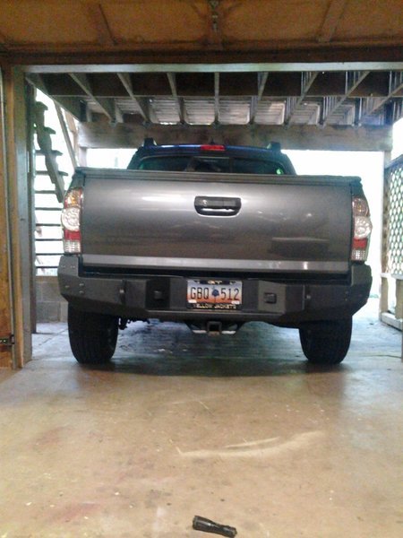

    0625161752.jpg 0625161802.jpg Picked this bumper up this morning off a fellow member. NO MAS CHROME!!!! :cheers:

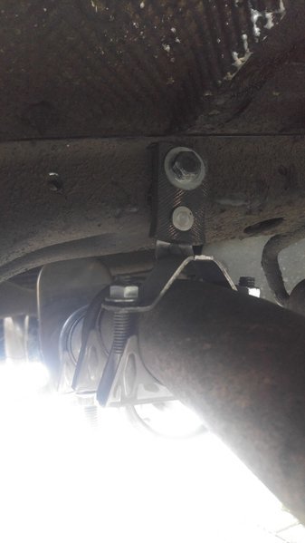

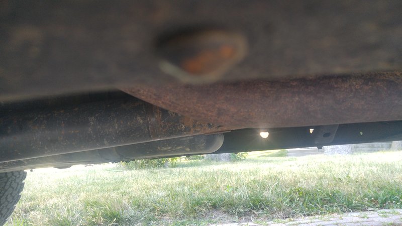

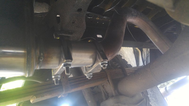

    Installed my first ever muffler. I spent way too much time at my local Canadian tire and ended up buying a magnaflow 14325
    Stainless so I had to clamp the shit out of it but I looks clean enough. tmp_26342-20160625_192547_HDR1760233860.jpg tmp_26342-20160625_192551_HDR-1935102409.jpg Had to push it up to get the clearance I wanted.
    Motherfucker sounds NICE! Deep tone, no drone and lots of vroom! tmp_26342-20160625_192459_HDR400301890.jpg Tried it dumped behind the axle but it was too annoying so I just ran it with the full length of pipe.
    tmp_26342-20160625_192416_HDR1039146719.jpg I had to modify a exhaust hanger to a really short length
    All in all very happy and an added bonus I had some rust holes in the stock one so I have a REAL reason if the wife asks! tmp_26342-20160625_201024_HDR-480398401.jpg
    Can you see the shine?

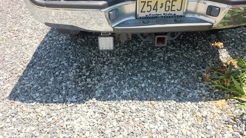

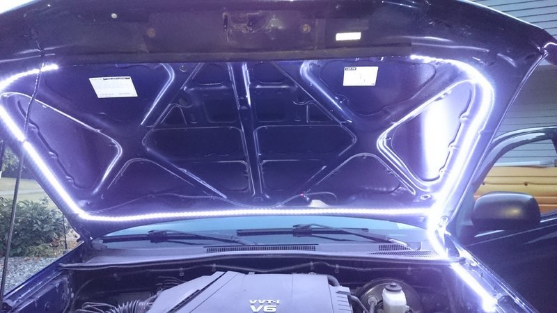

    Installed a LED back up light as well as a siren/beeper (had a woman and a child run behind me at Walmart when i wad backing out, came within inches of hitting them) installed a under the hood LED strip lighting since there is no light source there, i guess the folks at Toyota believe their trucks don't break down when its dark out ......

    With the angle of the sun and all it looks much more angry. Nice job.

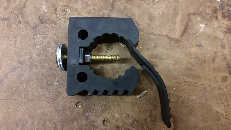

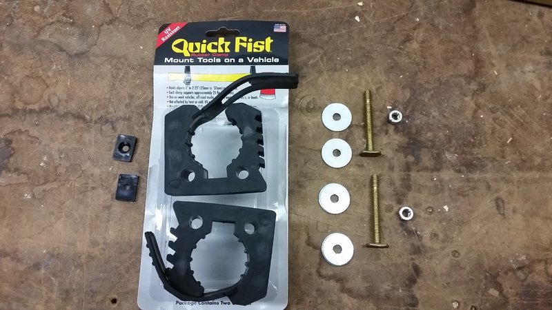

    Used some brass toilet bolts and 4 fender washers lol. It was about a 5 min job lol. Just run one washer inside the cleat track and the other one between the quick fist and cleat track. I just took a small hack saw to the bolts when I got them tightened down. 20160624_135604.jpg 20160624_135936.jpg

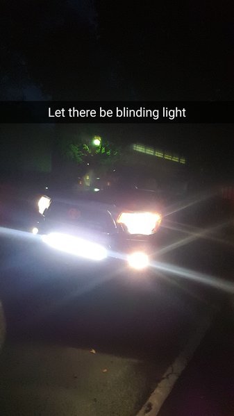

    And here it is all lit up!

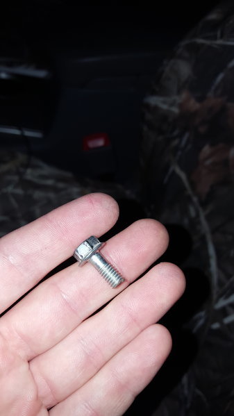

    Shit dude I know the feeling!
    Well I ended up trying to tap it out with a drill with my old lady's step dad.
    Didn't drill it dead center all the through and snapped the carbon drill bit in the screw....fuck!
    Took the old lady's car to Stiens and found the correct threaded screw and then found a bit for the Dremel tool and cut the aluminum around the bolt....
    Removed the bolt ND used a thread cleaning kit to clean the threads in the cylinder head
    Sanded it down flat enough and put a few washers to make up for lost material and I'm back in business. 1466905542832-32646737.jpg
    Didn't actually have a dremel tool, but this fits in the end of a Dewalt drill nicely!
    Good luck bud
    I keep the old bolt as a reminder that trying to just muscle through it isn't always the solution. Neither is hitting it with a bigger hammer.

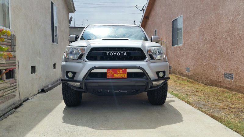

    That bumper is cool. I've been eyeballing some for a while, and yours takes the cake. Who made it?
