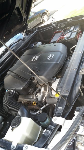

    Engine cleaning complete. not bad for the first time i think.

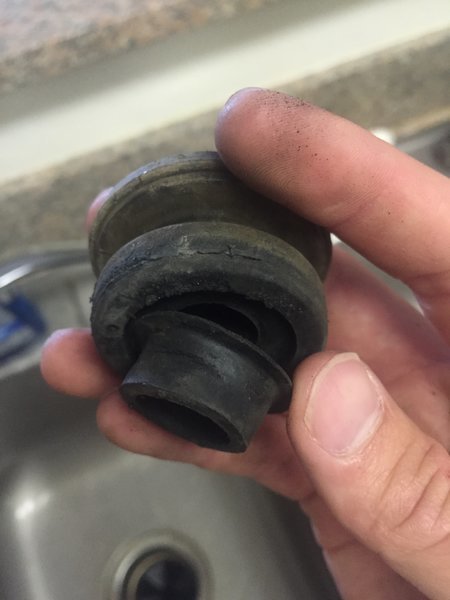

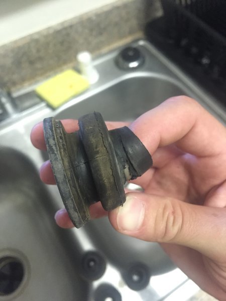

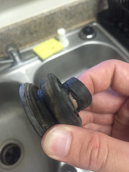

    I have a question if anyone can help me. My lower control arm bushings are going out. Should I (1) get new bushings, (2) get new factory lower control arms, or (3) get new aftermarket lower control arms?

    All depends on what your end state is for you truck and how much you willing to spend.

    Well I'm eventually going to get aftermarket UCAs and LCAs, just not sure if I want to drop ~2k on LCAs when I don't even have UCAs or coilovers yet. So I guess that one is out. Now to decide, bushings or full factory replacements? I hear replacing bushings is a b*tch.

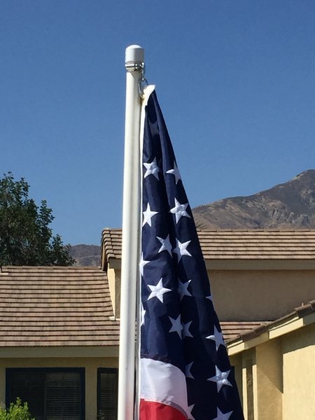

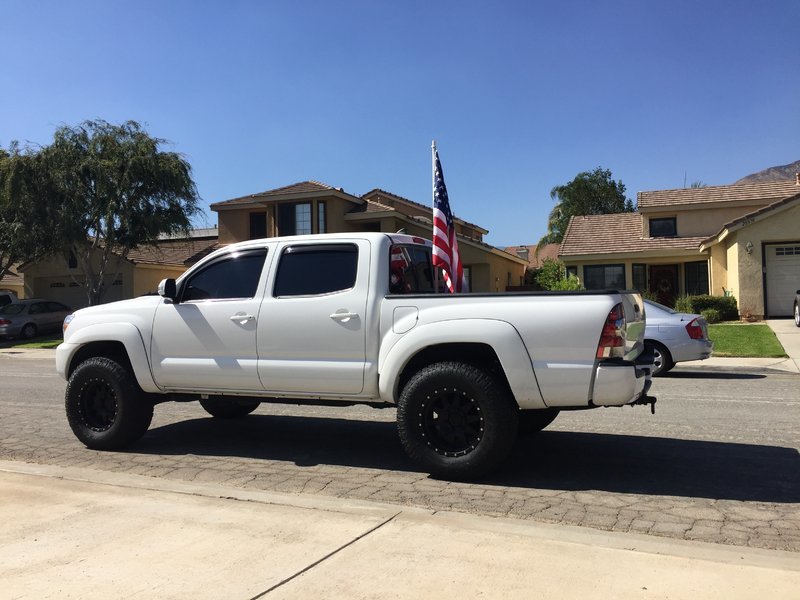

    Finally mounted my led switch properly and mounted my super budget flag/ antenna mount

    It can be. Go get Toyota OEM bushings, take the old ones out, heat up the area the bushings fit into and you should be good. Or you could try pushing the bushing in without heating up first. Either way a push press will be a must.
    If you control arms aren't messed up, just do the bushing route. It will save you money for the coilover, UCA, LCA setup.

    Damn, seems pretty early for that to happen

    Honestly if your plan is to go aftermarket I say get the LCAs now. The Toyota bushings will cost about $200 for all 4, aftermarket bushings are crap fitment for the most part. There are ways to do it without a press, that work well.
    Removal https://www.tacomaworld.com/threads/diy-lca-bushing-removal-2005-tacoma-4x4-the-easy-way.437693/
    Install https://www.tacomaworld.com/threads/redneck-lower-control-arm-lca-bushing-press.134846/
