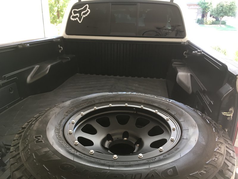

    Finally bought a matching spare wheel/tire.

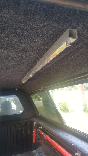

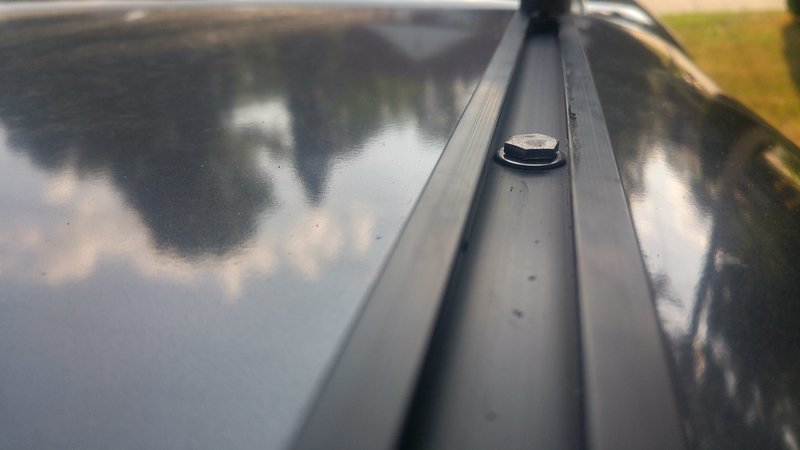

    I received my rhino tracks and installed today. Came with rivets....... I don't like rivets..... We have a sordid relationship. So I put them aside like a pair of legs and used some motherfuckin 1/4" stainless steel bolts and lock nuts. Figured while I'm at it imma reinforced the shit out of the interior with a piece of aluminum tube. Can also come in handy to prop a post up on to carry the load to the bed:thumbsup::benchpress:
    I ground the head of the bolt to have clearance for the feet of the cross bars to slide freely tmp_12418-20160719_175608_HDR-31149420.jpg
    I'm also thinking of doing some cross bars on the inside of the cap to have some hanging storage

    That is rad, I like the idea of hanging storage in the bed. I've tried velcro but it doesn't work that well and the fabric on the leer has started to separate from the fiberglass.
    What is the recommendation to keep those hole's water proof? Have you tested for the drip?

    Instructions state butyl automotive sealant... Instructions are for those lacking testosterone. I just used some silicone around and in the holes. I should test though :rain:
