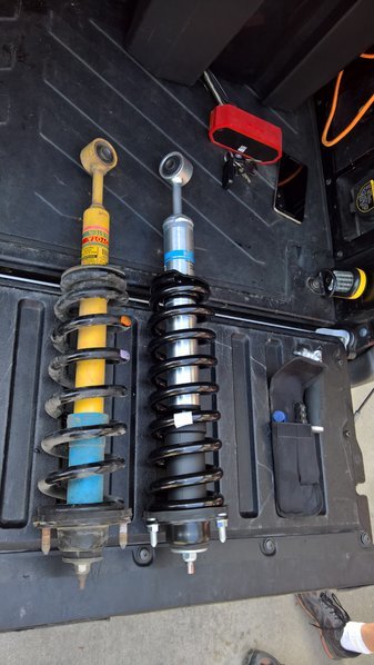

    idk yet i was checking out the 275's after talking to you last night they're a deffinite possibility i've gotta figure this suspension out first i want the back a little higher than the front so if i get a tire carrier or something in the back it ought to end up about level but not 3" difference

    Oh your gonna do that! Ok I see I see now. Make the the truck on a level lift and but a stronger and fatter over load leaf in the rear

    my thinking is a compromise i'll raise the bilsteins to the .85 setting trying to get an inch back and then if the rear is still too high i'll pull the overload spring out to drop the rear a little i'd like the rear just 1 '' to 1 1/2" higher thaan the front that way when i put something in the back or pull a trailer it'll be level

    Looks good, what springs did you go with?

    thanks. They are 885s I got the setup from headstrong. 1.5" deaver aal

    How do you like the 885's? I'm debating between those and the 883, how much lift did the 885 give you? I was originally going to buy 6112's but my truck sees more pavement then dirt and I think ill just be wasting money for something the 5100's could handle.

    Did you get the Eibachs from HSO too? I can't seem to find them on their site.

    no i got the set from a buddy they're fairly new and in great shape. from what i've read the eibachs go best with the bilsteins idk what difference it makes really toytec sells them now

    look on their web site there are two sets listed i have the 112620 they are 620lb rated and give a 1.6" lift which i can attest to is pretty accurate. the other set isn't rated quite as heavy but gives more lift

    i'm trying to make this thing off roadable i don't think setting the struts at .85 will preload too much even with the eibach coils at least i hope not now to figure out wheels and tires i've got 17x9's on it now with 285/70/17's but have been being explained the virtues of the 255/85/16's idk
