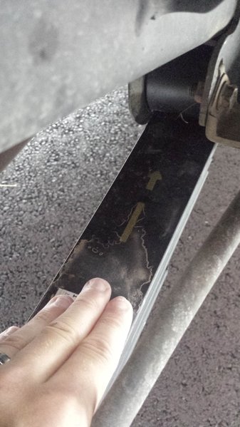

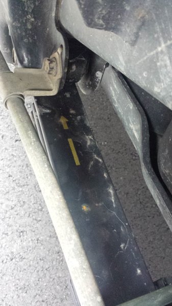

    I haven't looked at the part numbers on mine but they have different markings.

    Mine don't...

  4. Aug 25, 2016 at 6:42 AM

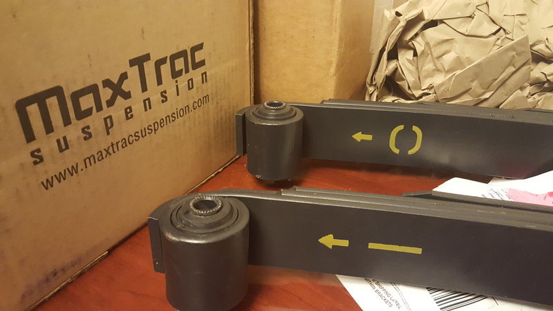

    The markings are in relation to spec. (-) the spring rate is just under spec, (o) spring rate is right on spec, (+) is just over spec. They are not side specific. When I installed mine about a month ago I had one (-) and one (o). I installed the (-) on the passenger side and (o) on the drivers side since the spring rate would be slightly better and accommodate the weight of the fuel tank. With that being said, all markings are within OME's tolerance and shouldn't drastically effect the springs.
    Someone else feel free to jump in and correct me if I'm wrong, but that's my understanding of the markings on Dakars.

    just found this: Dakar +/0/- codes
    Thanks for the info!

    I do not think they are side specific. It would be up to you if you got different tolerance ones which side you want to put it on. Mine were both 0s so it didn't matter

    On my Dakars, one pack had a (+) on them and one had a (-). The (+) one should go on the driver's side since this has a little more spring to it. I actually fixed any visually noticeable lean like this.

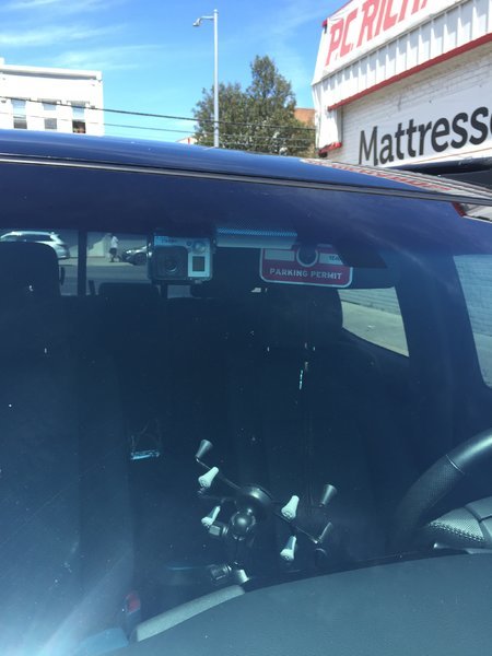

    Nothing crazy but slapped on my GoPro hero 3+ cam on the windshield
