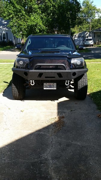

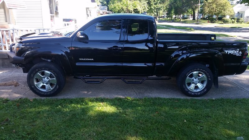

  1. Sep 2, 2016 at 12:17 PM
    DamnDaniel
    DamnDaniel Well-Known Member
    Apr 28, 2016
    #185571
    205
    Daniel
    2015 Tacoma
    Thanks @VolcomTacoma for helping adjust my leaf springs and u bolts

    Yeah, pinch welds were easy, especually using all that pent up anger and a BFH.
    Got it done, remolded the liner a bit, anly had a slight plastic rub at full lock backing out of the drive.
    One helpful thing with the liner. Down at the bottom of the metal wheel well, there is a gold on each side on the inside of the pinch weld. I just took one of the mudflap screws and forced it trough the liner into that hole. It secures the bottom tight hen just heat and mold the rest. I need to get the 885's and top spacers on. Twke it in and get alignement checked and see if I need the LR UCA's.

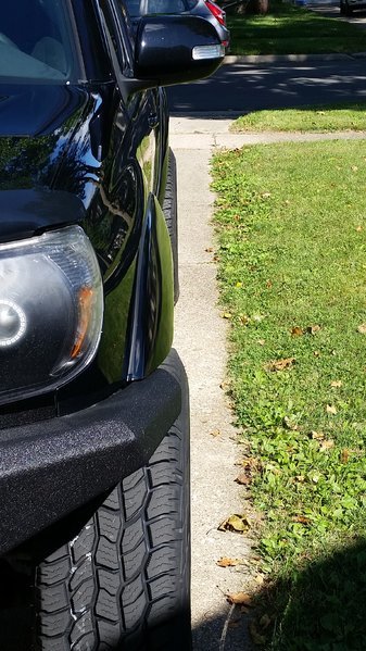

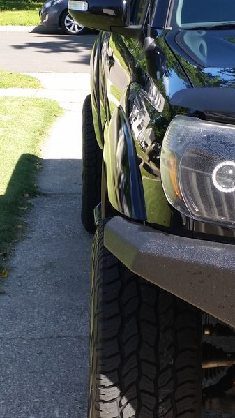

    If you were wondering about my rubbing issues being so bad I already know the answer and it about kept me from installing them.
    I put 884's on my truck, they didn't install the longer studs in the coilovers so I couldn't do the top plate spacer.
    When I put the lift on, I also put in AP UCA's. Wasn't really needed and bit memin the ass. They gave me 4 degrees of caster at the top of the tire, which pushed the tire back that much further. The rims I put on are 8.5" with 4.5" backspace, so the wheels stick out 2.2" firther, plus whatever wodth the tires added to that and my steering arc was altered pretty significant. The caster only magnified and compounded the situation. Then I put on a steel plate bumper.....
    I simply need to go higher, I have no doubt on that.

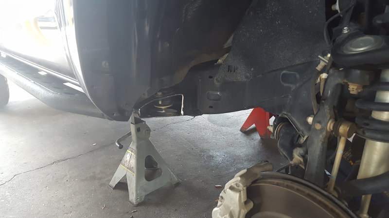

    Been awhile since I watched the vid. Simple jack stand under the frame and jack under the LCA? Does everything line back up pretty easily when reinstalling? I would likely be doing it solo if I attempted it.

    that sucks i had 17x9 4.5bs wheels on mine it really must be the combination of the bumper and high caster numbers.

    Yes. Pull it out and keep everything lined up, slide off old coil, slide on new one and reinstall. It's fairly easy and since you already need an alignment it doesn't matter that you're loosening the cam bolts to help with the process.
