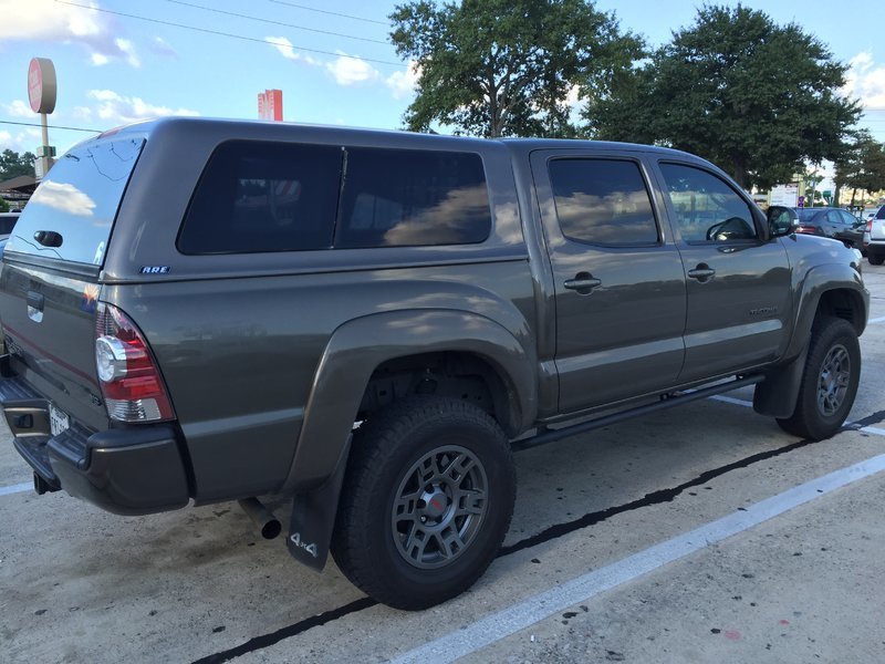

    Finally paint matched my shell!!

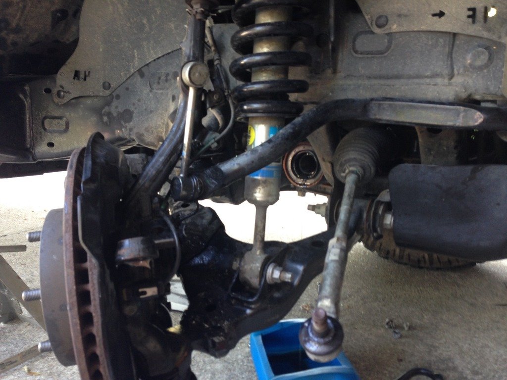

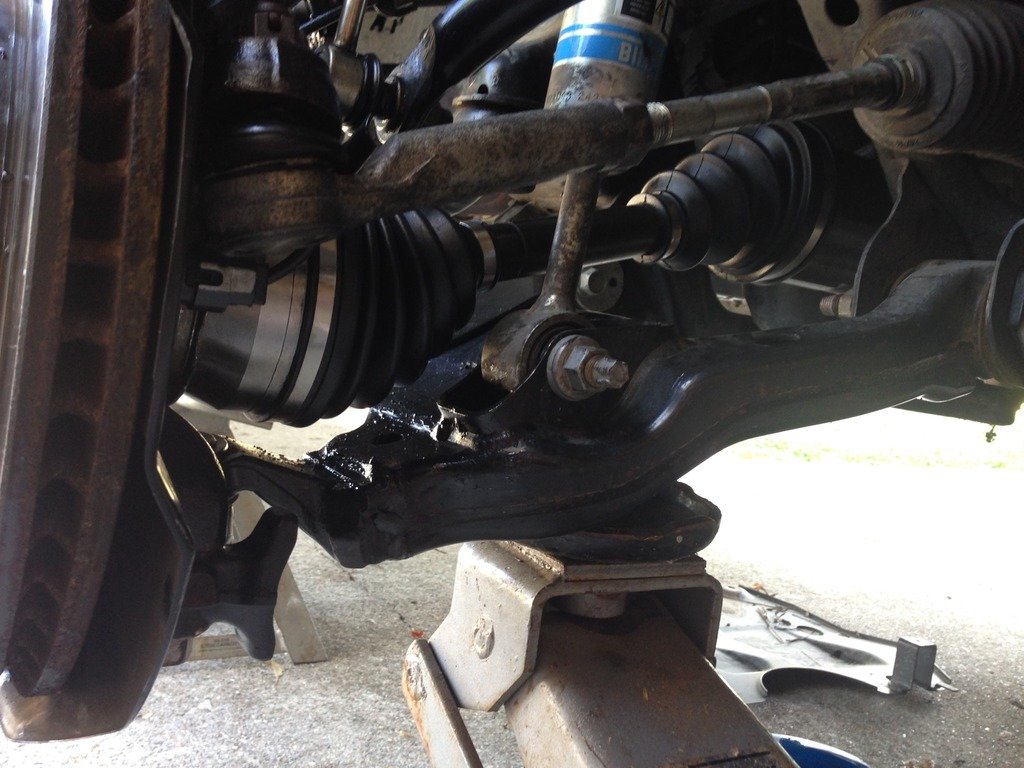

    Was it easy???? I have 2 axles to do alomg with lower ball joints? Lil nervous doing it myself.

    It wasn't bad. Remove the sway bar bolt, remove the axle nut, remove the tire rod nut. I used a rubber mallet to loosen the axle from the bearings. Remove the two bolts under the control arm. Gently pry the axle out from the diff. I used the mallet to seat the new axle into the diff and reassembled everything. Took about 1 1/2 hours.

    I did have to reach into my bucket of cuss words a few times. But now that I've done it once, I could probably do another one in 45min.

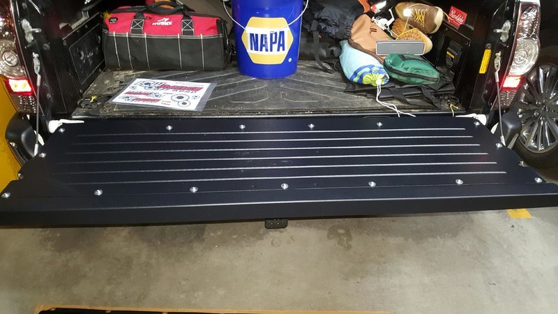

    Tail gate skin and cap
    and Pro face lift :D

    I can't wait to get mine color matched! It looks so much better.

    Did you by chance replace the seals while you had everything apart? Mine doesnt leak but was just wondering.

    No, I bought a whole axle on Rock auto for $60. I'll rebuild the old one later and have a spare

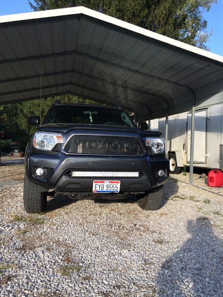

    How do you like the tailgate skin and cap?
