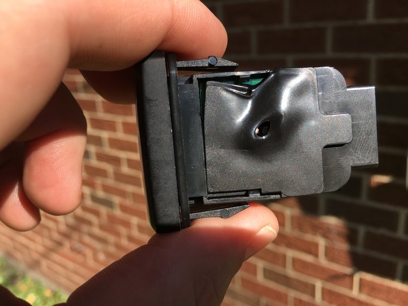

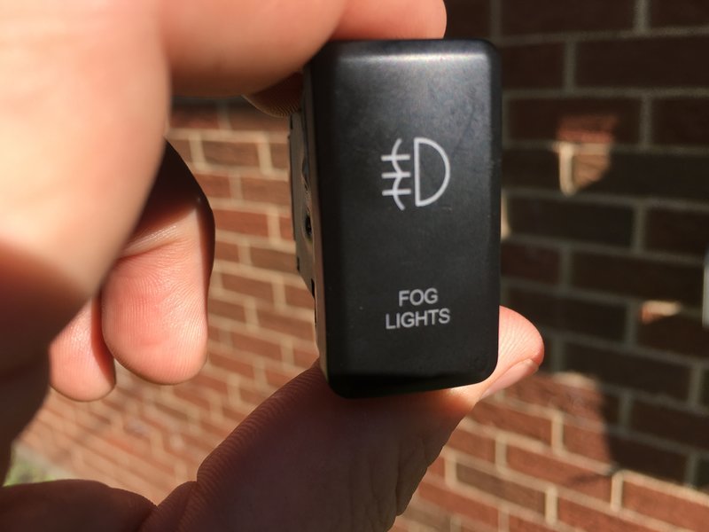

    So i did this last weekend. Not sure how. But i smelled something burning and the switch wouldnt click off. Pulled it out and it was melted and hot as hell. Not sure if its the cheap Amazon switch or the way i wired it. Its been working fine for 8 or 9 months and then last weekend decided to meltdown. Any ideas?

    Those look like the same switches sold on several sites. If so, they are only designed for 2-3 amp applications. Were you using a relay for your lights?

    No im not. Just a small fuse. I was wondering if that might be the issue.

    .... how small of a fuse? You should always use a relay with those (I have a few), but if you have a really small load and use a 2.5A fuse or so that should be okay. I'm guessing you used a 10A or more though?

    Yeah it's a 10 amp. Guess i need to get a relay. Pardon my ignorance but is there any particular one to get?

    Standard Bosch relay from the auto parts store will do the trick. You'll need some wire to go with it unless you have some already. You're lucky that switch didn't start a fire in your truck.

    Yes i am lucky. I was in a new town with the windows down and just thought it was the way the town smelled. It wasnt until i pulled into a walmart to pick up some camping supplies did i notice the lights wouldnt switch off. I immediately popped the switch out and noticed it was melted. Dodged a bullet there!

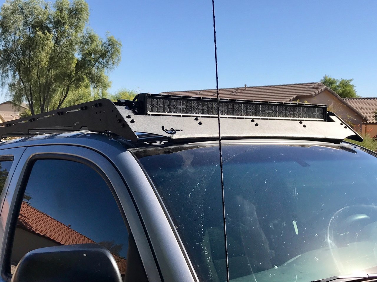

    Mounted the lightbar

    I don't have any specific recommendations for a brand. For things like lights I always keep most of the current on the engine side of the firewall. Just the low current switch part of the wiring in the cab. That means putting the relay in the engine bay, so I use waterproof ones. OTRATTW sells some on their website. Waterproof not totally necessary, but consider whether you do water crossings etc. when making that decision.
