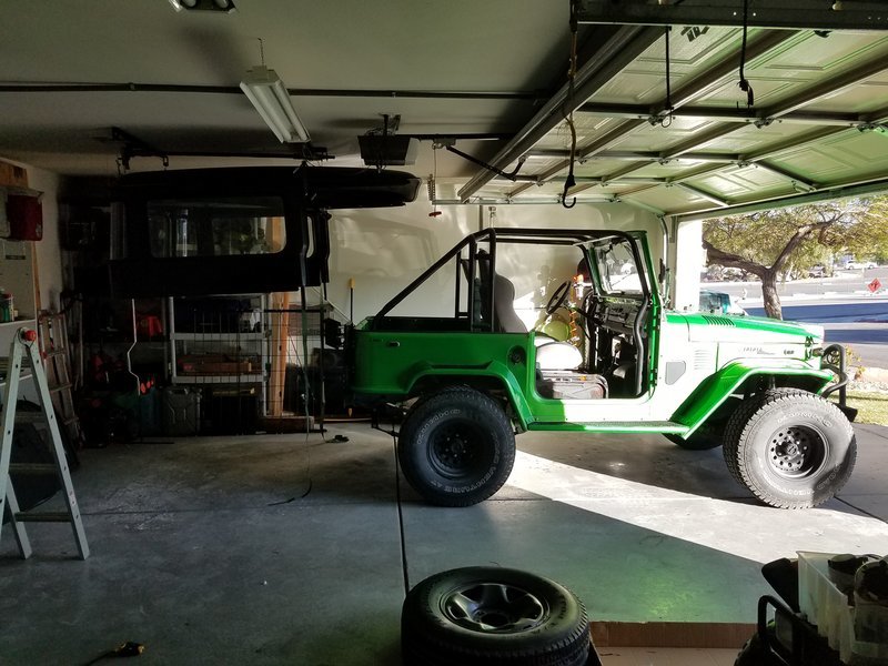

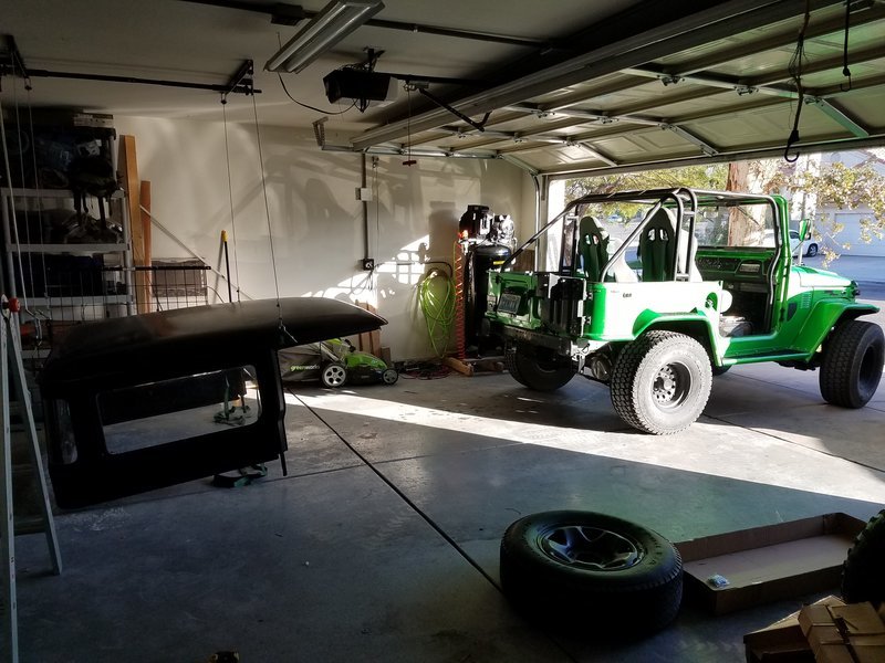

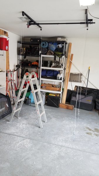

    Nice setup man! I wish I had your garage height! I just did a almost the same thing is weekend for my FJ40 Top, weights about 200Lbs, Plan on using it to pick my cage off and soon to own RTT.
    I used https://amzn.com/B0009I8AO6 off Amazon. Seems to work well lifted it right off no issues.
    Only thing i suggest if anyone else goes this way is when you get the kit go rebuy all the bolts and screws. The ones they send are kinda shitty.

    Yeah this one can only do 250lbs, Ive got a steel framed house so i had to use Wing anchors into metal C channel. but there are 10 on each side. Little over kill if you ask me. I think the weakness with this kit is the pulley systems on the ends and the center axle, The metal is a thin. The end bars are NOT coming off the roof lol. But i knew going into it that only needed like 200lbs lifted. Its a cool little lift, comes with a Hand crank or a Drill attachment.
