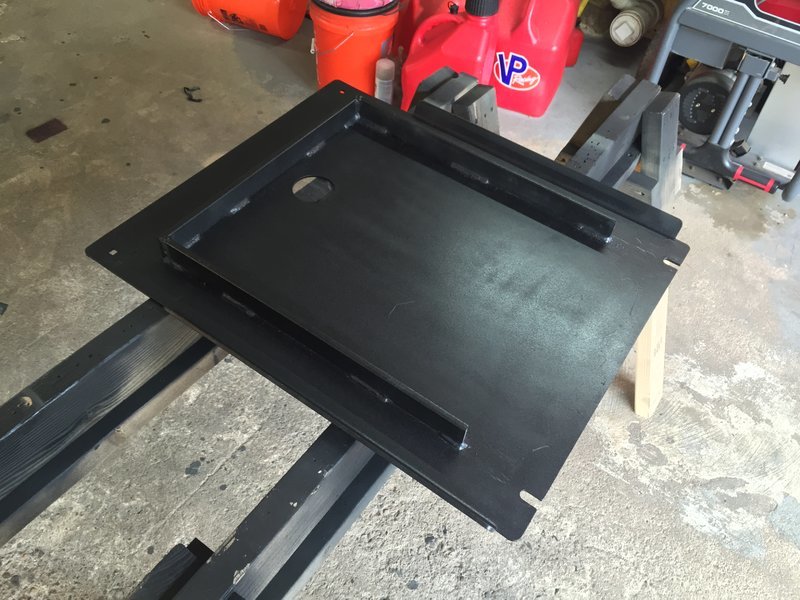

    Looks good. Just a heads up on the trans skid. It's weak point is where the lip on the sides ends. It ends inches before the crossmember. I bent mine all the way across.
    This was the fix after hammering it flat.

    Nice! Any more pics of where they attach to the crash bar?

    So is it a lot tougher with the added cross beams?

    Absolutely. I haven't bent that one again yet.

    What are the specs with doing the mod to them? What steel, how far from the edge and what's the length? I've got the transfer case skid coming so would this still work with it?

    Depends on how you wheel too if you need this. The off road park we go to is VERY rocky.
    It's 1 1/2" wide x 3/8" thick standing on it's edge. I don't remember any of the measurements but it doesn't have to be THAT exact. Mine just ALMOST butts up to the crossmember. I have all of the skids, the transfer skid will be unefected by this.
    Another option, is an x pattern with angle iron siting with the point up. I did it the other way because of that side lip being the weakest point. I figured I could have my guy weld an x in the middle if needed later. It's heavy enough the way it is though. I won't do any more unless I need to.

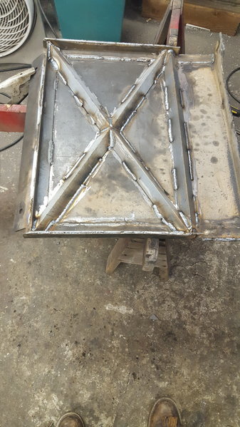

    This is how @stairgod reinforced his Mobtown skid.

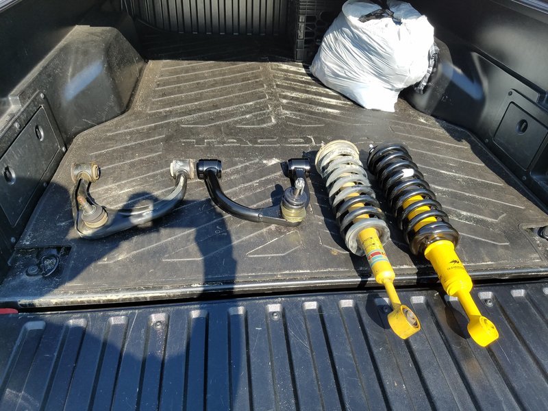

    20161102_112634.jpggot to the OME kit. front end took about 4 hrs total and the rear is being a pain in the ars20161102_112634.jpg 20161102_162039.jpg
