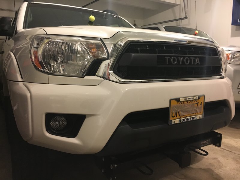

    Did you add the mesh to your factory fogs or are they aftermarket? I like the look.

    Thanks ! Very simple Mod. I used plastic gutter guard for the fogs and spaces in the grill. Cut the gutter guard a little bit larger and tuck in.

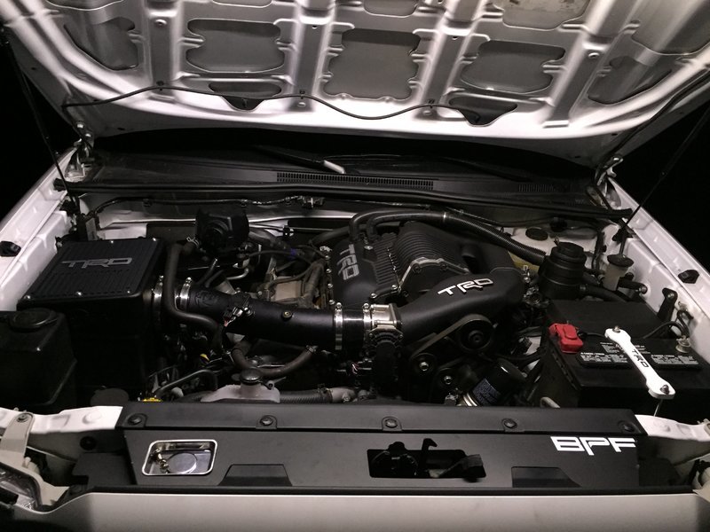

    Is that a magnetic bolt tray in the cooling panel?

    Indeed it is.

    Hot-damn, that's brilliant!

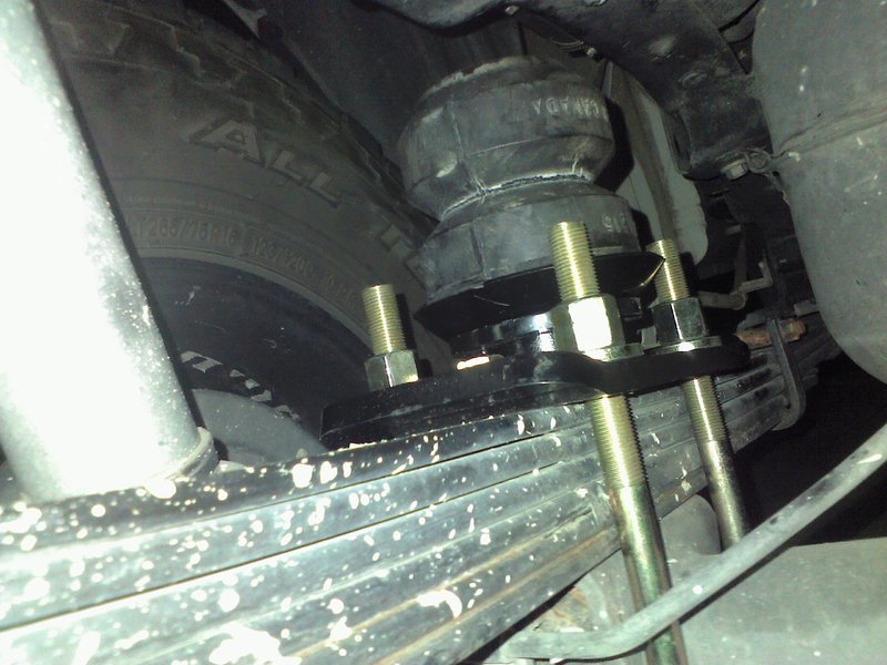

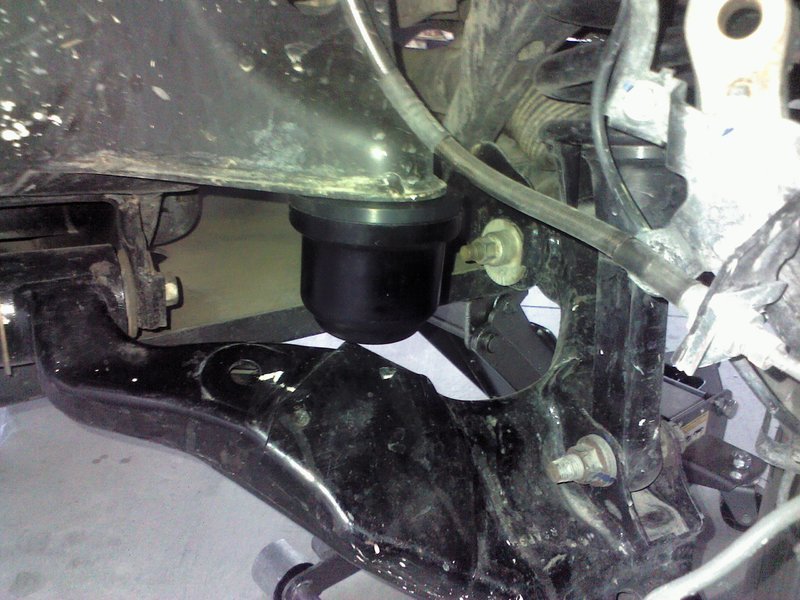

    Last night installed superbumps up front and the Timbren Ubolt flip kit. Haven't had a change to take out yet, hopefully will do that this afternoon on my way home.

    Check for rubbing on the corners and the hood. I had to trim mine and add some soft padding in a few places since there was rubbing that wore through to bare metal.

    Thanks for that tip!
    Just put mine on last night, so will see how it goes.

    I've wondered if you could flip up side down that Curt front hitch so its not hanging out there so low like a swollen lower lip, and have it come through between the bumper and grill.

    I like that idea. Is it compatible w/ both 4/6 cyl? Or do they have their own versions?

    Should be with either one since it just sits in that opening under the hood, above the radiator area, right "behind" the grille.

    It looks like you used a spacer on the front superbumps, is that because you have tall tires?

    I'm running 265/75/16's. But from what i've read these compress more than the OEM bumps and they suggest putting a spacer on it. I'll try to find those threads again.

    Be sure to post some thoughts on them once you give them a run. I'm thinking about putting a set on mine as well.
