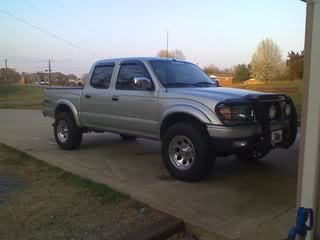

    Ray of Sunshine
    lift, wheels, tires
    removed running boards and mudflaps
    before
    After

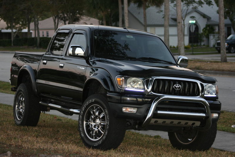

    I just put these lights on a couple of days ago. How do they look ?

    MUCH cleaner looking.
    Very nice!

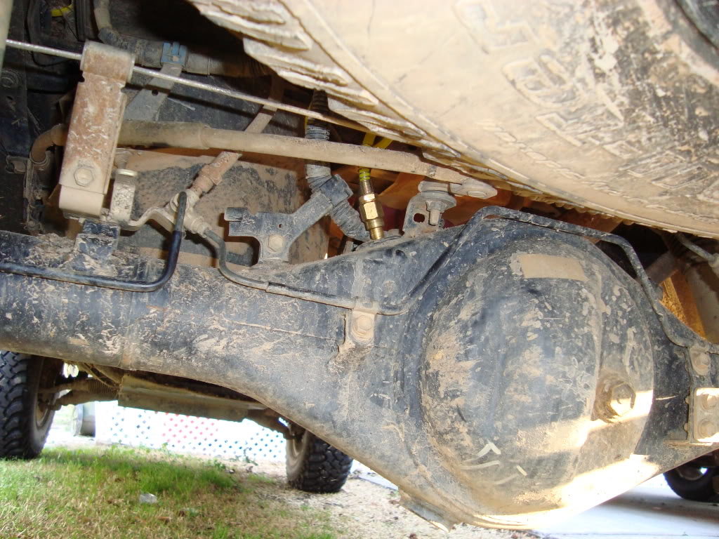

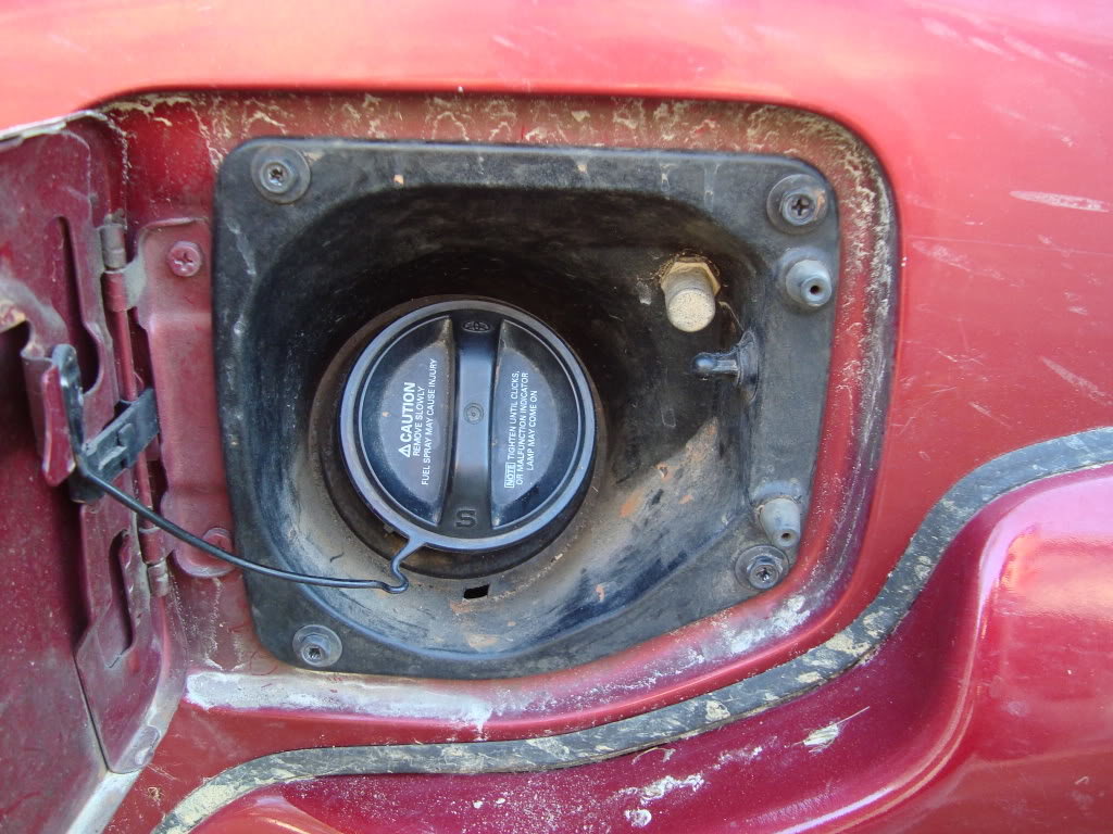

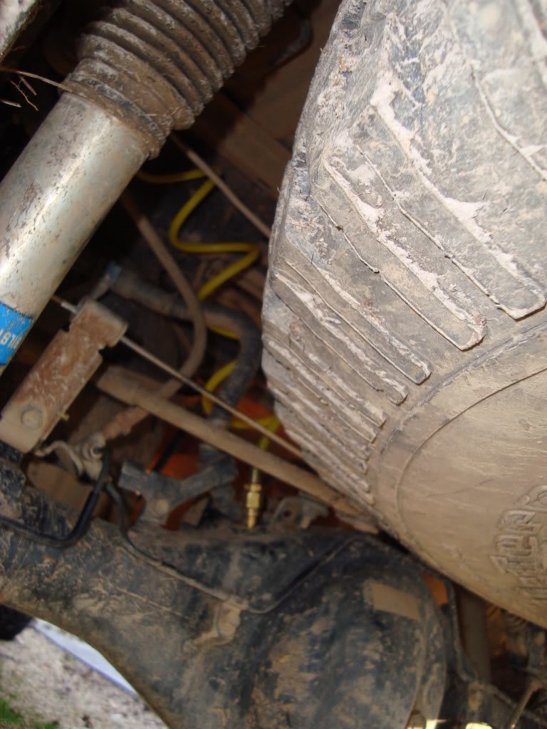

    ok so i didnt go quite as far as i planned...but i basically just got bored with dealing with it
    here's my diff breather extension
    From the diff
    and up to the frame
    and to the fuel door area
    was able to reuse original breather valve with the right brass pipe fittings
    as 1st gens go (2nd gens im not sure about) the threading INTO the axle is a metric size...but so incredibly close to a 1/8" pipe thread that it'll work...thread your 1/8" nipple into the diff...then top it with a 1/8" -> 1/4" connector...attach regular compressor air line with 1/4" ends...run to your end point...another 1/8" -> 1/4" converter...then re mount breather valve
    i've also got cool springy yellow air line instead of boring old black :D
    oh and i slapped some new stickers on :D

    to add to my diff breather...i think i spent right at $10 total on the whole setup
    i got the air line in a clearance package with some other compressor junk that i dont need for $3 because it was opened...and then the fittings were like $2.50 for the converters and $1.5 for the nipple
    all can be found at your local lowes
