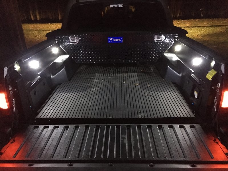

    IMG_0007.jpg Finished installing my Flush Mount bed lights from @Blais03 :thumbsup:

    Nice! Now I've added bed lights to the list of things I want to do to my truck.

    Looks awesome man!

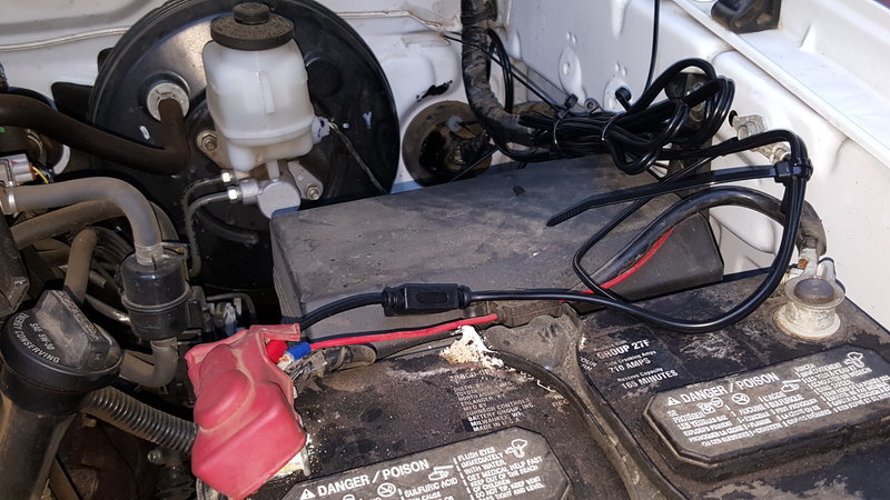

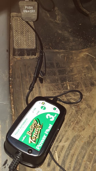

    According to my ultragauge short trips have been running my battery down. Hardwired a battery tender then used an extension to run the connex into the truck so I don't have to pop the hood every time I hook up the charger. Cut the grommet and pushed the extension thru, and applied plenty of rtv silicon after to prevent water egress. Getting under the hood and seeing a few acorns reminded me I need to do the rat screen mod at some point before they set up shop on my cabin filter. P.S. costco has these 3 amp 4 stage chargers on sale for 30$ (10$ off normally 40$) and they are 46$ on Amazon so that's a good deal.

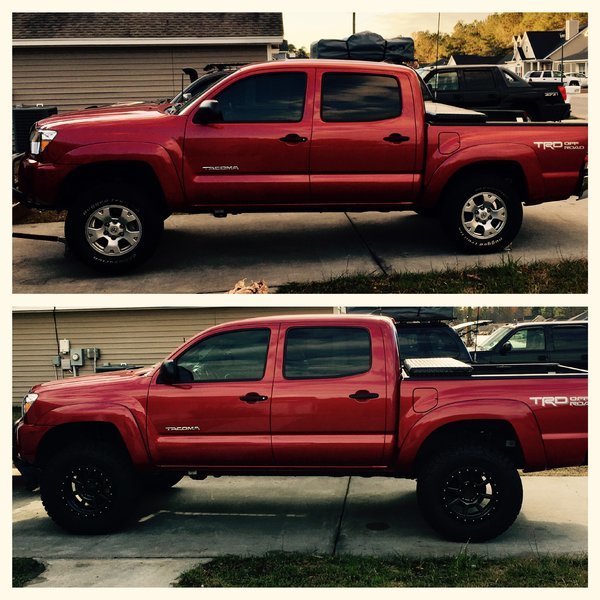

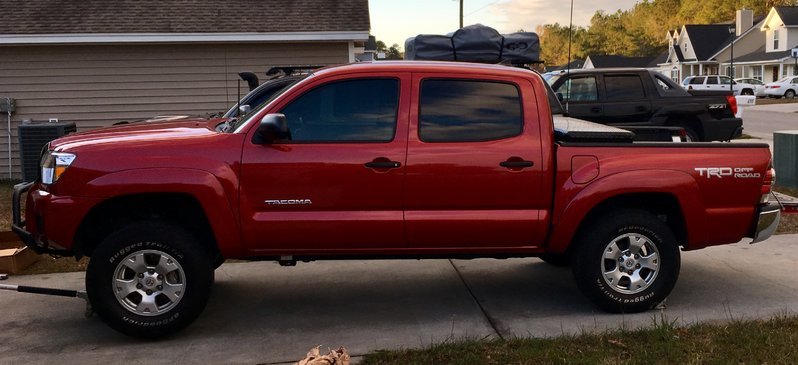

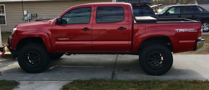

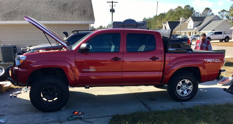

    What a transformation! I LOVE IT! Any rubbing or trimming?

    Light trimming so far. Will probably have to do some more. Will update with better pictures ASAP.
