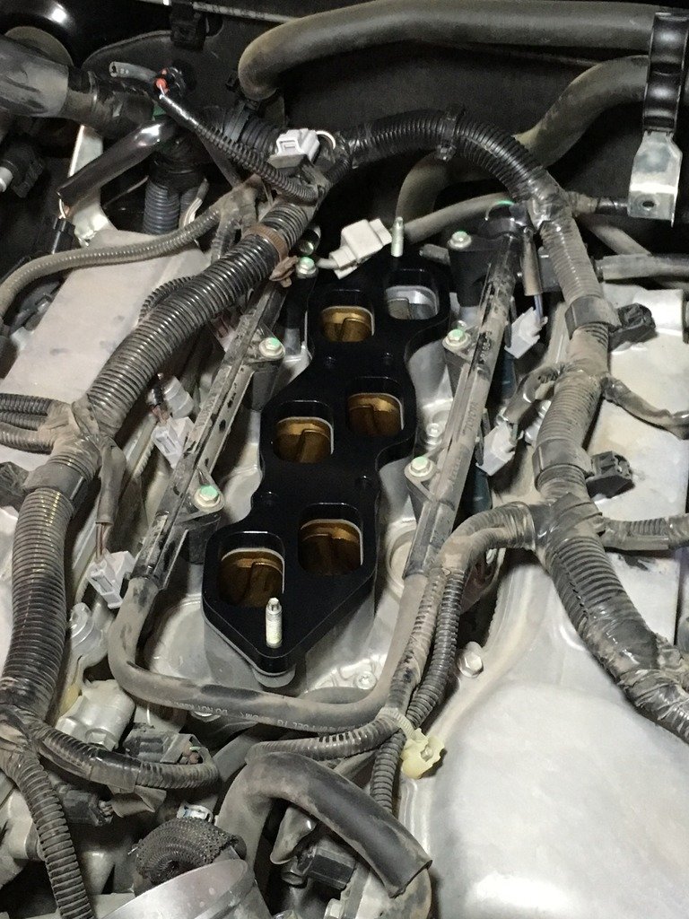

    Notice any performance gain?

    I am also interested in hearing your impressions in the seat of the pants gains,
    especially TQ if any.

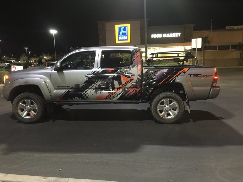

    I noticed a bump in Tq around 3000 rpm. The biggest part of this mod is modifying the intake manifold brackets it's super easy with a dremel but other than that it's simple. This just creates longer intake runners which increases low end Tq it might cost some up top but I could care less. It would be nice if this spacer was thicker but after installing it with all the wiring harnesses and vacuum hoses it's probably perfect. Hope this helps
