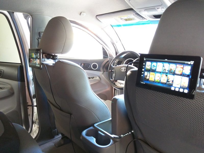

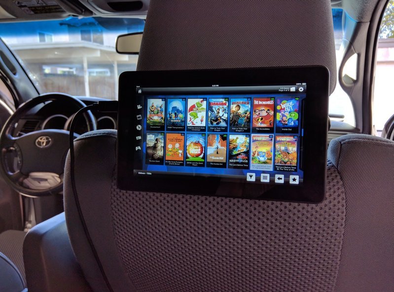

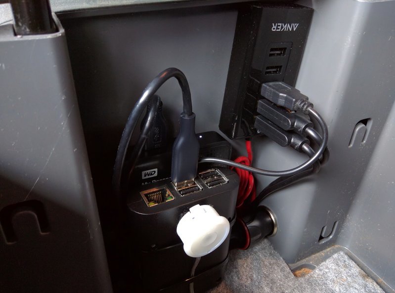

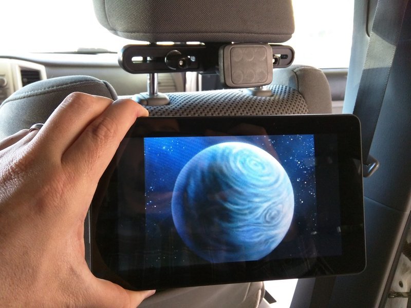

    Some additional details for you guys:
    I'm taking my family on a 3 week road trip from San Diego to Glacier, Yellowstone, etc in June and wanted to ensure my kids survive the journey. They're pretty good travelers when we're on flights, so I took the In Flight Entertainment as inspiration for this build.
    At the heart of this build is a Raspberry Pi 3 running a wifi hotspot and a 2TB Western Digital hard drive. The Anker power strip (https://www.amazon.com/gp/product/B00OHE8AOI) is important because it pumps out enough juice to where the Pi can power the HD without an external USB hub. The USB strip also powers the tablets. The 12v adapter in the center console is hooked up to constant power.
    Software-wise, the Pi is running vanilla Raspbian and shares the HD with Samba. For the hotspot, I am running the fantastic "create_ap" by Github user "oblique" (https://github.com/oblique/create_ap). create_ap can be installed as a system service to take all the networking pain out of setting up an access point. My startup script is modified to detect whether a second wifi device is hooked up so it can optionally share my home Internet connection with the tablets for the occasional app/game install.
    The circular white thing on the front is a button hooked up to the GPIO on the Pi. When pressed, a script running on the Pi issues a clean shutdown so as to avoid corrupting the memory card (a future build will have the OS run as read-only so can just pull power without the clean shutdown).
    The tablets are Kindle Fire 7" (bought on Black Friday for peanuts) running Kodi (the media center formerly known as XBMC). A couple other offline friendly games are installed making the whole thing capable of running without an Internet connection.
    Let me know if you have any more questions!

    so is the Pi connected thru your wireless provider to be able to emit the wifi, I do apologize if that sounds dumb. like I can turn my phone into a wifi hot spot and connect my laptop to it and it will use up my data when I download or stream. I'm just trying to wrap my head around how exactly the Pi is broadcasting wifi.

    The Pi has built-in wifi, and thanks to create_ap, essentially acts like your home wifi router (only, the majority of the time without an Internet connection). The tablets join the wifi network served by the Pi which allows the tablets to connect to the Pi's network file share to play movies and music from the HD.
    The only time the tablets have an actual Internet connection is when I attach another USB wifi dongle (configured for my home wifi connection) to the Pi which enables routing the tablets' traffic through my home connection.

    Thank you! Makes sense now haha so when ur parked at home and you plug in ur configured wifi dongle, are you able to transfer files onto the HD wirelessly without having to remove it from the truck anytime you want to add a movie or something?

    Exactly! I can transfer everything wirelessly when I hook up the 2nd dongle. Or I can remove the whole thing and hard wire it in my house since the only connection in the truck is Velcro and a single USB port. I also have the 2nd dongle configured for my phone's hotspot for the occasional app install on the road.

    Sometimes I get bored and like to mess around with things like that, that's why all the questions, I'm just thinking I could maybe wire something up like this to wirelessly put music on a HD mounted in my truck and have it connected to my HU. yes I know I could just bring the HD inside but its fun to tinker with things like that.

    Something like a HDD with Wifi might work for your needs: https://www.amazon.com/dp/B00JSQV44S
    I went with the full Pi so both kids can play movies at the same time. I also plan on hooking up my bluetooth OBDii adapter to the Pi for data logging... might even add a touchscreen display at some point.

    That would indeed fit my needs perfectly :) less tinkering tho :( do you know if it requires an independent power source or is it powered via USB, looks like just USB but figured is ask just incase
