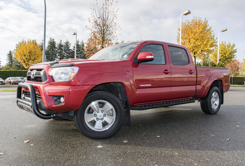

    Lots of bolt on chrome stuff
    How do you like the poly LCA bushings? I've been thinking about getting some. Are they the energy suspension ones?
