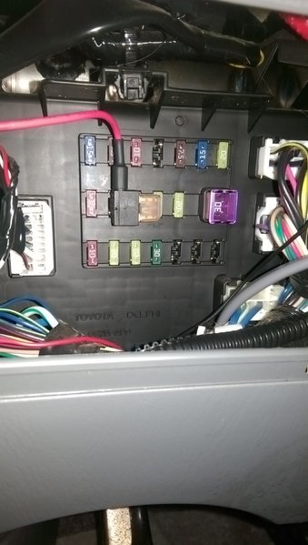

  6. Jan 16, 2017 at 7:16 PM
    Soul Surfer
    Soul Surfer Jimi Was Last Seen: Roam in’ Around…
    Aug 10, 2015
    #161457
    16,900
    Jimi
    West Central Florida Coast
    ‘25 TRD OR
    I put mine in the blank shown here. Works great. I installed two 5 amp fuses in the tap. Photo is from @nazlax10 ! :hattip:

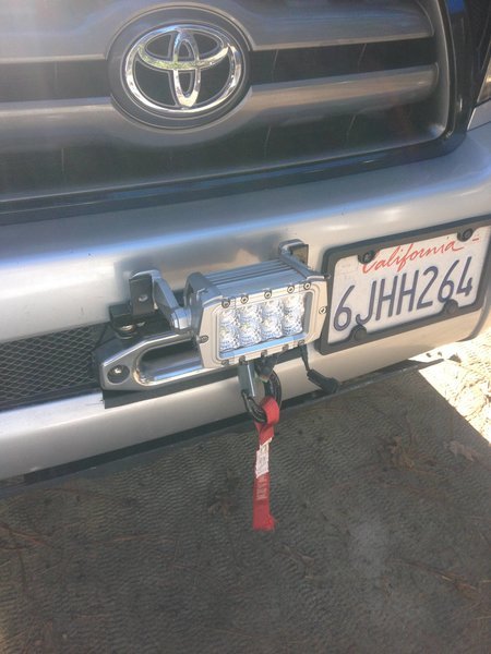

  7. Jan 16, 2017 at 7:20 PM
    mike5krnr
    mike5krnr Well-Known Member
    Oct 24, 2016
    #200568
    190
    2008 Toyota TRD
    3" lift, Warn 9000 winch, LED flood light, 10lb Powertank, Thule Rack, Maggiolina Roof Top Tent
    Swapped my 30w Flood light for a 100w Flood light. Made the brackets out of some leftover steel tabs I had. I might change the mount to something different so that it doesn't stick out as far as it does now.

    This that and the other thing.
    what year is your truck? I have an 09 sport and I had a blank in the fuse panel behind the coin tray. middle row, second one in from left. tested it with my voltmeter and only gets 12v in acc. I put a add a fuse there to power my usb/aux.

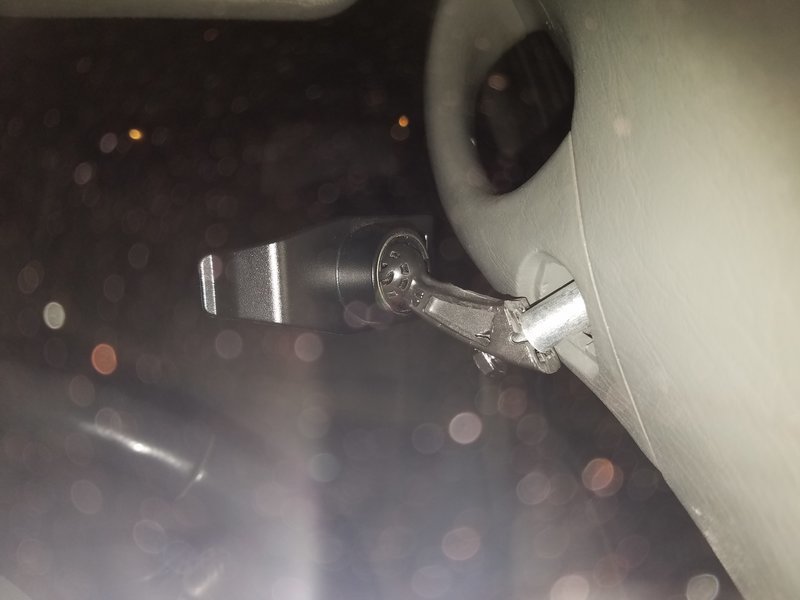

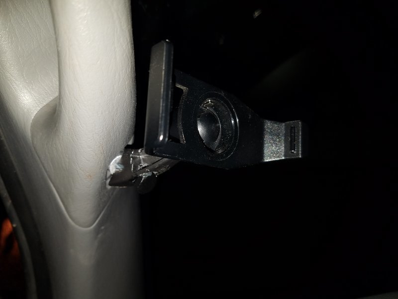

  15. Jan 16, 2017 at 9:43 PM
    orezona
    orezona title unspecified
    Nov 7, 2016
    #201811
    5,553
    satan's skillet
    2006 TRD OR DCSB OMGWTFBBQ TL;DR
    WARRANTY VOIDED
    Made my own ghetto A-pillar phone mount...
    Butchered an old Garmin Nuvi (or whatever) suction cup mount and used a regular M6 65mm Bolt with a little aluminum spacer.
    It's too high. I already know that and the angle isn't ideal but I know how to fix all that I just need time to rebuild it.

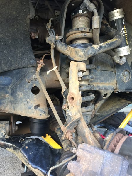

    NABeast
    NABeast Un-Sub’d
    Jun 23, 2013
    #106854
    1,601
    Paul
    Florida
    '08 4wD
    ImMrYo mirror bracket. A/C, P/W, Tilt, Cruise, AM/FM CD
    I would invest in some longer brake lines, they look a little stretched at that angle.

  18. Jan 17, 2017 at 3:21 AM
    EatSleepTacos
    Mar 24, 2015
    #151688
    59,838
    Randy
    West Valley, AZ
    2017 4Runner
    Had a similar setup in my truck!
    Use the fuse that says TAIL. Then your switch will only light up when the taillights are on i.e. parking lights/headlights on.

  20. Jan 17, 2017 at 4:22 AM
    Soul Surfer
    Aug 10, 2015
    #161457
    16,900
    Jimi
    ‘25 TRD OR
    The blank slot that I posted does the same.
