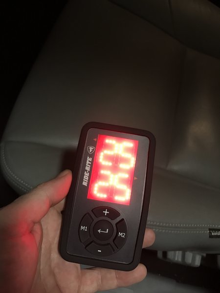

    Wireless airbag control!!

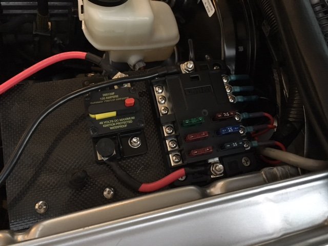

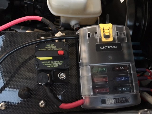

    Looks like the ground wire is really close to the positive post. I would try to move it a little further away from that post.

    Yeah I am well aware and was a bit concerned myself, this is work in progress. I only had about a foot of 8 AWG cable of red and black left over from my boat project and just wanted to get the main part done today. Tomorrow I will bring home some longer lengths and run them so they are apart and make cleaner runs. Thanks for the heads up and for pointing out the need to keep your pos and neg apart.

    It could of been the angle, you might of had a 2-3 gap between them, they just looked close to me. Good that you already planned on getting some longer wire to fix it, I'd hate to hear about someones ride going up in smoke because someone didn't say something.
