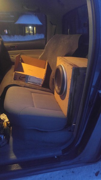

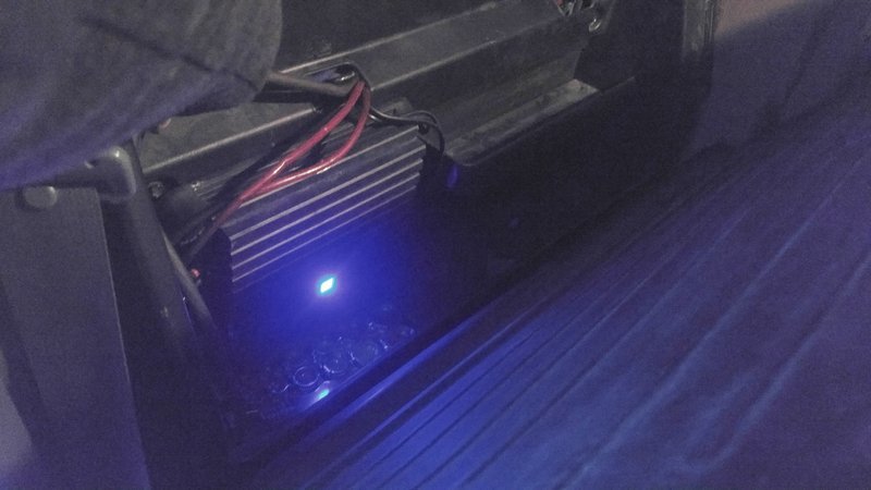

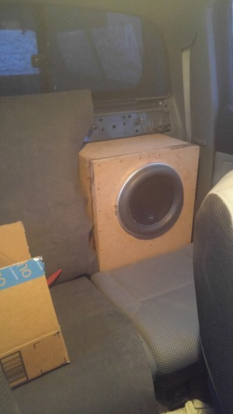

    Custom painted 6112's Fox 2.0 12" in the rear Allpro expedition leafs (garbage) Pelfreybilt aluminum single hoop front Full size pickup bedslide modded to fit Satoshi grill Ubolt flip kit Archive garage shackle flip 5" Sumo supersprings 1500lbs SPC uca's Full set RCI skid plates Weld on sliders ABS killswitch Pop'n'lock power tailgate lock Falken Wildpeak mt on FJ rims Plastidipped emblems Ebay projector headlights Smoked aftermarket tail lights High output led reverse lights Hella horns 330w 5d led bumper bar 18w spots on track facing rear (fuck you lights) B&m trans cooler Bussmann fuse box ECGS bushing Big 4 (0 gauge ofc wire) upgrade Mechman 240 amp alternator Jl 10w7 in a 1 1/2" thick wall custom box Alpine 1000w rms mono amp Group 31 AGM battery installed next to sub Yaesu 2800 Bearcat 980 in dash with wireless mic and stainless whip Diff breather mod Hilux snorkel Turbine pre filter Baja Rack low profile cab rack Rifle case on rack Shovel and axe on quick fists in bed Flat and spade shovel mounted in bed Highlift mount in bed Tech deck with magnetic ram mount Tab s7 on ram mount
    Still gotta do some finishing touches. Clean up wiring, sand and carpet box ect. But for now BOOM BOOM! 20170201_072016.jpg 20170201_072229-01.jpg 20170201_072943.jpg
    I wanted to have an angled box but it was impossible to reach the volume necessary.
    Kuntrykid and ChadsPride like this.

    Picked up the same speakers. How long did it take you to install these? I haven't opened up my door yet so not sure what I'll be facing once I do. Did you need any mounting brackets?

    Definitely need mounting brackets.... Definitely

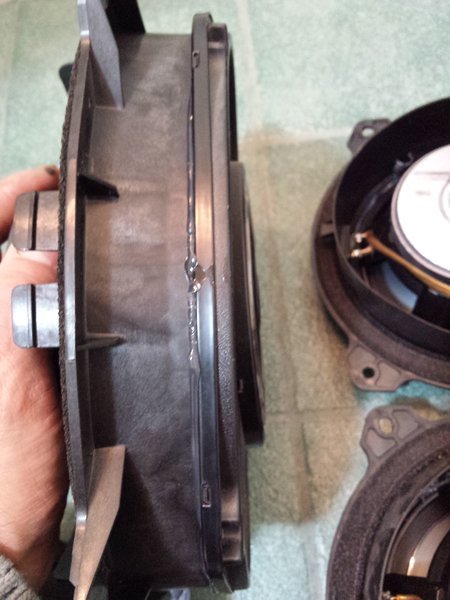

    Or do what I did and rip out the old cone from the factory speaker and glue the new one to the frame
