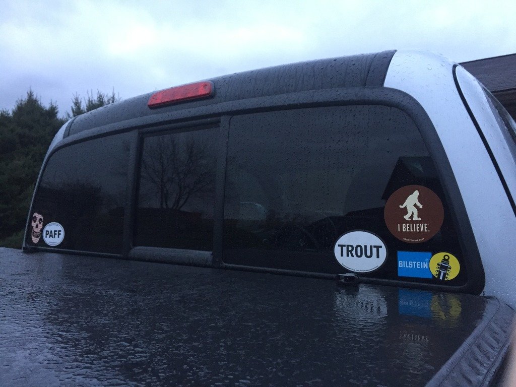

    Added a new sticker (the Yeti one) -

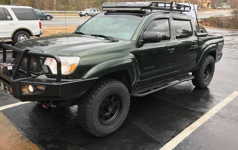

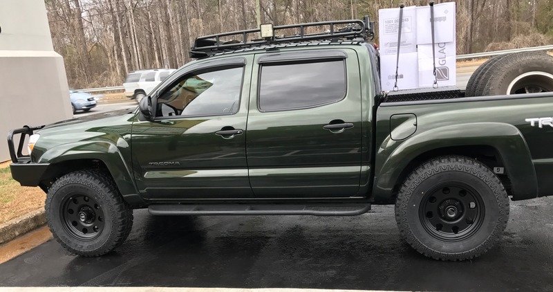

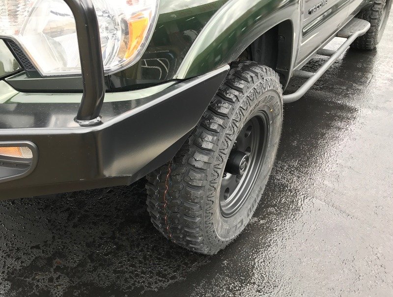

    So I finally got new shoes and socks. American Racing 17x9 Baja Wheels in satin black, Black lug nuts, and 285/70-17 Mud Claws. $1,369.00 total. I have not done the CMC or trimmed anything yet. I am getting very minor rubbing on front inner plastic liner with the wheel at almost full lock in reverse but nothing else. I plan on clearing everything soon but for now its good to go.

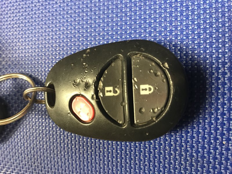

    IMG_0843.jpg Dog got to it. Any cure? Guys? Help? Buy one from my toyota? How to program?

    Wow, that looks pretty ruff. That's a real Catastrophe. :rolleyes:

    Find a used one and swap the guts? Ive done that with VW keys with success

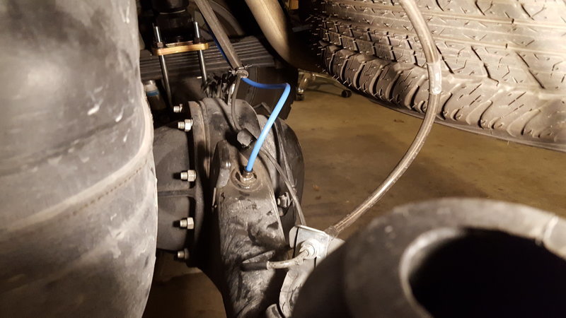

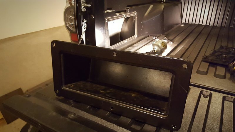

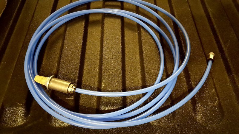

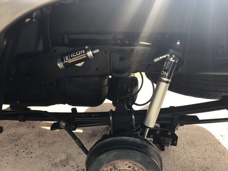

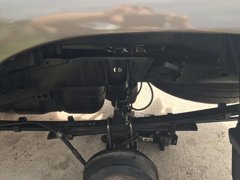

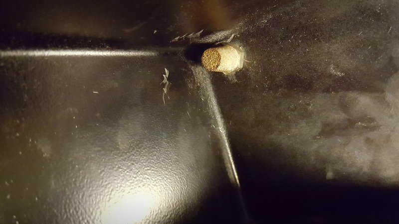

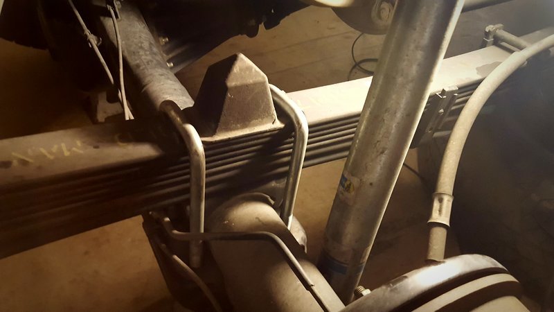

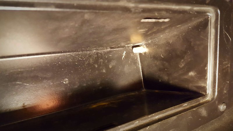

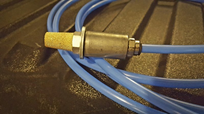

    Yesterday got my diff breather extension mod done

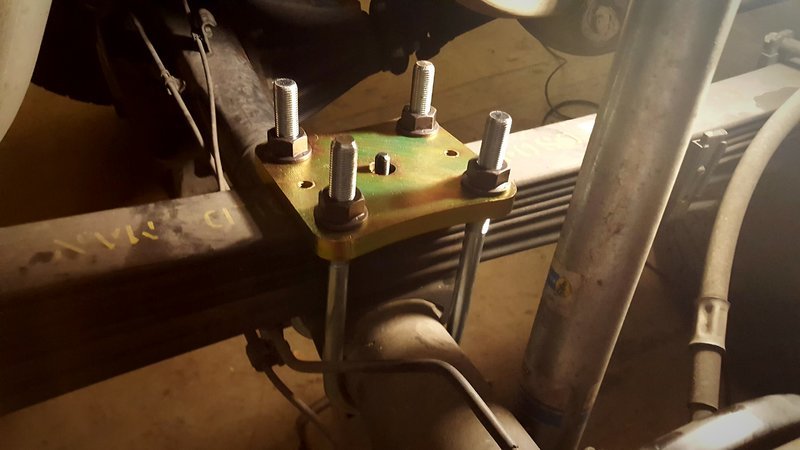

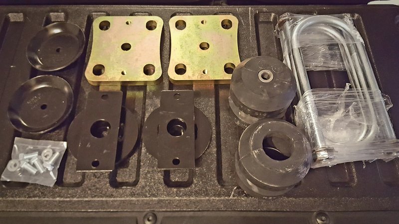

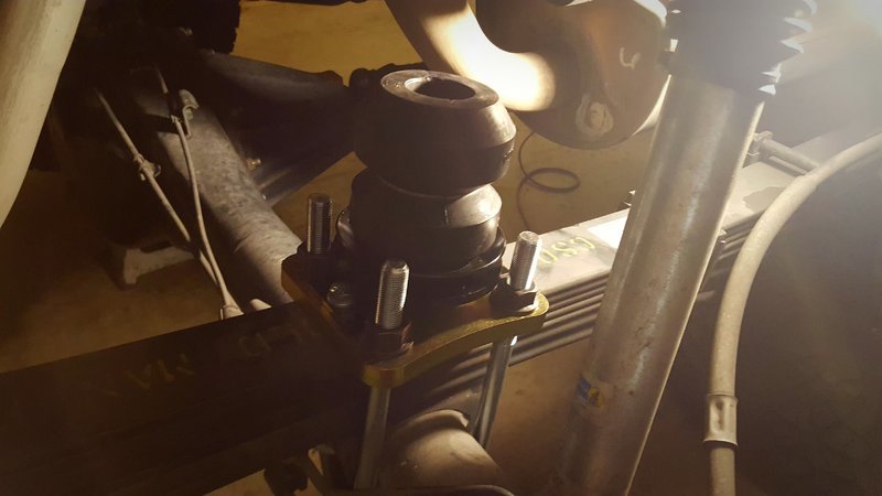

    And installed All Pro Ubolt flip kit with Timbrens
    Before
    After

    Chad you dirty bastard I didn't know you were doing the difference breather mod :D I want to do mine too

    Get 'er done man!!! When I took the stock breather off the sound of pressure releasing happened. So that thing was already clogged full of grime and whatnot. Happy to have this mod done finally!

    i thought i recognized that setup!!
    Tip of the day: water/mud can still get in the bed box's (or basically anywhere for that matter). where the door hinges on the bed box is the weakness, or if you're in deep water :eek:
    you can route the breather behind the driver side tail light and hold it there with a zip tie. its a little higher point on the truck and i've never seen mud splattered in there (and if you go that deep in water, chances are you're going to be sucking water in the intake...)
