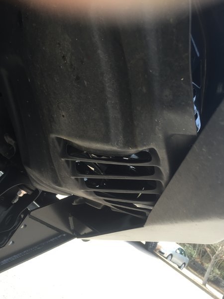

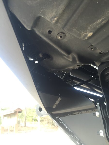

    Not the best... But here you go -

    Mine are not cooperating and not tucking well.

    No problem!
    I used a couple of zip ties and zipped em to the fog light bracket I believe.
    If they aren't cooperating, hit them with a heat gun (less $10 @ Harbor Freight) and that should soften them up enough get them where you want them!

    Haha, I wish that were the case... Would've saved a lot of money in gas since then!
    Just to clarify, the fender liners haven't moved since I zip tied them to the bumper :muscleflexing:

    Any reason you didn't trim them?
    Potential to return to stock?

    Mine tucked in just fine... I didn't feel the need to trim them afterwards.
    But , it will be nice if I ever do return to stock... Plus I figure being tucked will keep mud and grime out of the engine bay better than if they were cut... And they should protect the the air intake a little more as well.
