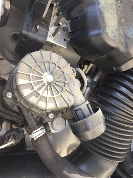

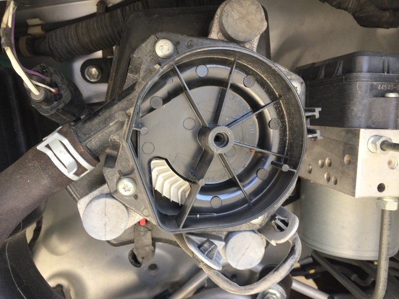

    Thanks man,got the 2.7, so no cover on mine like I see on v6. Just wasn't sure how easy it was to open the unit up.:bananadance:

    NP. Pretty darn easy. Hardest part is snapping off that cover thingy on the end.

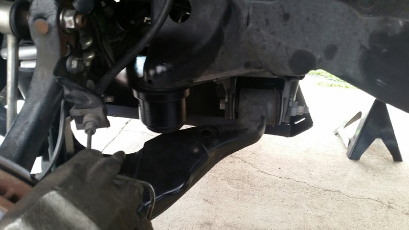

    I swapped my ECU with a used one from eBay. My old one had the Bully Dog tune which I do not like and unfortunately despite what Bully Dog says, their tune is not removable. I flashed the new ECU with the TRD tune using Techstream and my new Mongoose cable. :D
    I also installed the ECGS bushing to replace the needle bearing on the driver side front diff. Since I installed the Bilstein 5100 shocks in front, the growling noise from the loosey goosey needle bearing was pretty unbearable. ECGS did us a huge solid by making that bushing! Now my truck rolls smooth and quiet.
    I was being cheap and didn't order the removal or installer tools from ECGS. I couldnt justify the expense for something I will likely only use once. I improvised and made my own removal tool. The big threaded bolt and the nuts are from an old Harbor Freight spring compressor. The big washer is from one of my stock shocks which I recently replaced with 5125s. The little oval washer is a piece of mounting hardware left over from an old trailer hitch. I ground it down to the shape needed to slip in behind the needle bearing. The socket is 2 1/8", 3/4" drive.
    For the install tool I used a big 1/2" socket and an extension, but with the extension in the socket backwards.
    I replaced the axle seal as well and used a similar setup to the above pic, but with a larger socket.
    I also installed the OME carrier bearing spacer kit. I'm waiting for the JBA upper control arms and Bora spacers to arrive and the suspension will be done. The truck needs a wash but it isn't truck wash weather today.
