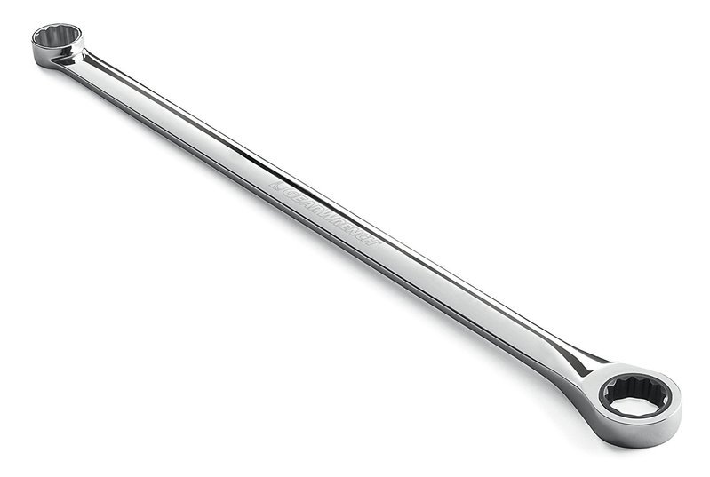

    Installed the Energy Suspension cab mount kit today. Dark when I finished, so no pics.
    A 14mm double box end, long pattern, ratchet wrench would have been handy...

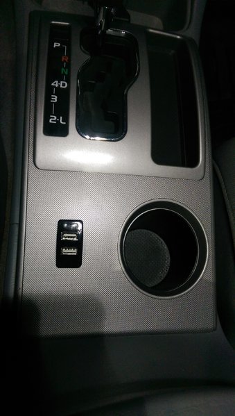

    Installed this today

    is there a thread on how to access back there? I'm waiting for mine in the mail and when it comes in I'm going to do the same thing haha just not sure how to get back there to do the wiring and what not

    I popped out the blank, then fished the wires thru the hole using a stiff wire out under the dash on the drivers side then wired it using an add-A-Fuse. 15 minutes tops

    fair enough man thanks, pretty much just some creative thinking, I can work with that :thumbsup: I wish I had known about these before I did what I did lol I ordered a usb/aux one so I can tie it into my HU. I will also be adding my abs kill switch down there too assuming it fits. the dimensions of the abs switch sound similar to the usb/aux one I ordered so we will see how that goes first.
    http://www.aironboard.com/online/pu...toyota-oem-replacement-abs-off-led-amber.html
    This is what I have now :anonymous: so once I have one under the ac controls, looks like I will be ordering a new centre console thinger lol so for those of you who have blacked out your interior and have an extra one laying around (that will fit an 09) ;):thumbsup:
