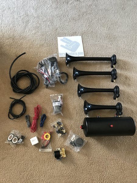

    I tried to find some sound clips but was unsuccessful. Is that a beep beep horn or a semi truck type horn?

    Somewhere in between. Are you going for a semi style horn?

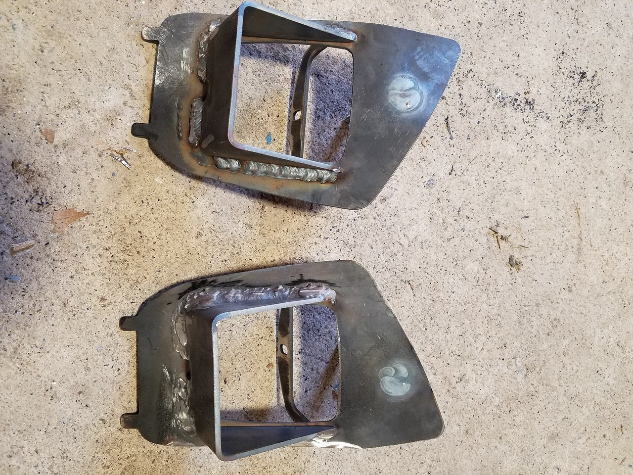

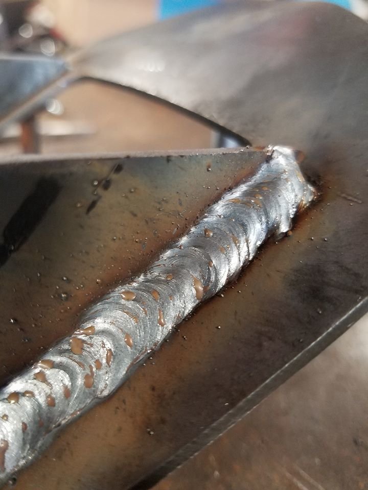

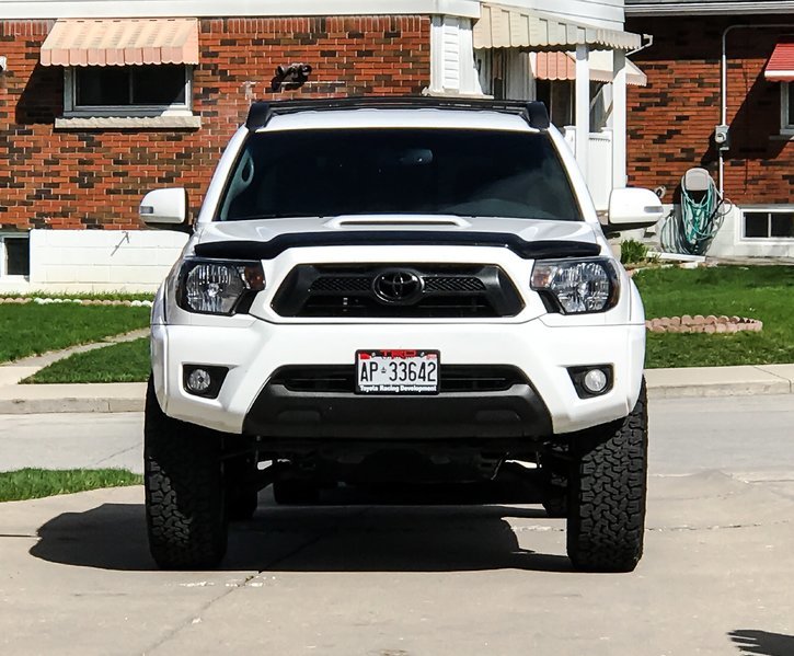

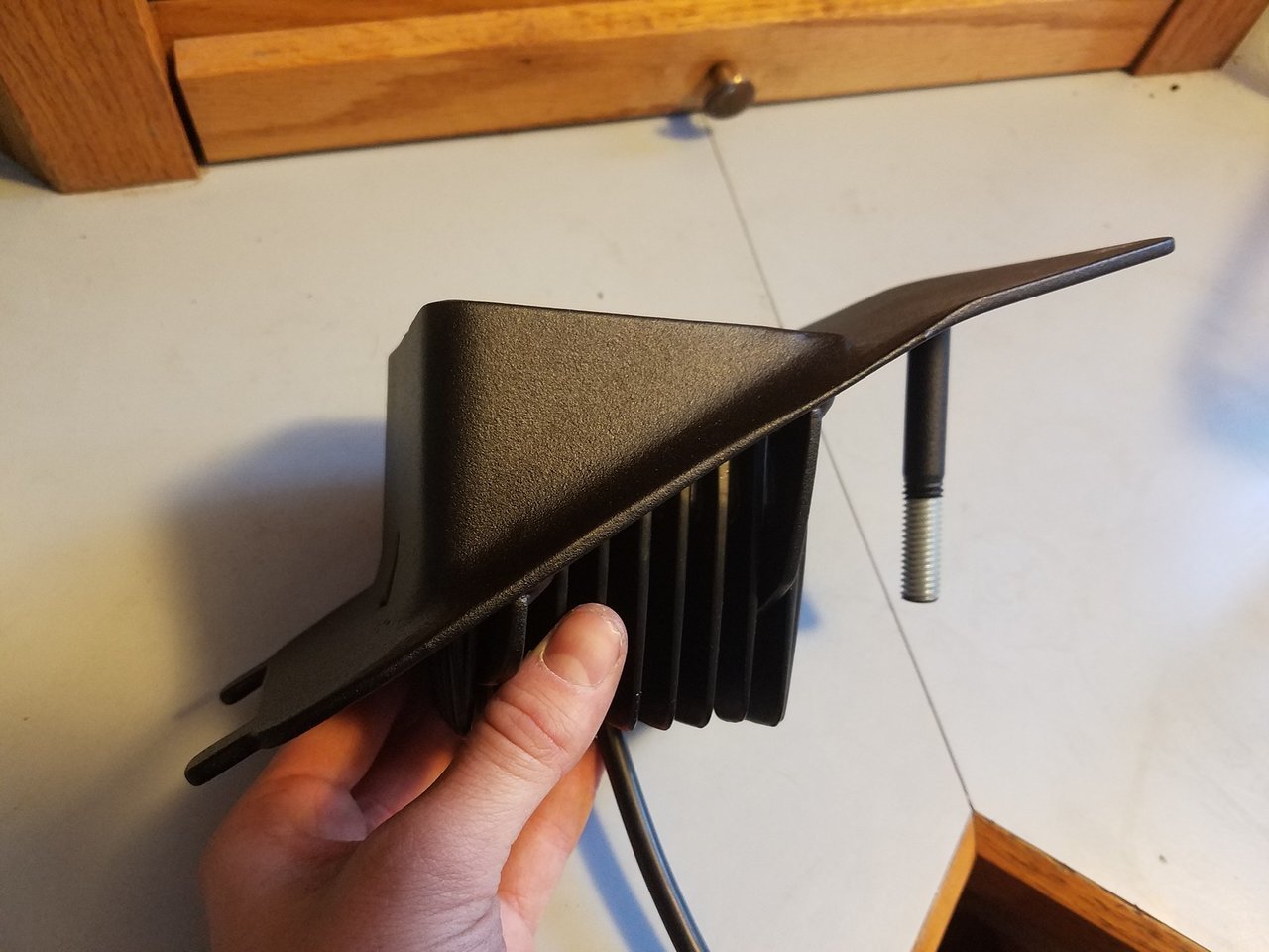

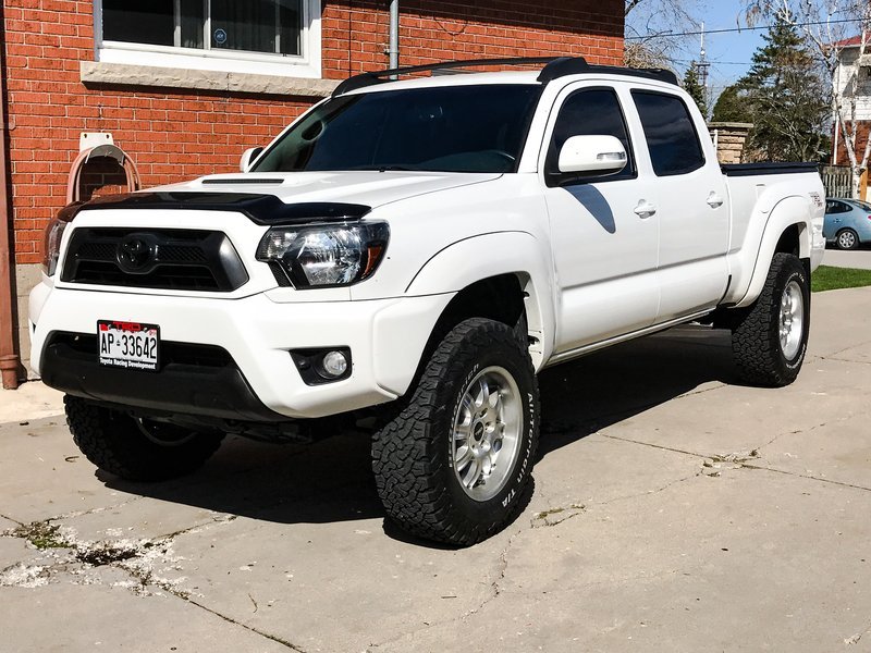

    Finally got around to posting this. Made some modifications to my Apex fog light mounts.
    The welds were quick and dirty since they were getting completely smoothed out anyway. I massaged the welds to leave a smooth transition from the mount itself to to the shield I welded in place to protect it and clean up the look. Followed it up with powder coating 2 coats of zinc primer then the mini texture black that matches everything else on the truck

    Wow. :thumbsup:

    Just looking for something fun for the trails. I don't currently have a horn though so this would double to help someone pull their head out of their ass if need be.

    Those horns are pretty loud, and nice and compact. You could always just go balls to the wall and do this. This gets everyone's attention! It sounds like an OEM horn but 10x louder.
