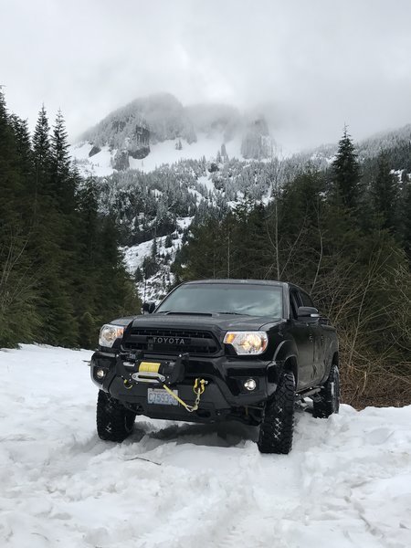

    Ok this is EXACTLY what I want for my taco, the front tow mount with hitch for winch, so I can move it from front to back. Remove it in the winter and when not using it. Please tell me the manufacture of your front end amazingness and the winch + accessories for it.
    *nursing a stiffie from your sweet rig*

    The receiver with recovery points is @Mobtown Offroad . Here is the link:
    https://mobtownoffroad.com/product/front-recovery-bar/
    I went overboard on the winch, but it was too good to pass up. Now the limiting factor is the receiver. It is the TJM 12K winch. Older model with a 7hp motor rather than a 5.5 that's been re-geared from the 9K. One problem with this was that its pretty big so I took me a couple tries to find the right carrier. This is the carrier that I ended up with and pretty happy with it.
    https://www.amazon.com/gp/product/B00OUPLCAI/ref=oh_aui_detailpage_o05_s00?ie=UTF8&psc=1
