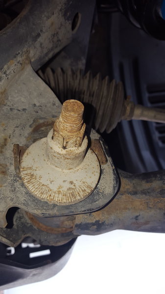

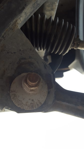

    Went to get an alignment and got bad news. Couldn't perform the alignment on the right because of the lower control arm. May have to take it to the stealer ship so they can rape me to fix it unless someone has experience with this.
    Hard to see but the tab is bent outwards
    How does this happen?
    Better pic

    Most likely your last alignment shop bent the tab as that shouldn't be upside down either.

    Cam tab is bent. Happens from jogging the wheels hard wheeling or running into curbs. Shit like that. Cut them out and reweld some total chaos ones in there and you'll be rocking. I'll find some pics of mine.
