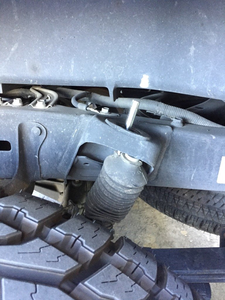

    I had something like that happen to mine. the threads were still good and the shaft wasn't bent so i pushed it back through. corrected the boot. reinstaled with new washers and bushings still doing fine

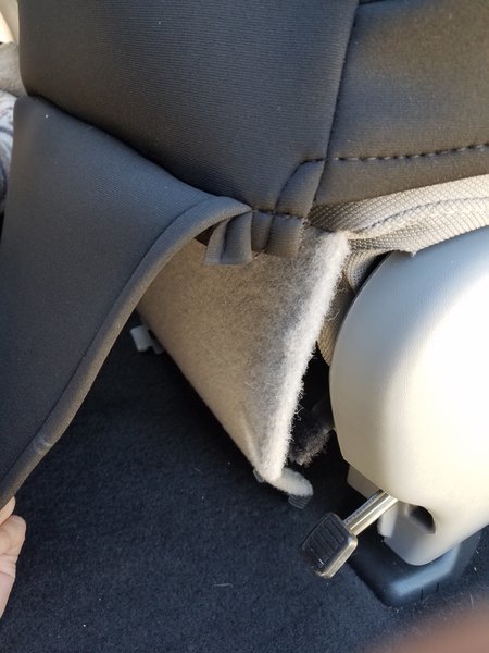

    I installed Clazzios a couple weeks ago, wasn't about to pull the cover up to tuck this under, I just cut them off on my seats.

    Yeah it doesn't look bent or anything so it should be fixable, right? Just wondering if I can get by for a few more days of daily driving before I'm able to take it in.

    I think I would at lest put a nut and washer on top since it's through the mount. I believe I'd go down to an autoparts store snd see if they have the washers bushings and a nut. That way you can get it fixed and n worries. It'll be easier to take the bolt out of the bottom, correct the boot, and reinstall the top with all the parts then just stick the bottom back in and reinstall the nut and bolt

    Good call. I'm going to head to the auto parts store now. Thanks, Casper.

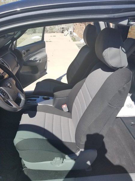

    Finally got them installed!
