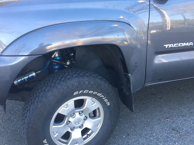

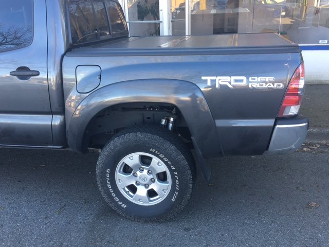

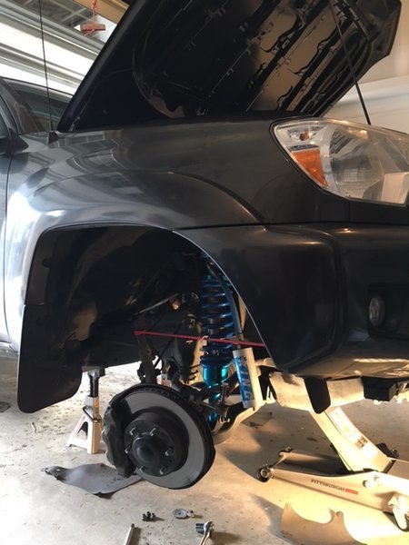

    4.15.2017 - Installed front King coilovers with reservoir, Light racing upper control arms, rear All-pro leaf springs, and rear fox shocks. Will install extended brake lines soon.IMG_3706.jpg IMG_3709.jpg IMG_3710.jpg

    Is it safe to assume that bigger tires are on order?

    Yes potentially buying bronze SCS Sr8s with duratracs on them from a local TW member. Hopefully tomorrow!

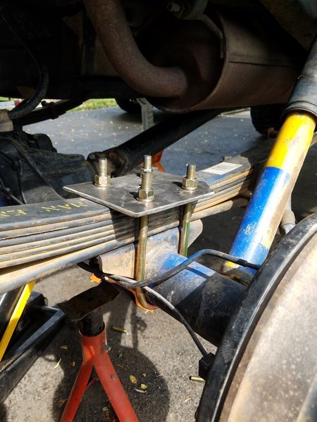

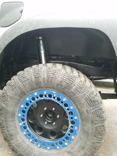

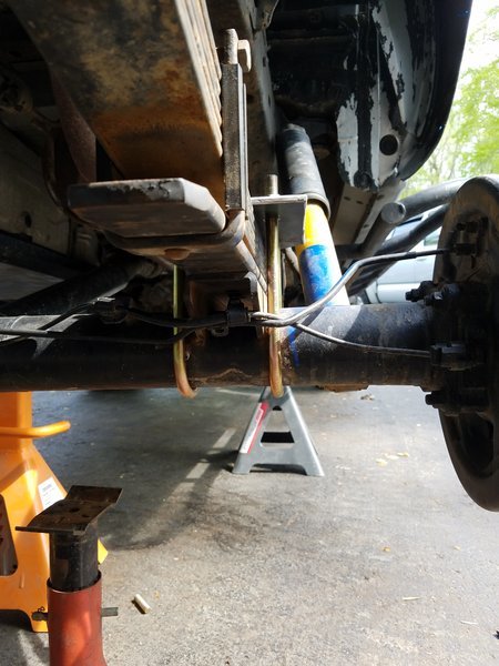

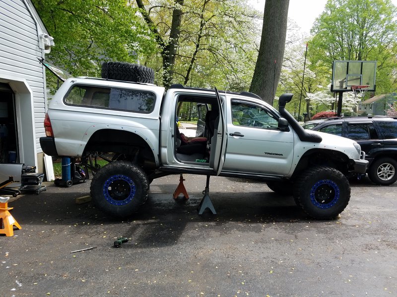

    Made a u bolt flip, added a leaf to my Dakars, and added 14" bilsteins with f250 shock towers, both shocks in front of axle and lower shock mounts in line with bottom of axle tube. The Dakars limit travel up and down now....about 12" of travel
