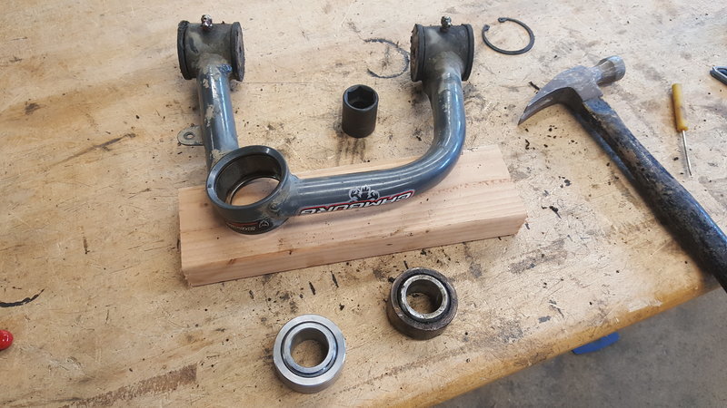

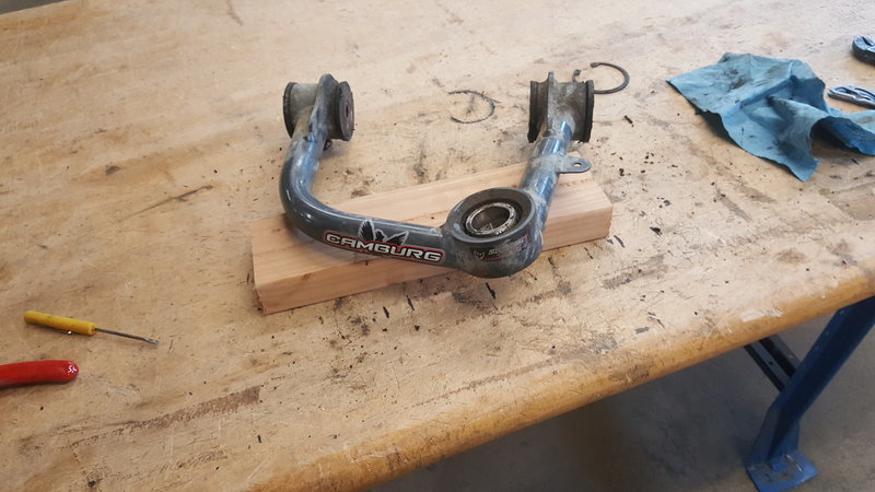

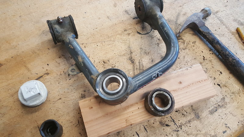

    Driverside Camburg Uniball was too noisey so I swapped it out.
    Pretty easy to do but it's only 1 year old. Totally wore out.

    That sucks, probably a 10 minute fix and 2 hours of labor to remove and reinstall the UCA.
    gabbo2112 and El Dahs[QUOTED] like this.

    Sounds about right. Pretty good at getting those UCAs in and out so it was little over an hour.

    next time just remove the uniball on the truck. will save you some time.
  16. May 16, 2017 at 2:49 PM

    Dents and scratches
    Your absolutely right. I didn't know the uniball would come out so easy.
