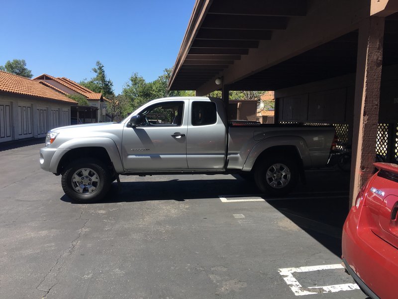

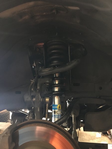

    5100's loaded with 07' TRD O/R springs. Aligned. Top setting. No spacer.

    I think I need to AAL.

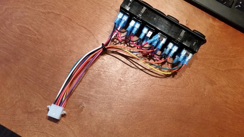

    Finished the switch end of my wiring harness for my lights and winch control. Successfully tested everything and checked what pin outs for my winch plug where which (there's zero good information on the web for the Engo 10k). I also bought the necessary bits for changing fluids in both diffs and transfer case, a power steering fluid change and spark plugs (30k). I've got a long road trip coming up late summer and the truck WILL be ready.
    Also, my rear bumper is finished. :cheers::cheers::cheers:

    How much lift?

    Honestly not as much as I thought. Nowhere near 2".

    Coming from having 2017 DCLB O/R suspension on it firstly. It came with the O/R and was soft and nice, but I wanted it higher. Thought I would get an inch from that swap, I did, but not a full inch. Plus the springs were really tight. Too stiff for my taste and use. So I swapped the 5100's in and preloaded it with the springs from the 07'... came out really nice plus durability and travel. Just need to bring the bed up a little I think. Then it's to bigger tires, possibly wheels, but probably small spidertrax..

    Or lower it s couple notches and get a better ride :p

    I want taller. But I'm on a budget. No big boy stuff...yet.

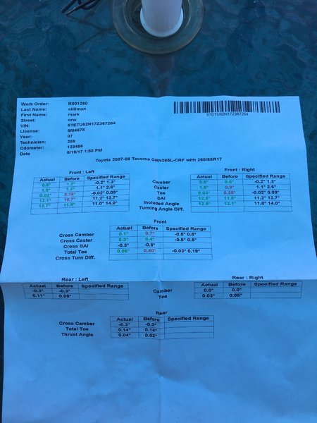

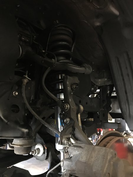

    See how bad it was before from the 17' stuff. I literally had it on there for a few days and was like, "no."

    Barely any caster before. Lolz

    I believe most of us can understand that. Apparently you know how to break down the struts and coils and sinc you have the 5100's find a good deal on a set of OME coils that'll give you the lift and allow you to drop the bilsteins to 0 or at the most .85. Better ride and handling and not that big of a Hell I think new they're 300 or less surely you could find a good used set on here for way cheaper. Then an AAl is what $80?
