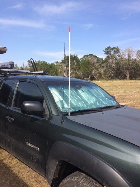

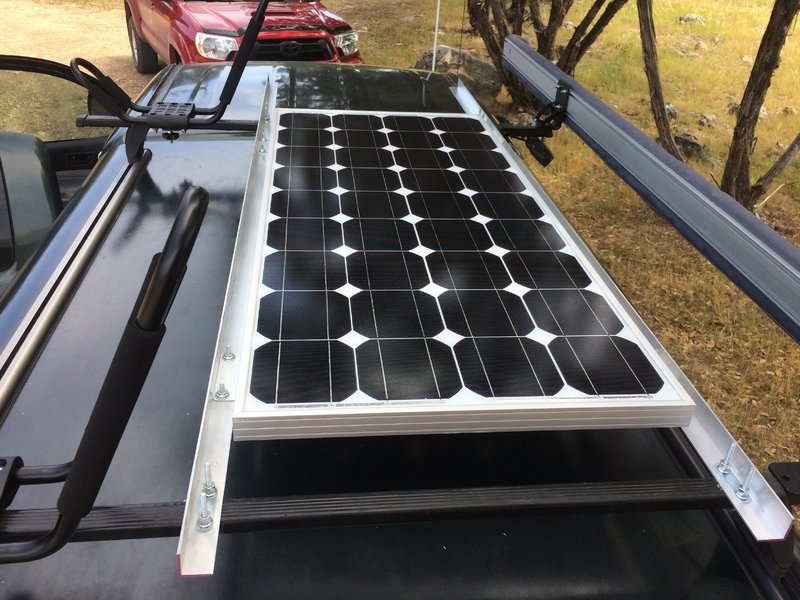

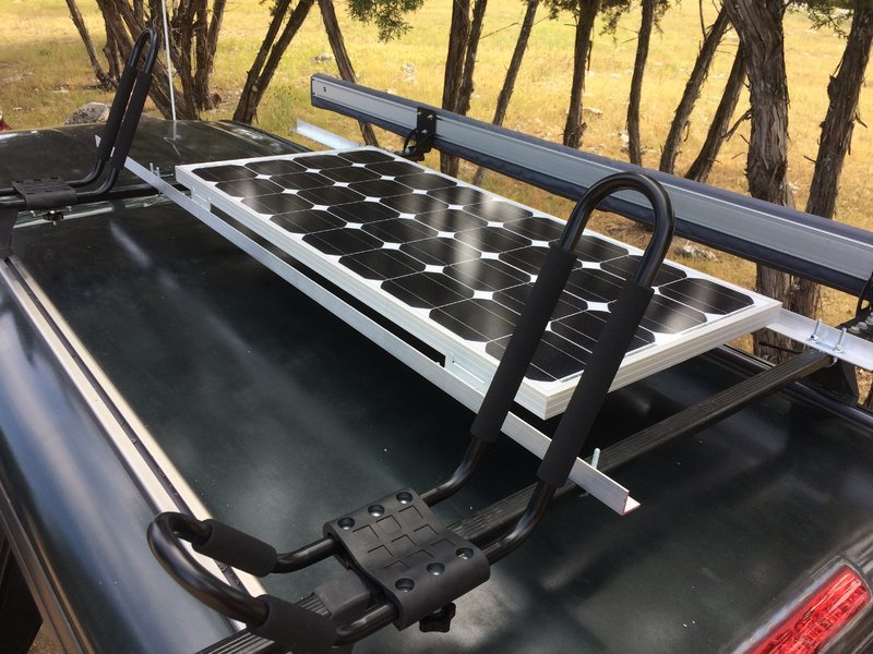

    Got my solar panel mounted to my cross bars today. added a 3ft NGP firestik as well.

    Got a write up for this? Extremely interested in doing this @ some point down the road! F-ing A!

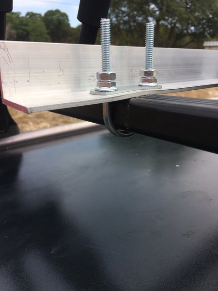

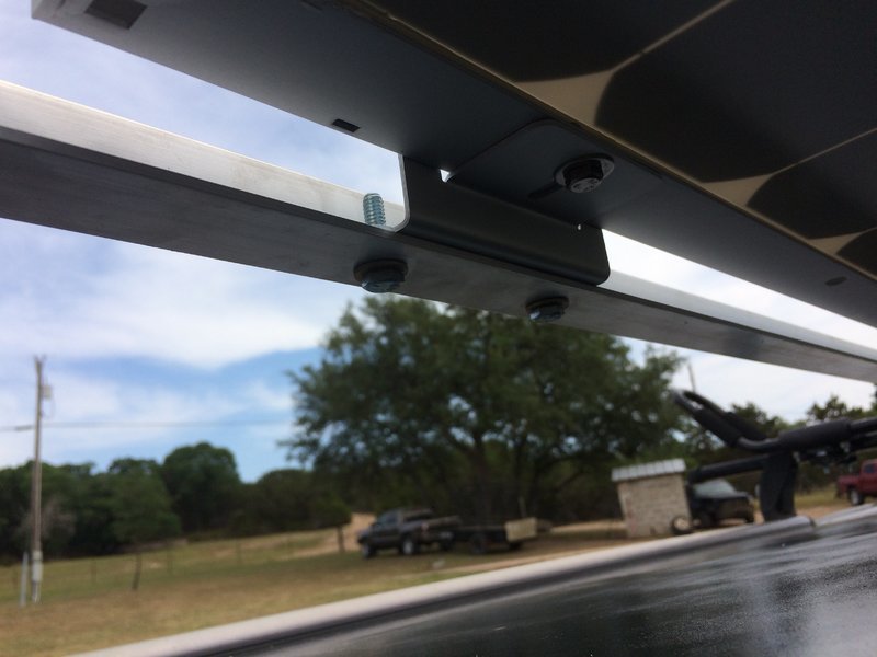

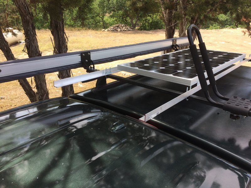

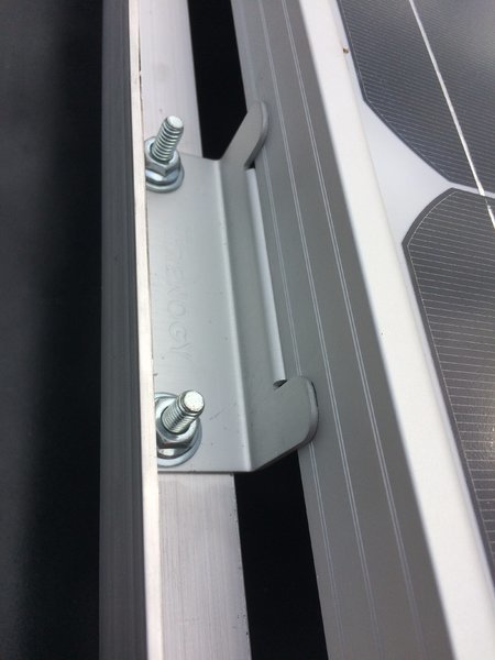

    i dont have a write up, but its really really simple. I got the brackets that go with the panel and just attached those to the panel and then set it up on the roof on the aluminum angle where i wanted it. Mark the holes, drill it out and use some bolts and nylon lock nuts to tighten them down and that secures the panel to the pieces of angle. then i just marked the angle for the u-bolts near the cross bars and drilled those out as well.
    Here are a few more pics that might help explain it better than i can through writing.
    This one shows how the brackets attach to the angle
    shot of the underside of the panel showing how the brackets attach to it
    Heres one of the angle attached to the crossbars
