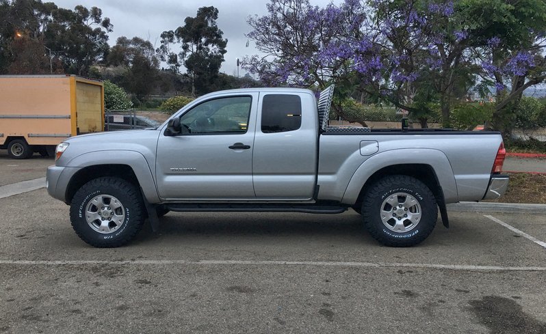

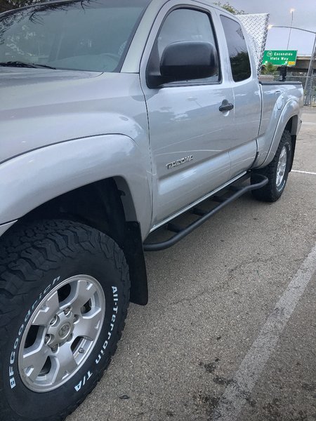

    Tire size looks alright, I guess. Which AAL would you all go with? I've been thinking the icon three leaf progressive (remove the overload spring), or the headstrong one. I've heard good and bad about both.

    White letters FTW!

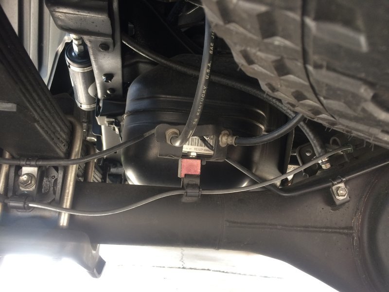

    Tires look good! I've had good luck with the Icon Three Leaf from @HeadStrong Off-Road with the overload removed. I gained 1-3/4" of lift on my Access Cab. I added the 1" Brake line Spacer block also.

    Brake line spacer... I need this.

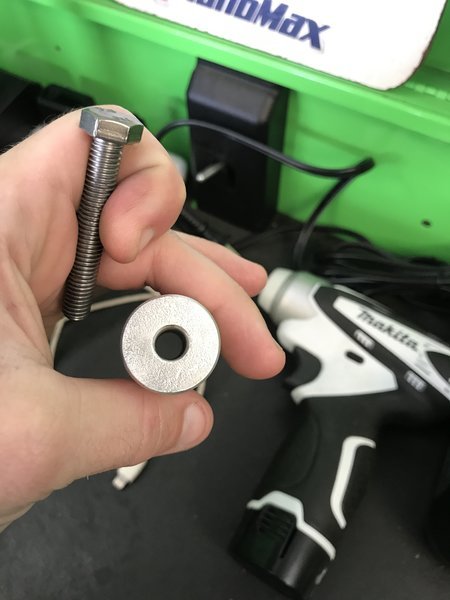

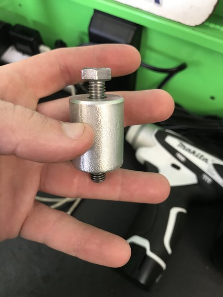

    This is what I used as a spacer until I did extended rear brake lines. It's 1 1/4" tall
