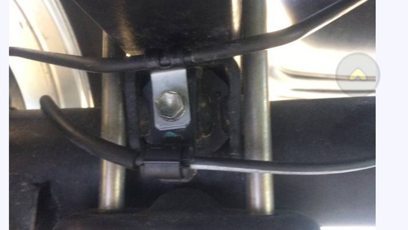

    It's recommended when adding the AAL. These Parts came stock on the Tacoma's with the Baja package. I also added the replacement clamp under the drivers side Leaf pack. This lowers the Brake line a Tad. Also was stock on Baja's.
    The OEM Toyota TRD part #'s are-
    TRD Suspension Hardware Kit-PTR13-35120-AD. I paid $17.47 from Toyota. This kit comes with the washers for the TRD front bump stops, but has the Spacer and its mounting Hardware for the rear brake line mount.
    The small OEM Toyota clamp is part.# is 90461-10616. $4.64 from Toyota.
    This is good thread to read about adding a Factory lift to your Truck. Hope this Helps.

    I'm removing the overload spring so that if/when I hit hard, my rear end wont buck. I want a soft impact and am willing to sacrifice the spare lift and weight hauling for said reasons.

    I thought it was extended brake lines you needed... Do you need both?

    Your don't need to do anything to your brake lines for an AAL.

    This set up is working for my mild lift. Anything higher I would recommend the longer Brake Lines.

    Thanks guys... I'm only going up like 1.5" though without the overload spring. Some say I need it, others don't. If it's a $20 expense and I'm already down there... why not? Is there a downside? Seems straight forward.

    If you want to add it, add it. I'm just saying it's not necessary because it isn't and others may read it and think they need it.
    I'm all about modding to mod but also want the right info to be out there for users.

    I'm going to be w/ 2-3" lift all the way around so would that be considered mild or do I need either of those to things?

    I would go with the Extended lines.
