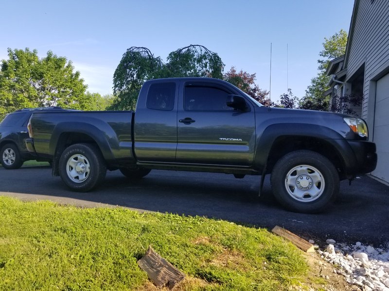

    Finally had a free day to put my lift in. Bilstein 5100 at 0.85 with a 1/2 spacer drivers side and 3/8 passenger. Netted about 1.5" lift.
    Tires go on Tuesday and I have an AAL waiting to go on when I get another day off!
    Edit: No vibes :)

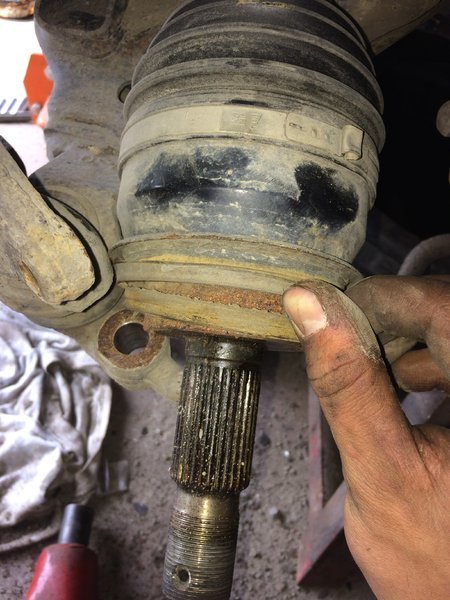

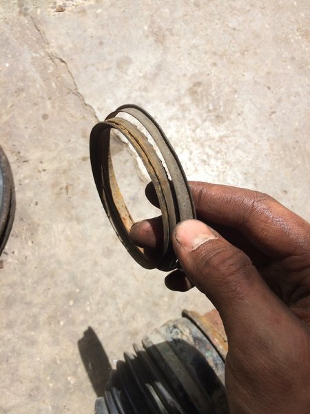

    Lucky tho, the axles I
    Got had no seals, been able to save 2, had to buy one on the spot last saturday and order the 2nd one. Rolled the truck a few days without it. I was lucky all roads were dry and no dust. Seals were in bad conditions on one side, both the axle one and the hub one. The one on the diff was looking good and no leaks so it stayed there lol
    Edit: i think the one I have in my hand wasn't the right one my local autoparts sold me 2 years ago when I replaced my bearing. But it fitted there and when you don't know... and the old one was really destroyed so I couldn't compare... now everything is fine!

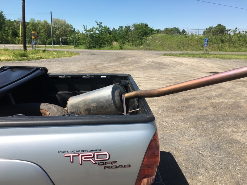

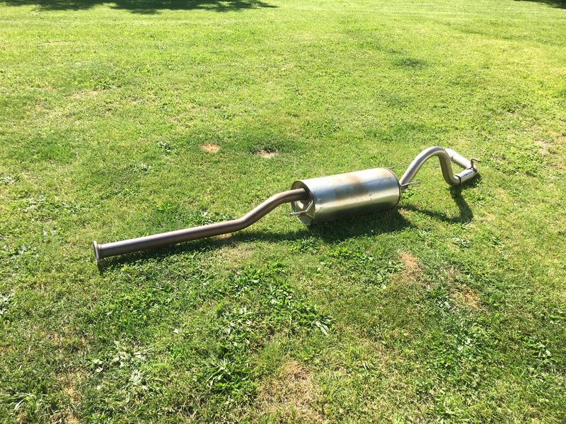

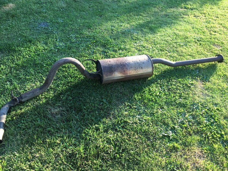

    First found a takeoff muffler on CL for $80. Found a wonderful hole in mine and it's been getting louder by the day.

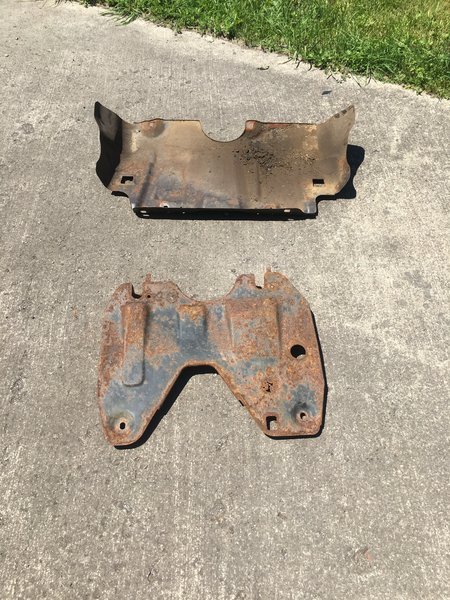

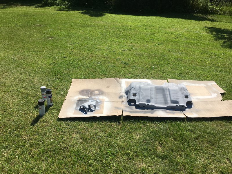

    Grinder, then runs Encapsulator then prime then paint all the skid plates and spare wheel!
    Hole in muffler:
    Picked up the new exhaust (brand spanking new!)
    Out with the old and in with the new:
    Rust bucket:
    Forgot to take a picture of it all ground down.

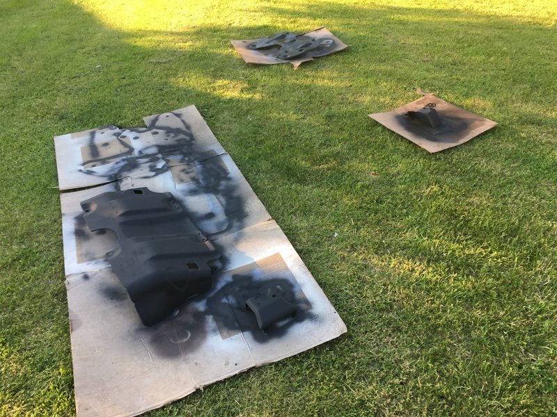

    Prime and paint (went with flat black, not sure if I should have done satin or gloss)

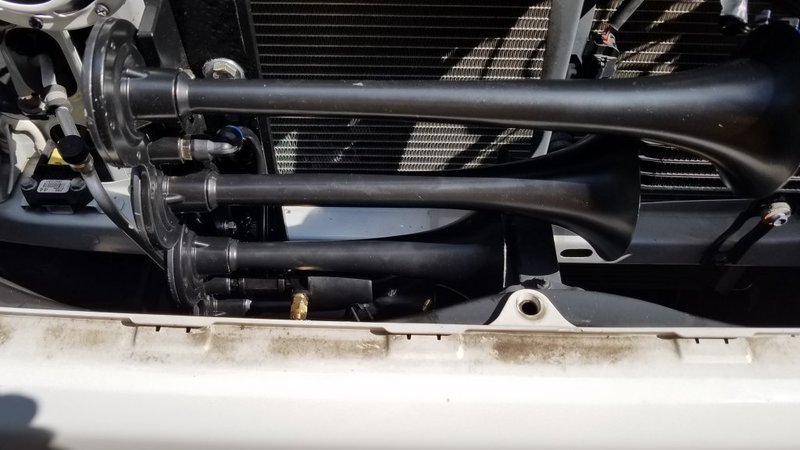

    Those are really nice! How do they sound?

    Don't really know yet. All I've heard was a recording of the sound on their web site. I still need to install the air tank, the hoses, the remaining wiring for the ARB compressor, and a few other things.
    It's hard to find time to work on it. I get home too late at night to get much done and weekend are usually tied up doing shit for the wife.
