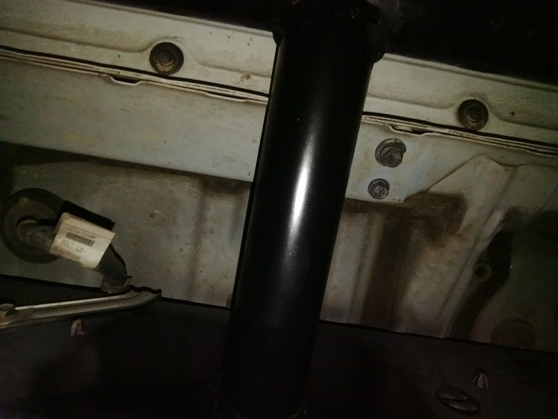

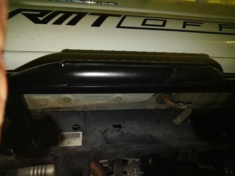

    Welded.

    So you have it welded to the frame AND the cab?

    I believe the 2 bolts showing is one of the original mounting spots
    To the frame or to the frame and the body.

    Sorry, no. they ran them through the body and then welded to the frame. I'll try to get better photos after work.

    That would be hard to do.
    This would be much stronger than the normal way of installing the steps. The problem will be that the tubing in the N-Fab step is thin wall and will bend pretty easily. I would like to see the attachment to the frame have some gussets to help strengthen the connection. Also the "new" tubing that connects the step to the frame could also be thin wall and not as strong as you would like.
    That being said if you like them than there is nothing wrong with them at all. Just know that you couldn't beat on these like you could a true slider.

    Yes, true. I am not a frequent off roader, and need the steps more than a real slider. So the local four wheel shop suggested this as a compromise.

    I think I understand. What I was getting at is the cab and the frame are two separate entities attached with rubber bushings (cab mounts). If you have it welded to the frame AND bolted to the cab in the stock mounting position, bad things may happen with the cab not being able to flex.
