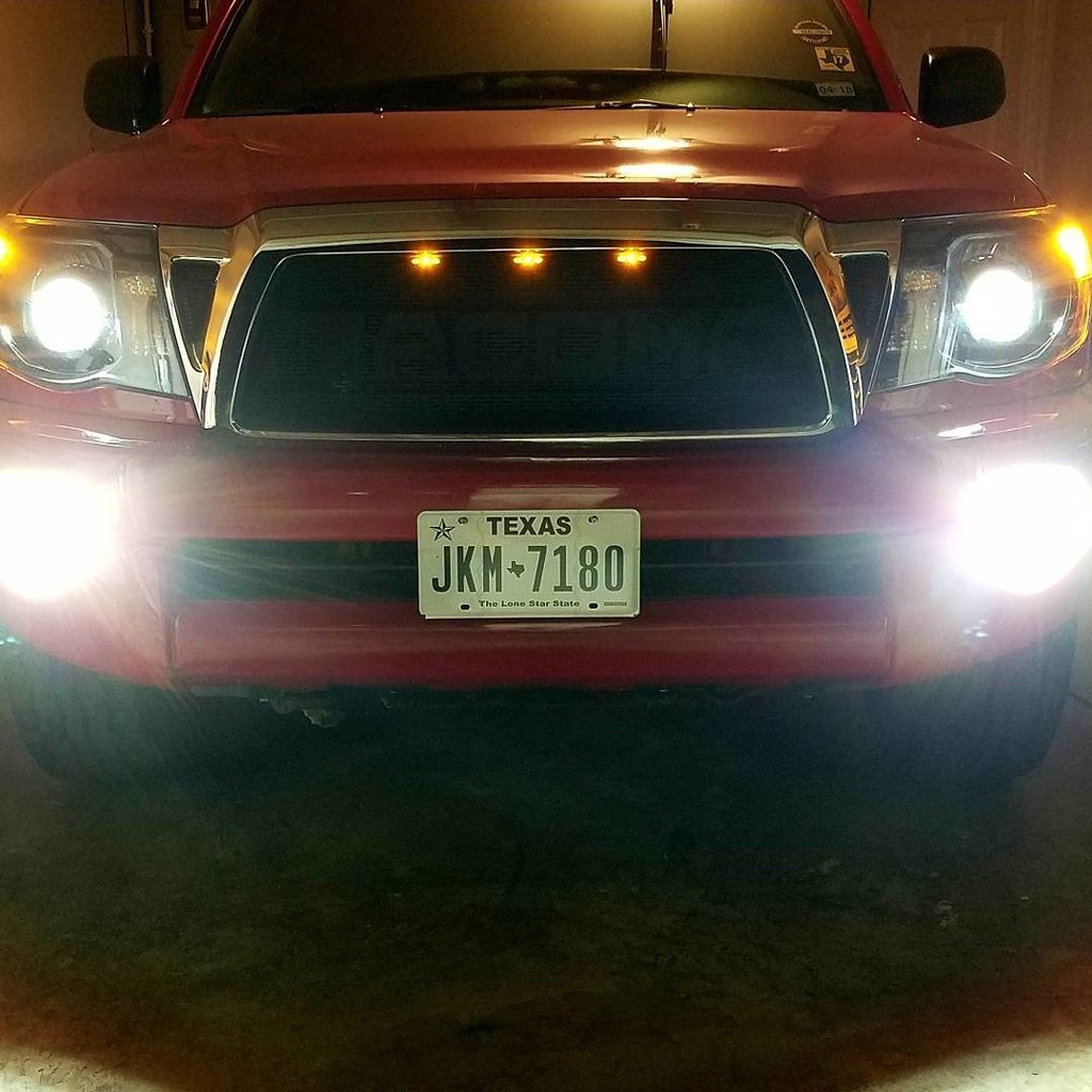

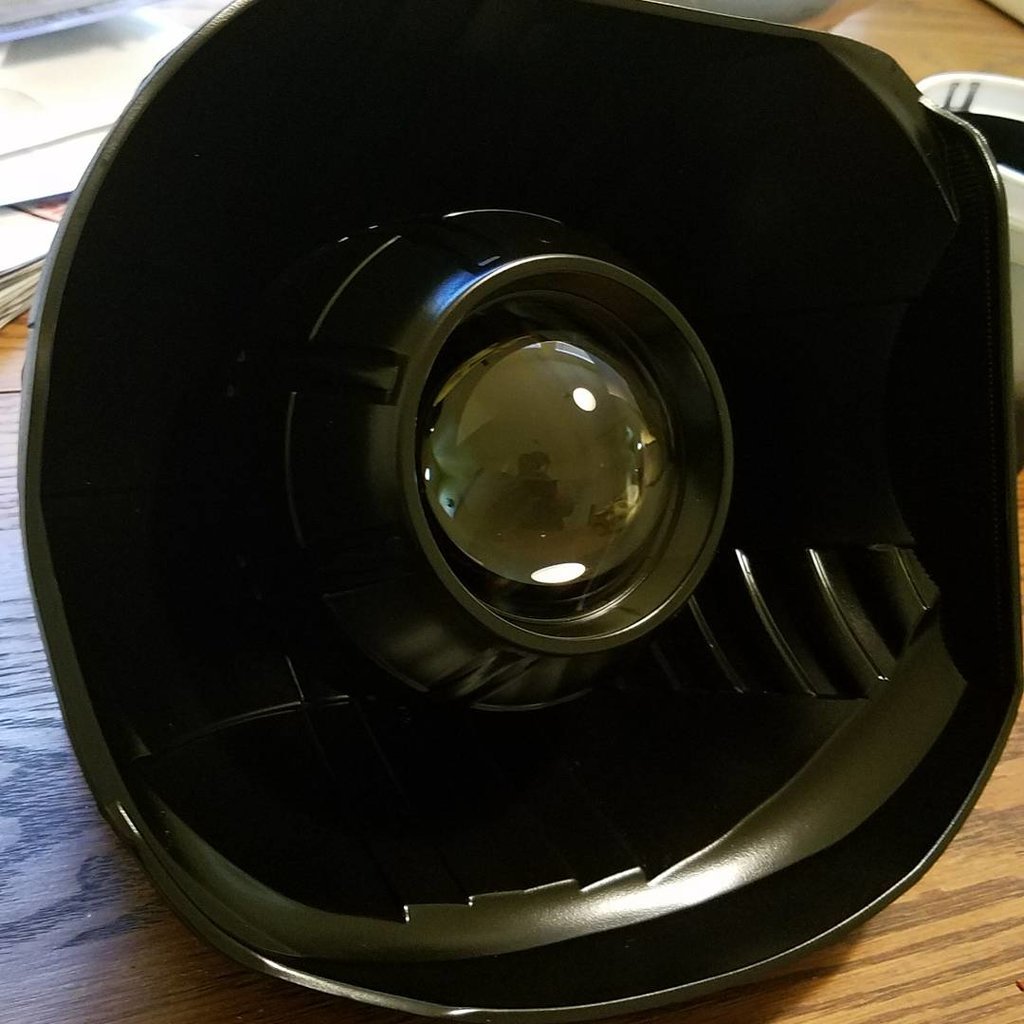

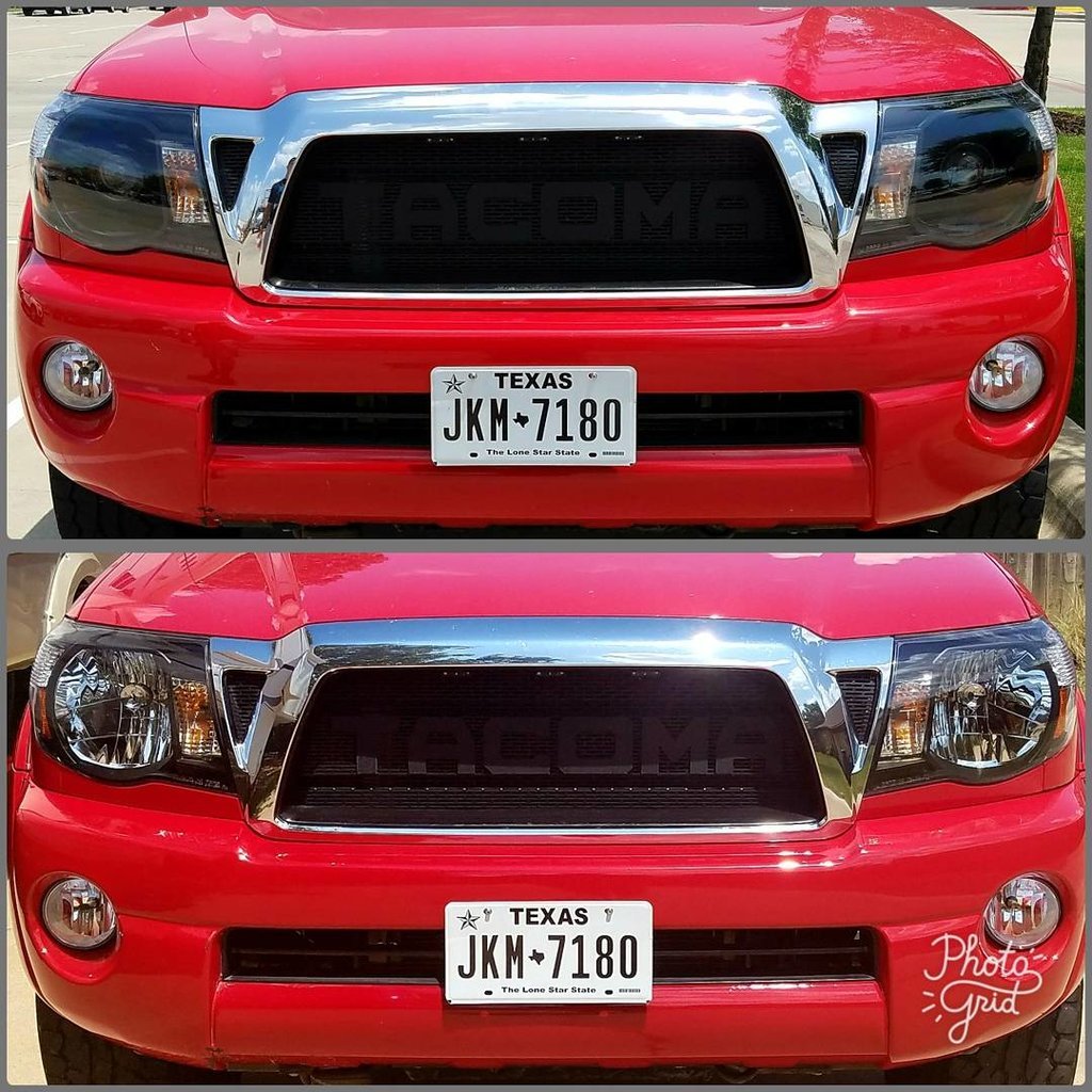

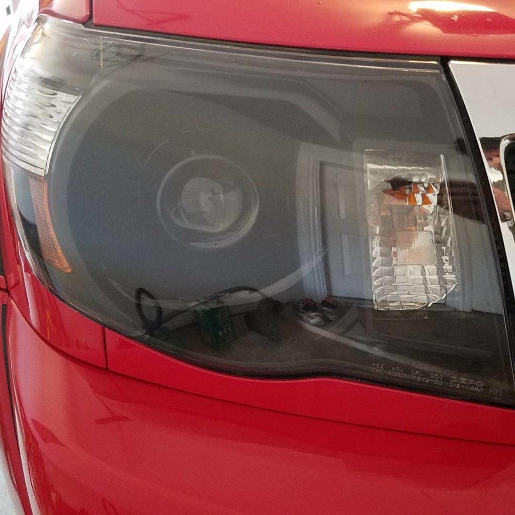

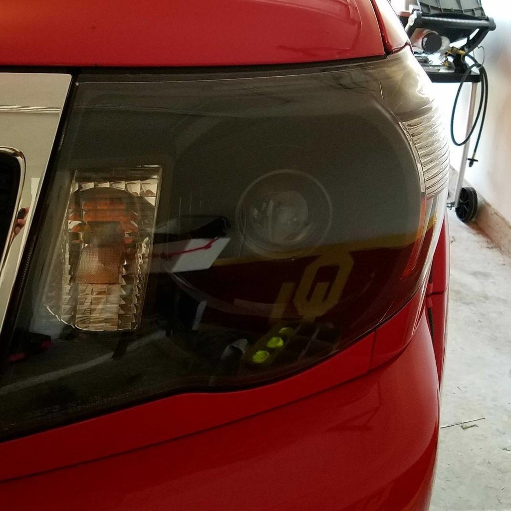

    Completed my morimoto projector mod last week. Turned out pretty gnarly! Was even able to modify my kensun bulbs to work with the morimotos. I was not aware you had yo use their bulbs until I already got the kick. Figured I'd trim the kensun bulb and it worked! Anyone looking to tackle this I highly recommend making sure you let your JB weld set that holds the morimoto adapter and nut in place on the reflector bowl. Mine was not fully set and when I installed the bulb it twisted slightly and has a small angle to it. Nothing major but something I notice that bugs me. Also I used depo headlights that were blacked out and proceeded to black out the reflector bowl and the shrouds for the projector. As time goes on I will be removing all chrome from my truck (with the exception of the front turn signal and side markers) so I figured I'd start with the headlights. If anyone has questions or small tricks or tips while performing this feel free to reach out. With stripping off the chrome and painting the components this took me 8 hours total (chrome stripping and painting added up to about 3.5 hours). Also I did use the rubber gasket that goes between the projector and the reflector bowl and I noticed that the projector picks up a good but of vibrations so you see it in the light. Not sure if I didn't tighten the nut enough ( got them as hand tight as possible then put some JB weld to lock in place). Then one more thing is after baking them back together I have a slight film on the inside of the lenses. This may have come from the freshly applied paint on the reflector bowls and shrouds but I did tape off the headlights like others have suggested. It's not horrible but again it's something I notice. If I ever find a reason to crack the headlights open again I'll definitely be addressing the slight film and the left projector having a small angle.
