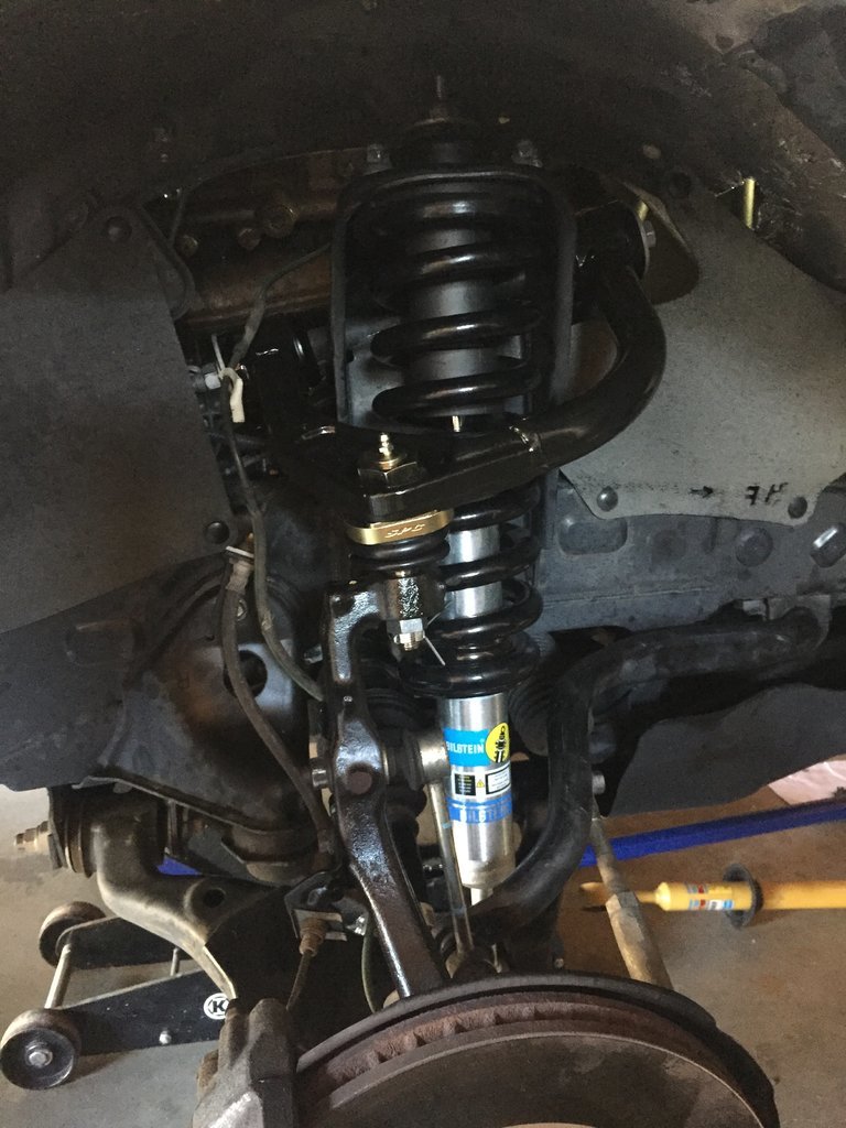

    Got the front suspension all buttoned up today. Bilstein 5100 @ 2.5" clip with stock coils and SPC UCA. Took hub to fender measurments. Before 20.5" after 24". 3.5" inch lifted?? Im hoping this settles some also have a pop sound coming from front over bumps and stuff which im assuming is the sway bar or maybe tie rod ends. Will take the sway bar out and see if that fixes it whenever I get home from vacation. Feel free to chime in with comments or help :rofl:

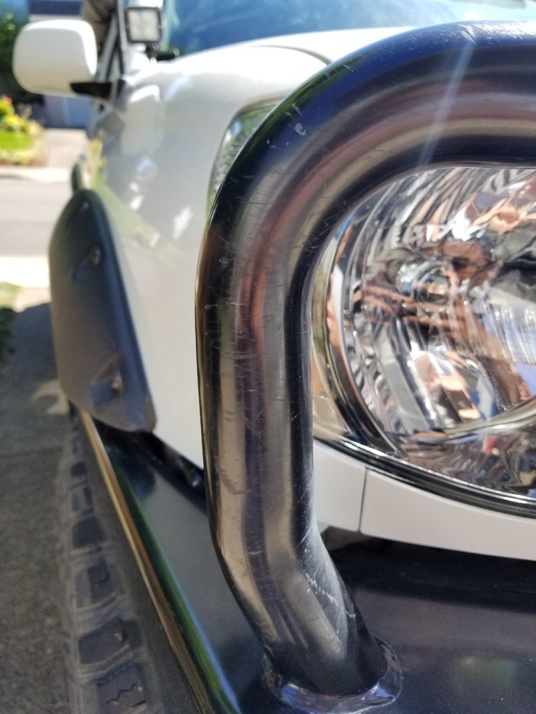

    Headlight hoops ftw

    I'm trying to figure out how to run fender bars from an aluminum bumper to steel skids

    I was looking into those....like the ones they have for arb

    Are the ARB ones pre bent and you just cut to length? That would be handy. My thoughts so far were to weld a section of pipe to each thing the sliders with steel and the bumper with aluminum that will slip inside the fender tube then you could drill holes and bolt in place so they could be removed

    No they only work with their slides....which Imo aren't real sliders

    Well then custom bent I guess. I'll have to see what my buddies tubing bender will bend

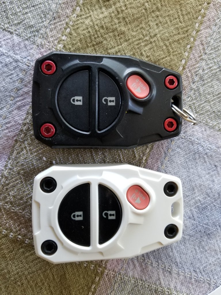

    The white is a nice addition. I went with all black.
