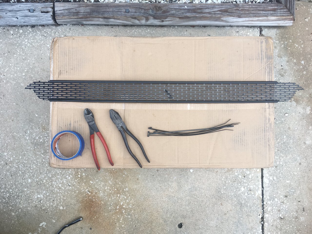

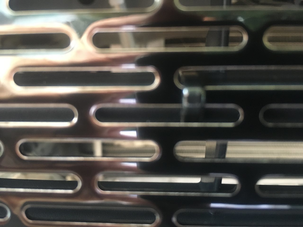

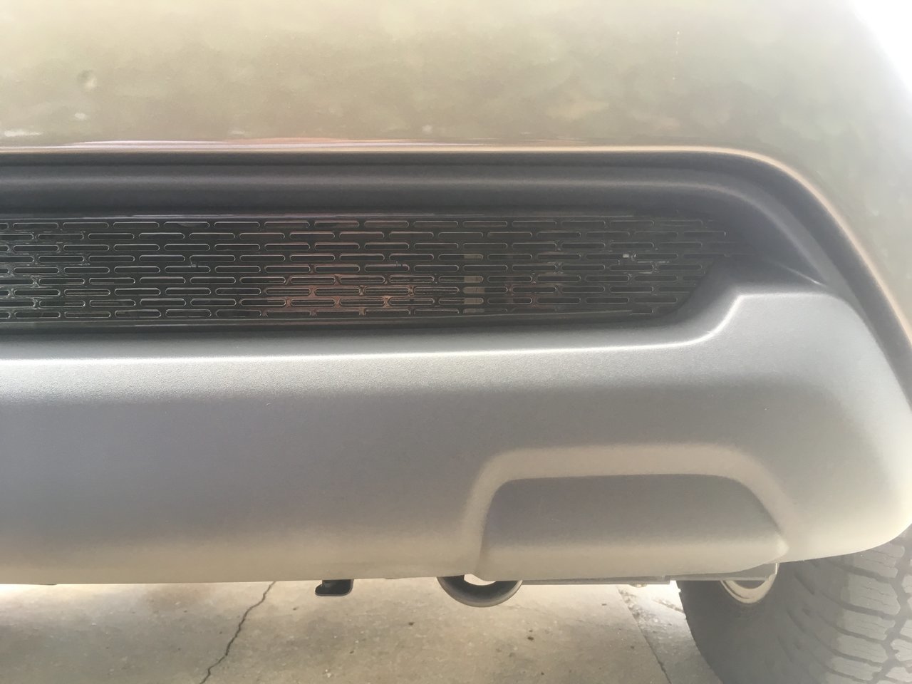

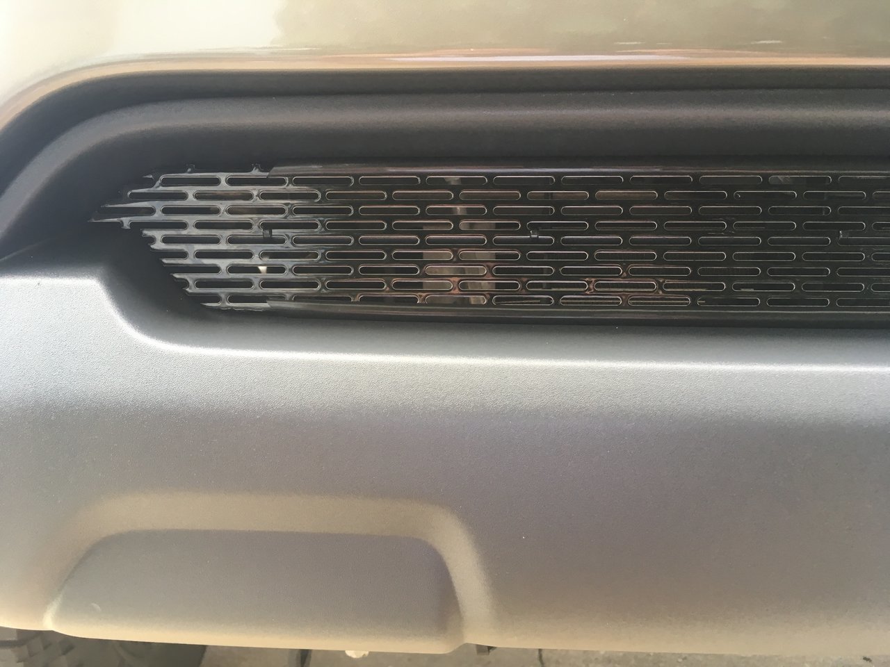

    Installed the BPF lower Bumper Mesh. This covered the exposure of the horns that were relocated after the Black out behind the grill and horn relocate Mod.
    It's attached with 7 unique zip-ties that have a stainless retaining clip, and have UV protection. I like these so much I ordered a bag with 100 count.
    I dropped the front skid and stitched the ties through the back of the plastic lower bumber insert. Looks awesome in person. Very happy with the outcome. Also treated everything that the skid plate blocks with fluid film.

    Such a clean installation on a cclassy looking truck.

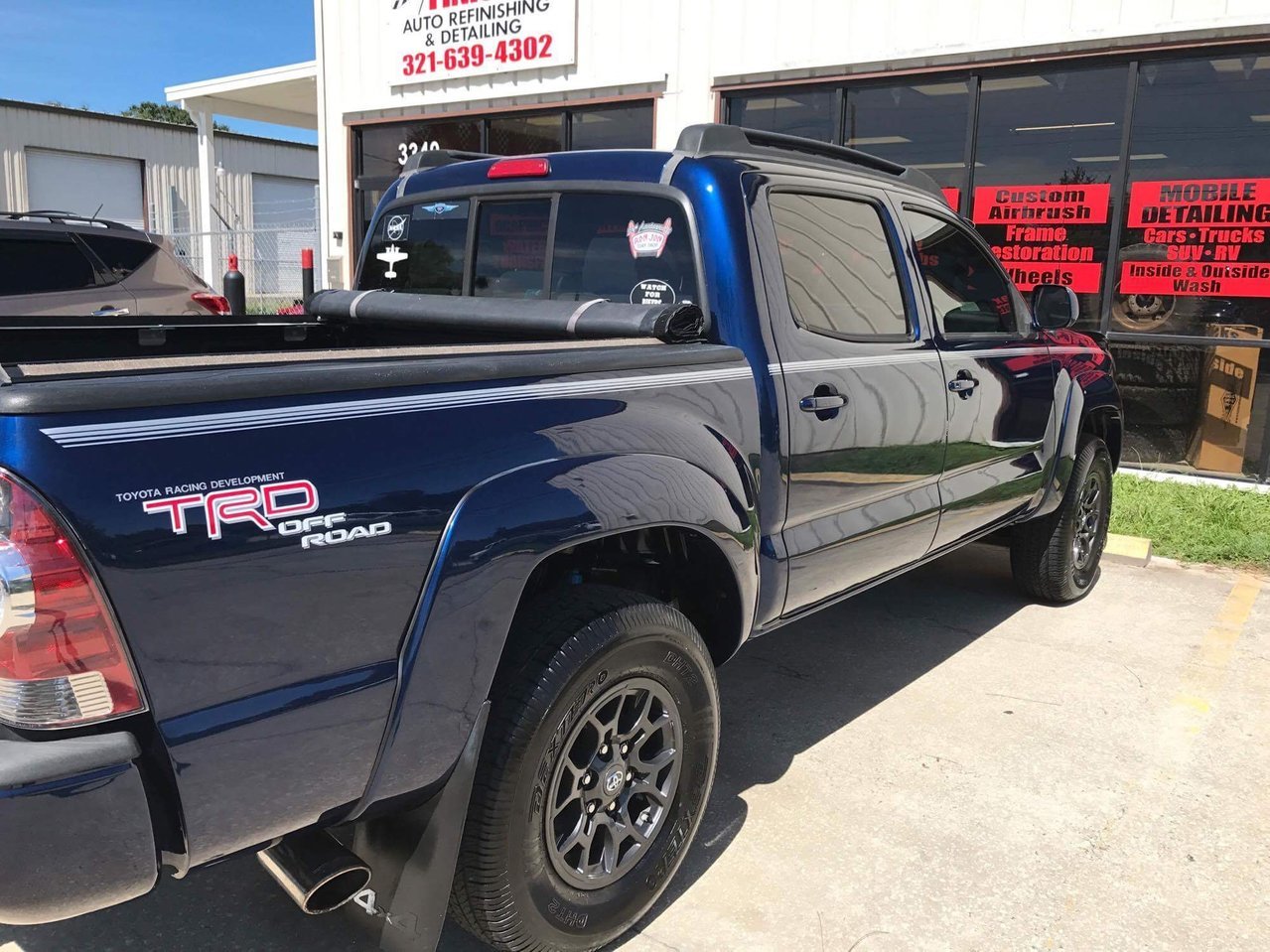

    @CBoy808 can you do a tailgate stripe like this in silver?

    Another great install! Keep an eye on those zip-ties; I've known that design to rust. They plastic keeps moisture in the locking mechanism and eventually the steel tab starts rusting. Mostly an issue outside in salty conditions (snow and sea areas), so you may not have a problem. Just keep an eye on them since the tab will let go if it rusts.

    Thanks, sure will. I just zipped one on the frame as a experiment and for easy visual periodic inspections. They claim to be stainless so we'll see.

    Stainless just means it will take longer to rust ;)
    You can always put a dab of petroleum jelly in the locking hole just in case. It will keep out water. I don't think it would harm the plastic.
