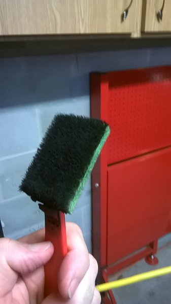

    I used black BBQ paint on mine. Removed the grill and taped off the parts I didn't want to paint. For the lower part of the supports I used a cheap felt trim pad. Sprayed the pad then used it like a big marker to paint behind the lower bumper.
    No issues with cooling, but since I only painted the supports I didn't expect any. Might be different if you paint the fins, but I wouldn't do that.

    I've been thinking about doing this as well. Good idea about using the trim pad since rattle-canning would be a hassle with the overspray.

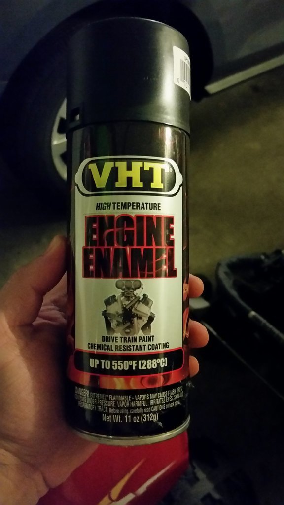

    Yep, the whole thing!
    Get something that says it's for high temps. Spray it with a coat or two, and you're good to go.

  17. Aug 17, 2017 at 6:38 AM

    Yep that's the same stuff I have.
