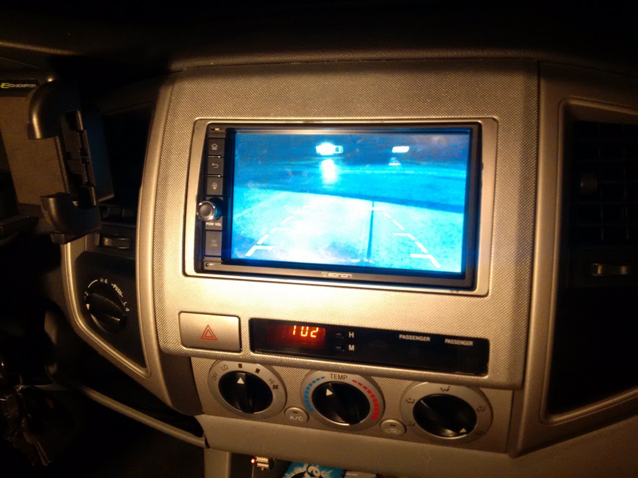

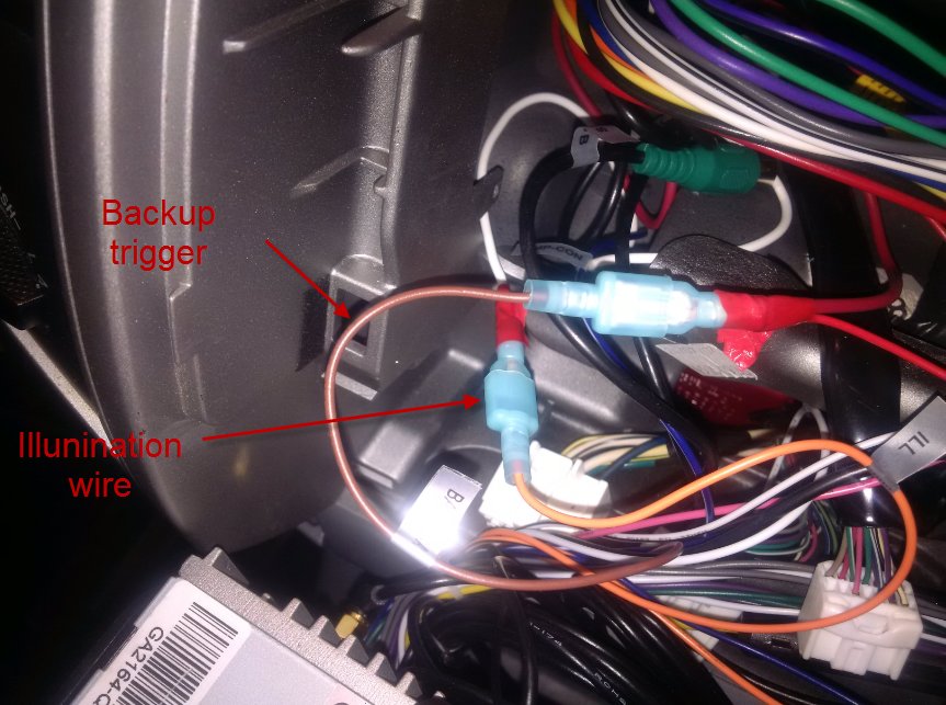

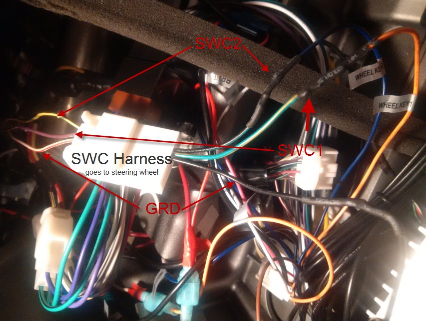

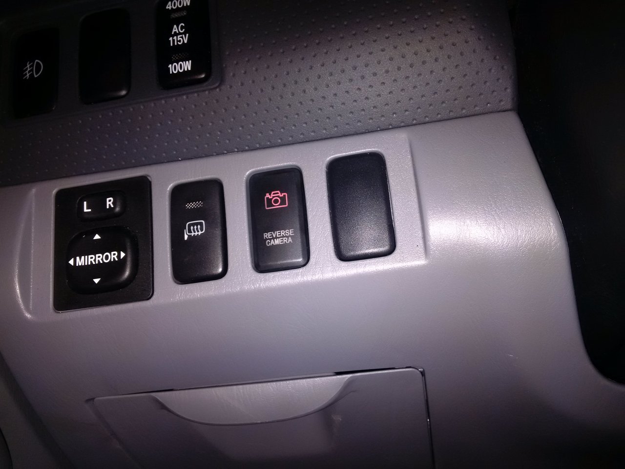

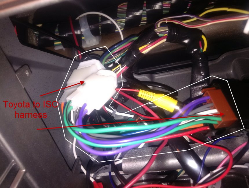

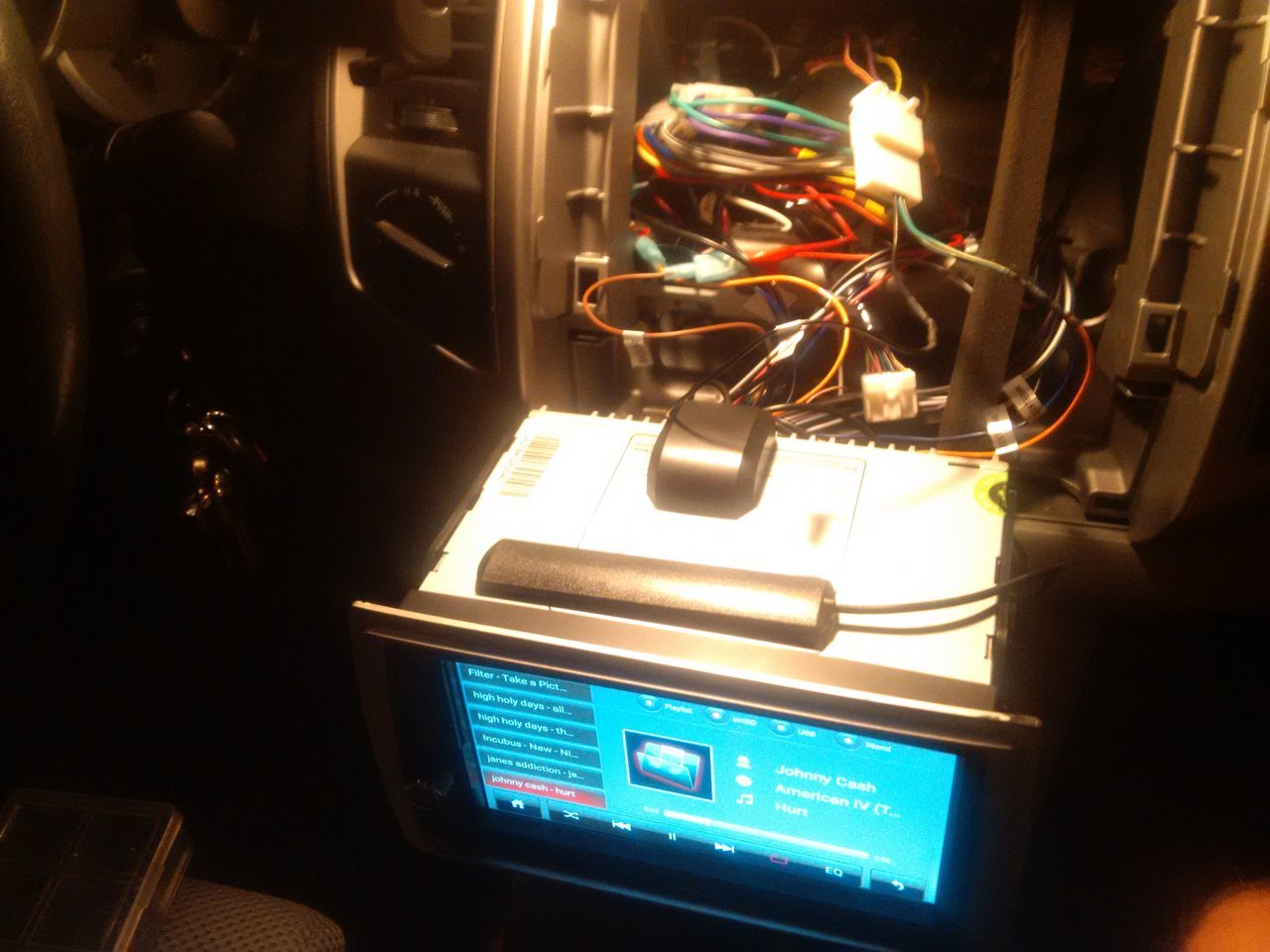

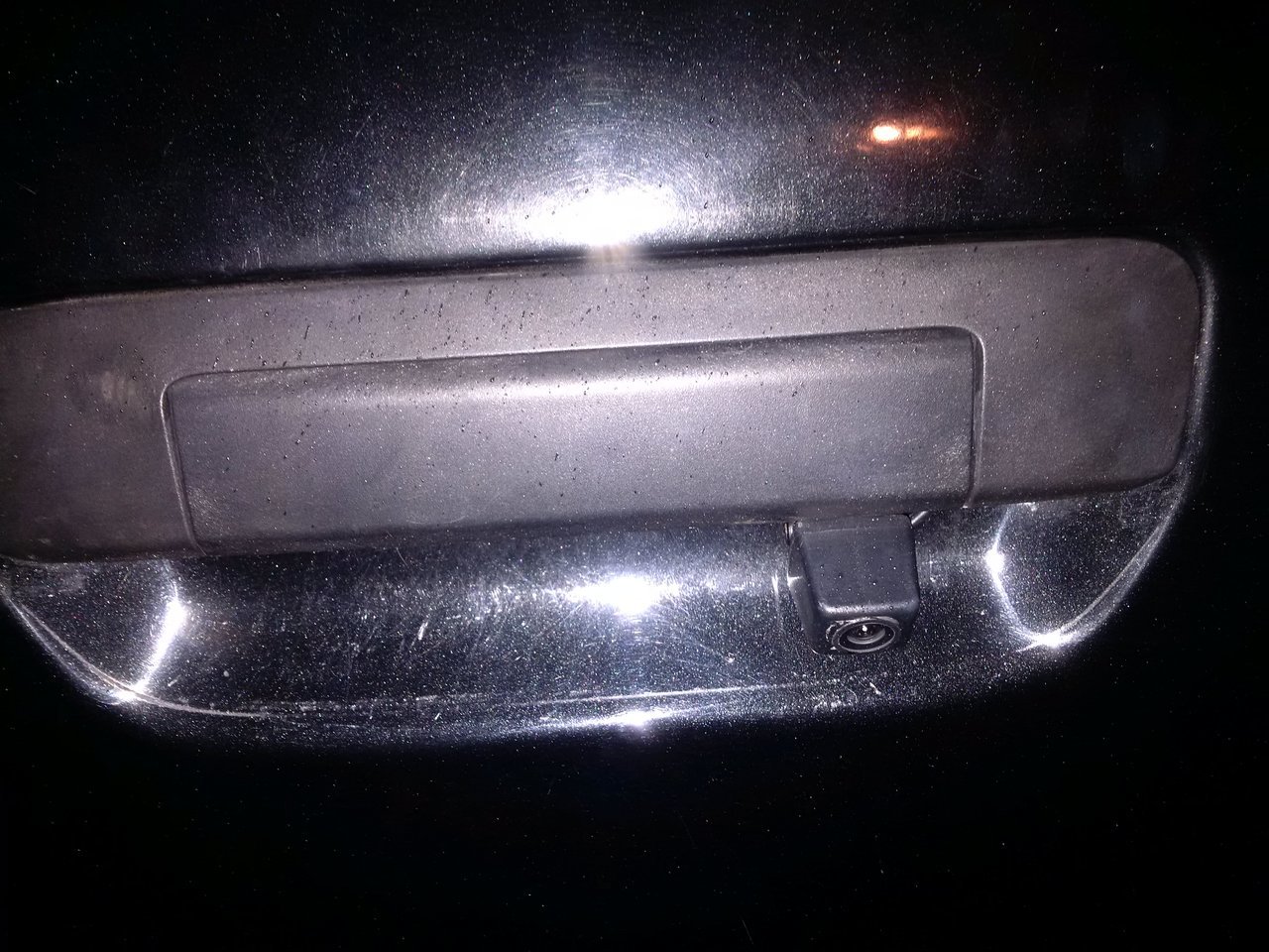

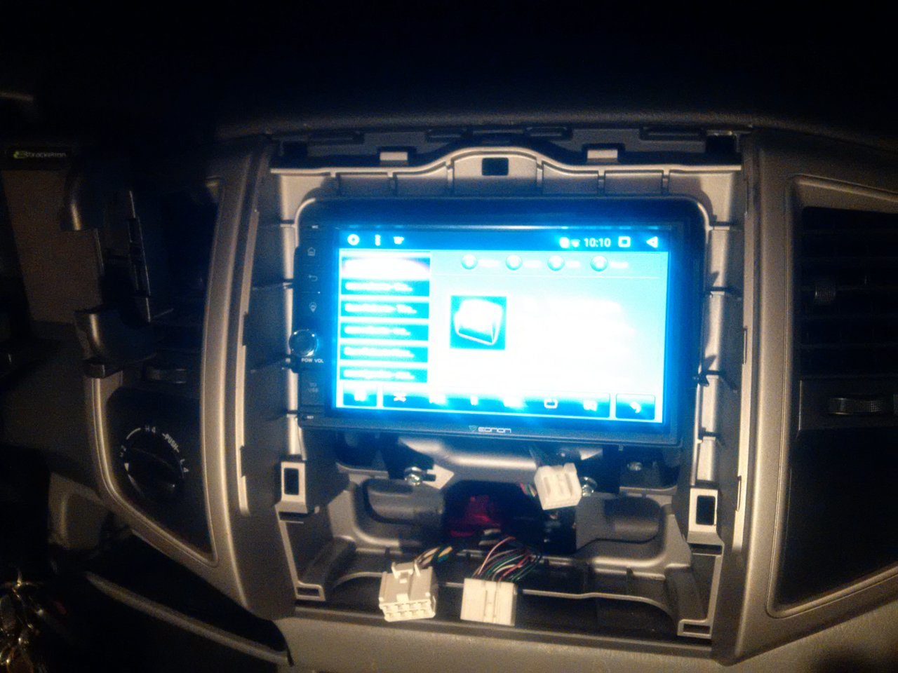

    New to the forum. In fact I don't ever join these until today because I felt an overwhelming need to share these picks and maybe inspire or help someone else as all the folks on this forum have helped me grow the stones needed to tackle great taco mods.
    Today I finished the install of 7" double din android deck. The exact link model below.
    Here is what I Installed
    - Eonon GA2164 7" double din
    - Metra dash kit
    - Toyota to ISO wire harness
    - Backup camera mounted to tail gate handle wired all wired to reverse trigger and backup light circuit from the left kick panel
    - Backup camera manual switch
    - Deck wired to illumination circuit, reverse circuit and the 3 wires that control the steering wheel controls
    - ODB2 ELM dongle
    The new setup gives me bluetooth phone, music, steering wheel controls for radio and music, offline navigation through "Here" App, GPS, WiFi and WiFi data tethering through phone, ODB2 diagnostics and also information dashboards even at the same time as phone connectivity and of course the ability to play online music, or stored music on either SD or USB.
    I bought a steering wheel decoder harness and was about to get the decoder but research said I didn't need it because the deck could handle SWC so I used the harness to connect the factory one and therefore no splicing of any kind needed for the whole install.
    Next I am going to add a front camera and RH steering wheel controls to answer drop calls from the steering wheel.
    Here are the links to what I bought for the project.
    https://www.eonon.com/Android-Car-GPS/2-Din-GPS-Navigation/GA2164.html
    https://www.eonon.com/Car-Video/Cameras/A0119.html
    https://www.crutchfield.ca/p_120958214G/Metra-95-8214T-Dash-Kit-Gray.html
    http://www.ebay.com/itm/NEW-Toyota-...299818?hash=item1a1c70bbaa:g:ik8AAOSwt0FZA2MJ
    Sorry for the night shots as I finished the install late.

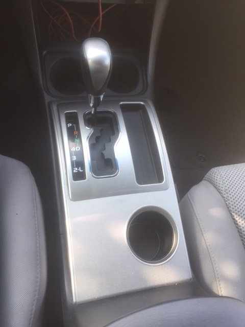

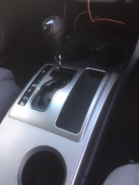

    Was working on a automatic shift boot but screwed up the boot and have to order another! For now just the shifter change of an rx350. Feels nice and starting to remove the chrome ;-) Any one want the stock one or the stock trd center? Taking offers

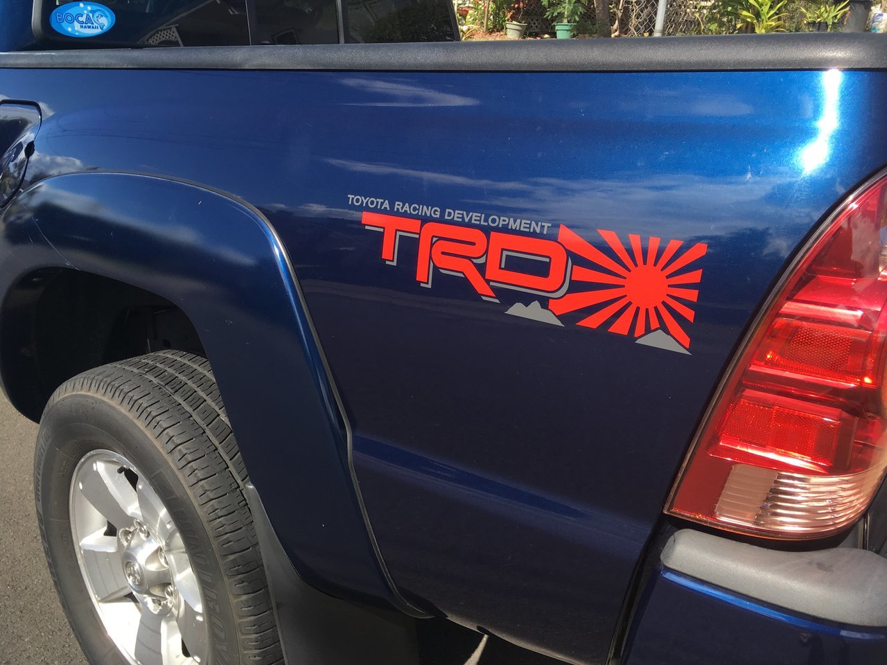

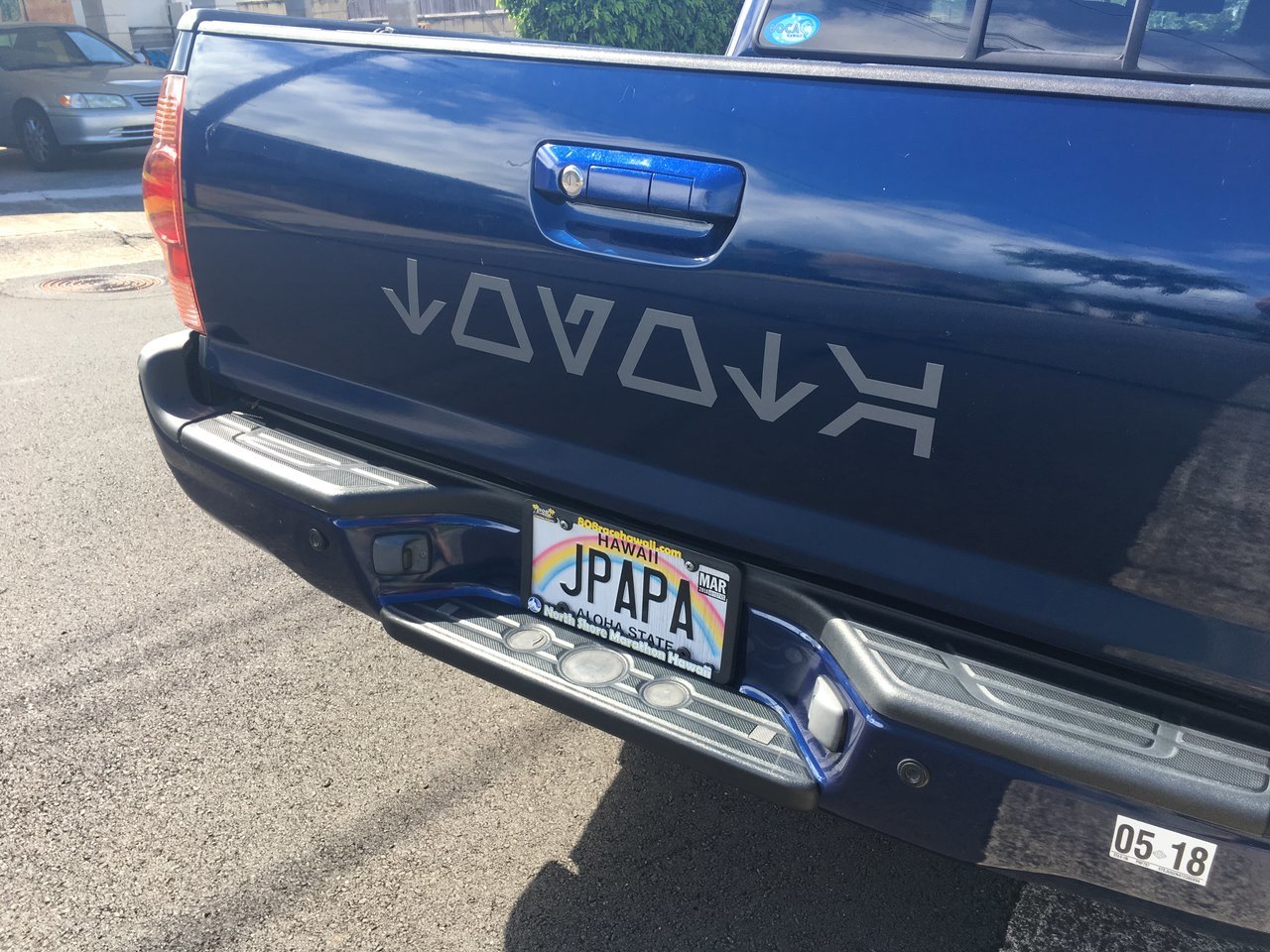

    Thanks again @CBoy808. Great work and very fast.
    A new tailgate badge
    And I updated the bedsides changing the TRD to red and the black areas to dark grey. It was too subtle all in black before.

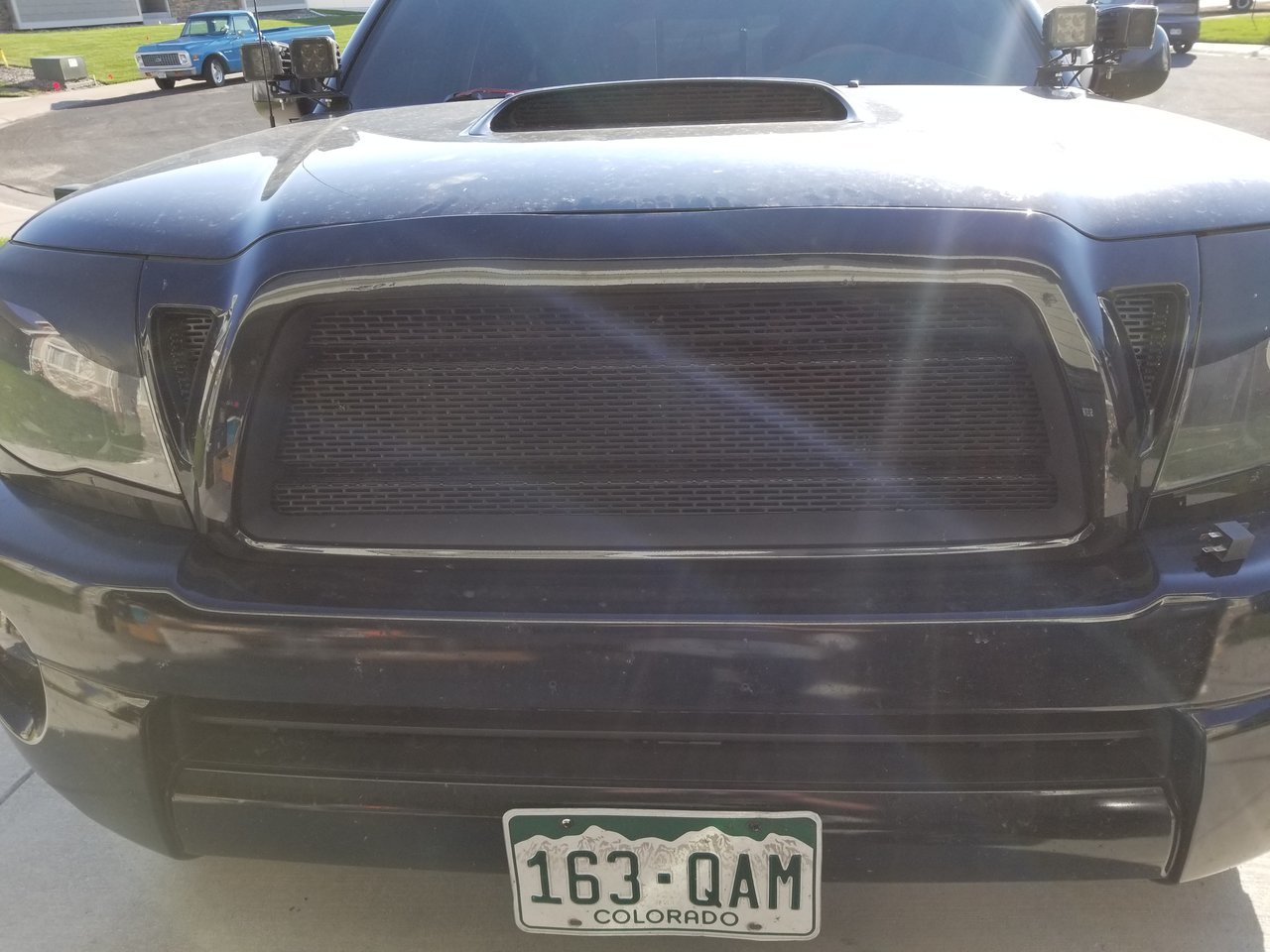

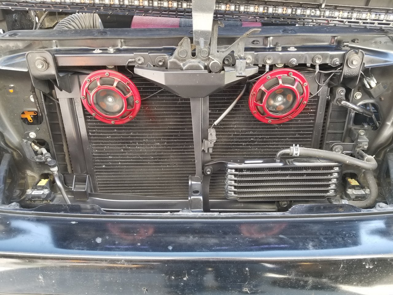

    With my @HomerTaco grille in the a.c. condenser stuck out like a sore thumb... so a little high temp black paint and it's invisible 20170818_171330.jpg 20170818_180240.jpg
